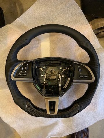

This past year I had a steering wheel modified for my XK. I went to the dealership to have the new one put on, but they said that the mount on the new one was different than the original wheel.
The top pic is the original wheel and you can see that it has a larger "gold" looking mount, where as the bottom wheel has a smaller mount. The mount does not look that much different, but the dealer said it was different and they could not put it on. Now I am left with trying to get my money back from the place that modified the other wheel. I like the modified wheel a lot but cant figure out what to do? Any thoughts out there???
Your original wheel looks to be a heated one. The greasy "gold rings" form an electrical slip-ring, to transfer current to the heater elements in the wheel. In the column, there are matching"brushes" (called by Jag a "module" - item 5 below C2C7505) that push against those rings, completing the circuit into the loom. Your dealer is reluctant because the spring loaded brushes will rub against the plastic shroud on the back of the wheel. Best case scratching the thing and making an awful scraping sound, worse case perhaps catching and breaking the brushes/shroud. If your are OK living without the heated wheel, it is possible to extract the module from its socket in the column and unplug it from the loom. Not sure if this would throw an error, however.

Thanks for the info. You are correct, mine is heated and the modified one is not. I'll have to look into this a bit more or find someone who would want to play around with this and help me out. Thanks again!

Stuart, Thanks for the info. The modifier Vivid Racing provided the wheel. I'm working with them now. I should have posted this earlier. I think we figured out that it is because of the heated wheel and the modified one is not. Thanks ABZXKR! Pics of the wheel coming soon....

Pics of the front of the wheel:
New:
Old:
Thanks again for the help!

No Adaptive Cruise on both. This wheel has ACC - 2 controls on right side.

Yes, custom fabrication. I ordered it in April, but due to covid and a screw-up on their part I didnt get it for about 4 months. No big deal, I just wanted it to work.
So "Jahummer" yours had the same larger "gold" ring , and you switched to the smaller mount and just took out the module? Is that correct? Any other thing to do to make it fit??? If so, I may try to bring it back to the dealer and see what they say.
