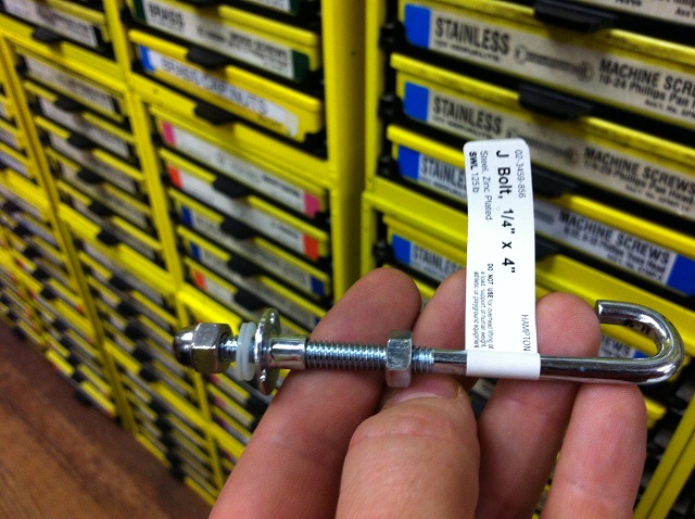

So here goes. Step one: buy two of these:

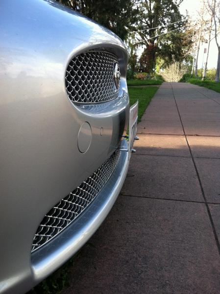

Step two, find center line, and hook through the lower grill:

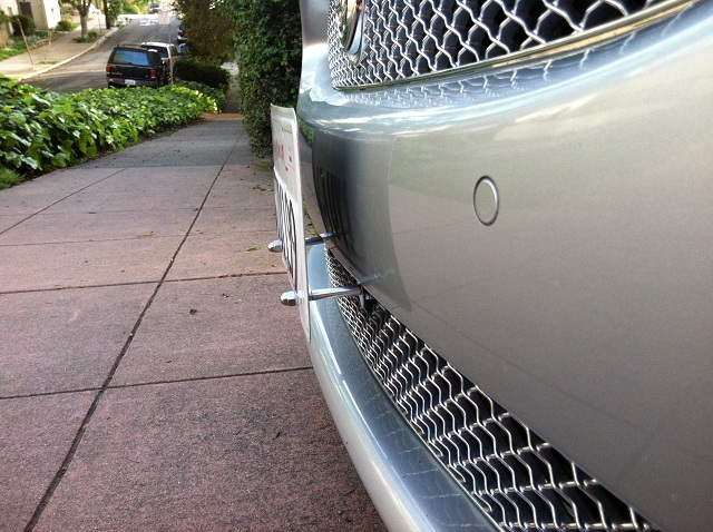

Step three, both bolts through and centered:
Take your time, it requires some fine tuning in terms of positioning, etc. But once in place, the next step is putting rubber washers, followed by stainless fender washers, followed by a short section of aluminum tubing, cut an inch short of where you want the plate to stand off of the nose of the car. Then a washer nut (not sure what they are called) and we get here:
