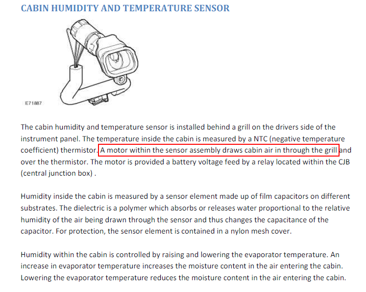

any solution to this? is there another fan behind the center console/infotainment system?
Old Jul 20, 2024 | 08:32 PM
McJag222's Avatar
Joined: Jul 2016
Posts: 1,451
Likes: 857
From: Vancouver BC
Depends where the noise is coming from - some members have had noise issues with motor in the humidity sensor - cleaning it out has helped:
Check this post out:
https://www.jaguarforums.com/forum/x...-noise-162863/
