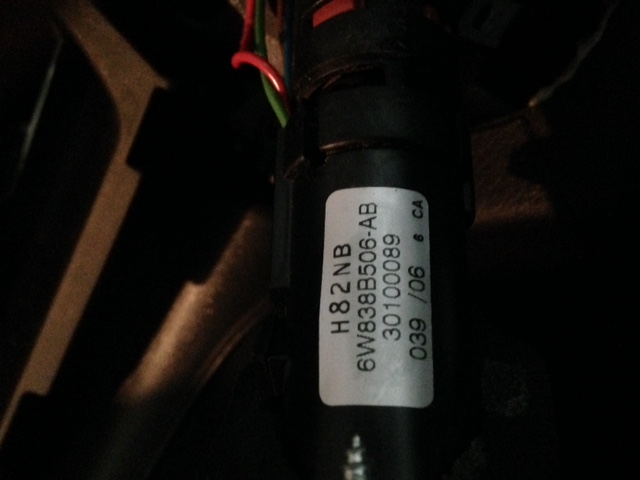

Pic #1 The label on the part. 6W838B506-AB

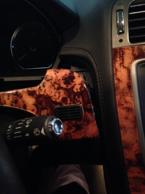

Pic #2- back of Rside of dashpiece. Just wanted to show you where the clips are. There are 2 more on the LH side-way to the edge. Its always scary as hell pulling these things for me but I used only my fingers and worked off one side at a time keeping "flex" of the whole piece to a minimum.

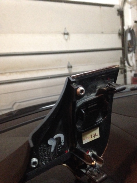

Pic #3 Looking down the inside of the aspirator. That white part is the sensor. The fan is down past it inside of there. You can see the tab with a hole in it at bottom for my one screw hold-down.
