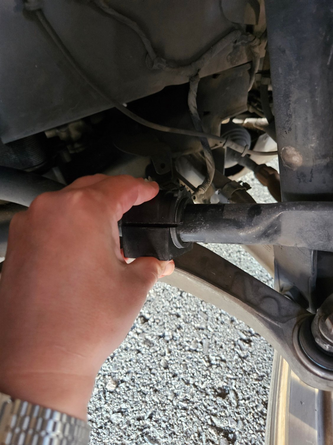

Trying to confirm fitment of sway bar bushing
Front 2010 XK US spec, 1mm gap prior to tightening, does this look correct?

The space can allow compressing the bushing with the bracket, to close the gap.

Thanks, just wanted to double check!
Be aware there are 2 size sway bars for our X150
I turned my wheel out to access the sway bar and
checl fitment, apparently there's no way to know
which size you have without measuring.
