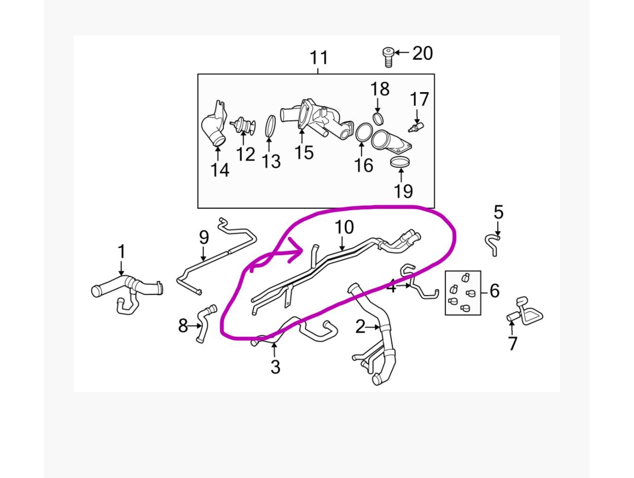

Just received my 200cc siphon kit yesterday, so no Turkey Baster needed.
And what is this black magic of just replacing that hose?
Every thread I’ve read says you have to buy the entire heater hose assembly which is crazy expensive, just to get the hose:
Only workaround I’ve read was that someone bought two hoses (it is diff diameter inside on each end with an 83° bend) with a brass step-down fitting.

Yep I understand your issue. Replace the hose, even if you have to rig it with a brass fitting. The hose you have on there now is damaged. A new clamp might help but not for long. Besides, tearing apart a car is fun. Putting back together and having to leftover pieces is even more fun. You got this.

Oh I’m not blaming anyone or anything.
I was just hoping that since this is such a common failure point and even the entire heater hose assbly is nowhere to be found, someone had come up with a solution.
In my mind it’s a piece of rubber ffs. Can’t be too difficult to make them to spec.
Just need the specs, preferably without having to remove mine.
Update:
I've decided to use AI to help design an ID Silicone 2-hose solution with a 5/8" to 1/2" Gates 28610 (nylon-reinforced for vibration resistance) hose barb splice coupler/reducer. Looks to be about $40-50 total parts and silicone will last much longer and will withstand up to 100PSI as well as much much higher temps.
Once I've received and verified the parts will work, I will either do a video or a bunch of pics and create a walk-through for future sufferers of this annoying and common issue.
