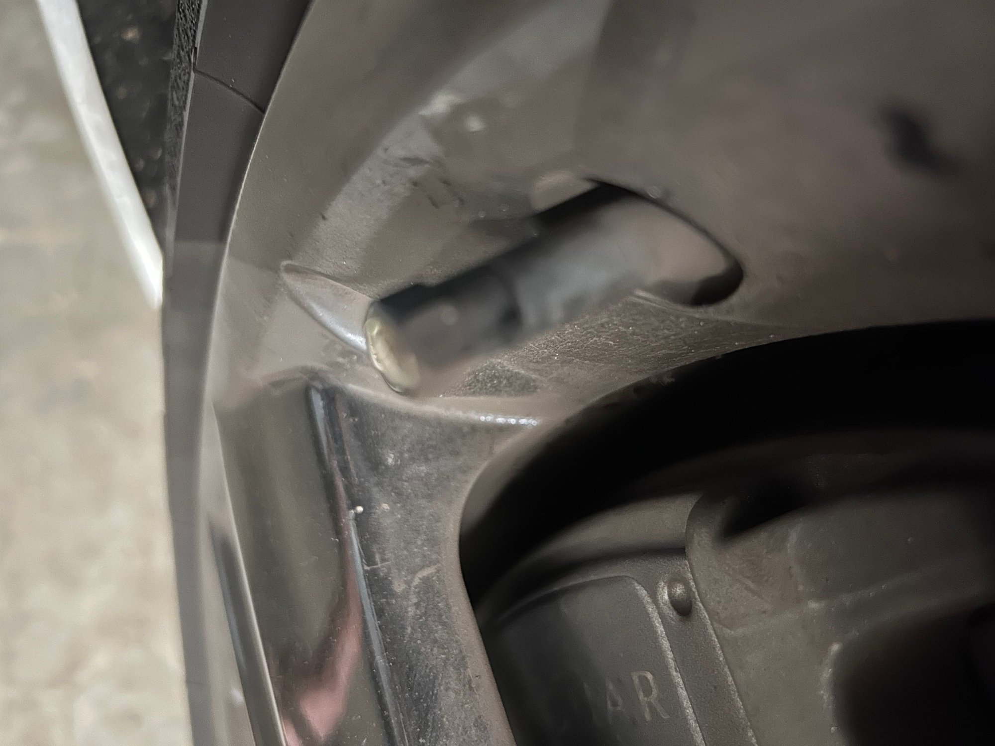

My paperwork with all the specs for the car such as black pack wheel types etc doesn’t say anything about tpms at all. When I run my icarsoft scanner when it gets to tpms it asks me to say yes or no is it fitted? Is there an easy way to find out without getting dirty?

A quick check, although not guaranteed, is to look at the valve stems on the wheels.
Metal - most likely TPMS
Rubber - most likely NOT TPMS

So my valve stems appear rubber and I have been running with one front tyre lower by about 5psi so I don’t think tpms is enabled or maybe not fitted. This is a 2013 South Africa model
Stems feel like rubber

Correct. That is not a TPMS stem. Doesn't mean that car isn't fitted with it though. There may be receivers behind each wheel arch.

Your profile says your location is Los Angeles, so we thought it was a US spec car. Since the car was built for South Africa, and has rubber valve stems, and I’m assuming no TPMS warnings? The answer to plug into your scanner would be ‘not fitted’.
Given the headaches some have had, even if the rest of the hardware was pre-installed, you probably wouldn’t want to turn on the TPMS now.

Jaguar typically shipped higher end (loaded) cars to some countries like South Africa. To @guy point, you don't have tpms valves but it could still be fitted. Pull back the fender arch as he suggest and it you really want to know. you'll see the little antenna looks like a tennis racket indicates the parts are there. But you're still missing the TPMs valves.
I turned mine off long time ago. I just use a gauge. FWIW if you really want it, @arenaej installed BT sending units and displays on his phone - has alarms too. These are internal valve stems. They work fine and that's what I would use if I were to turn it on again and only if I needed new tires because like others, I find it not worth the expense.
