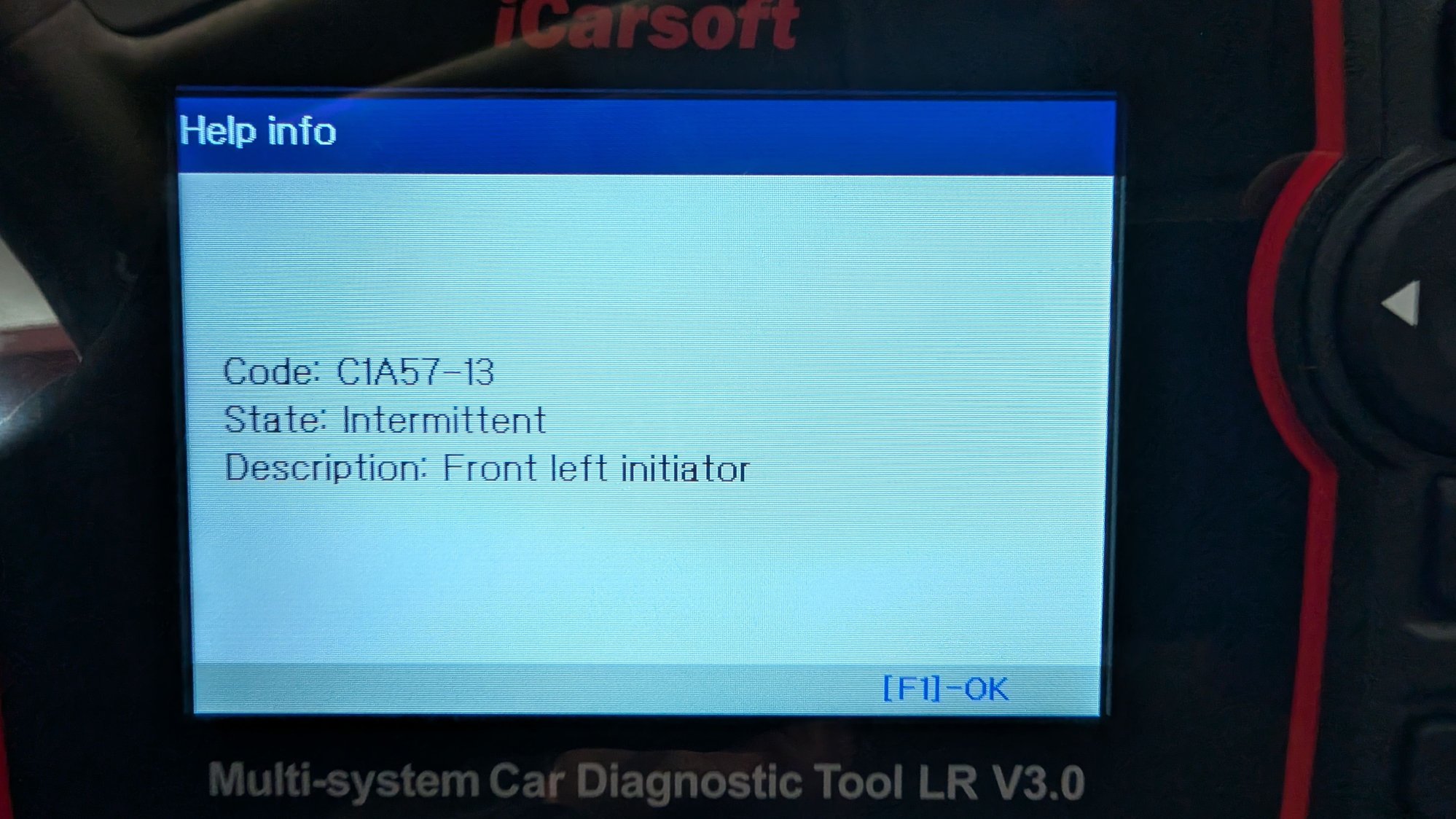

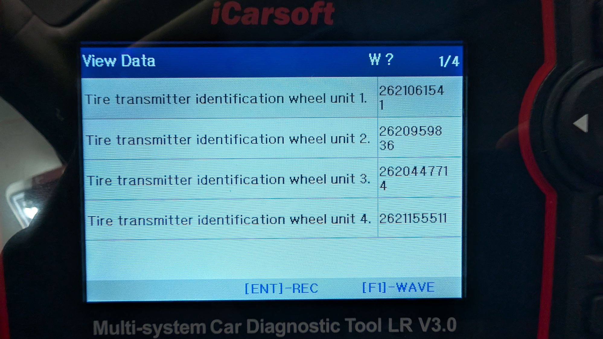

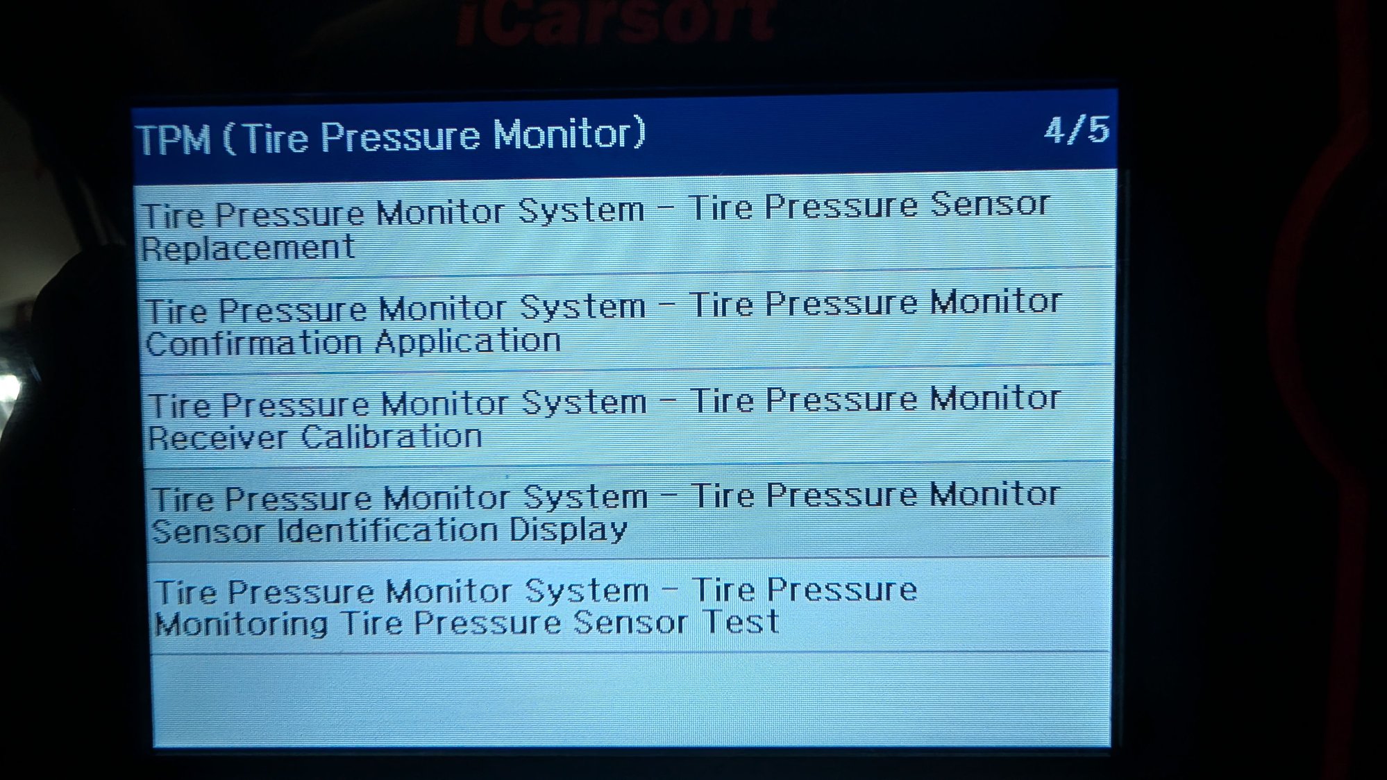

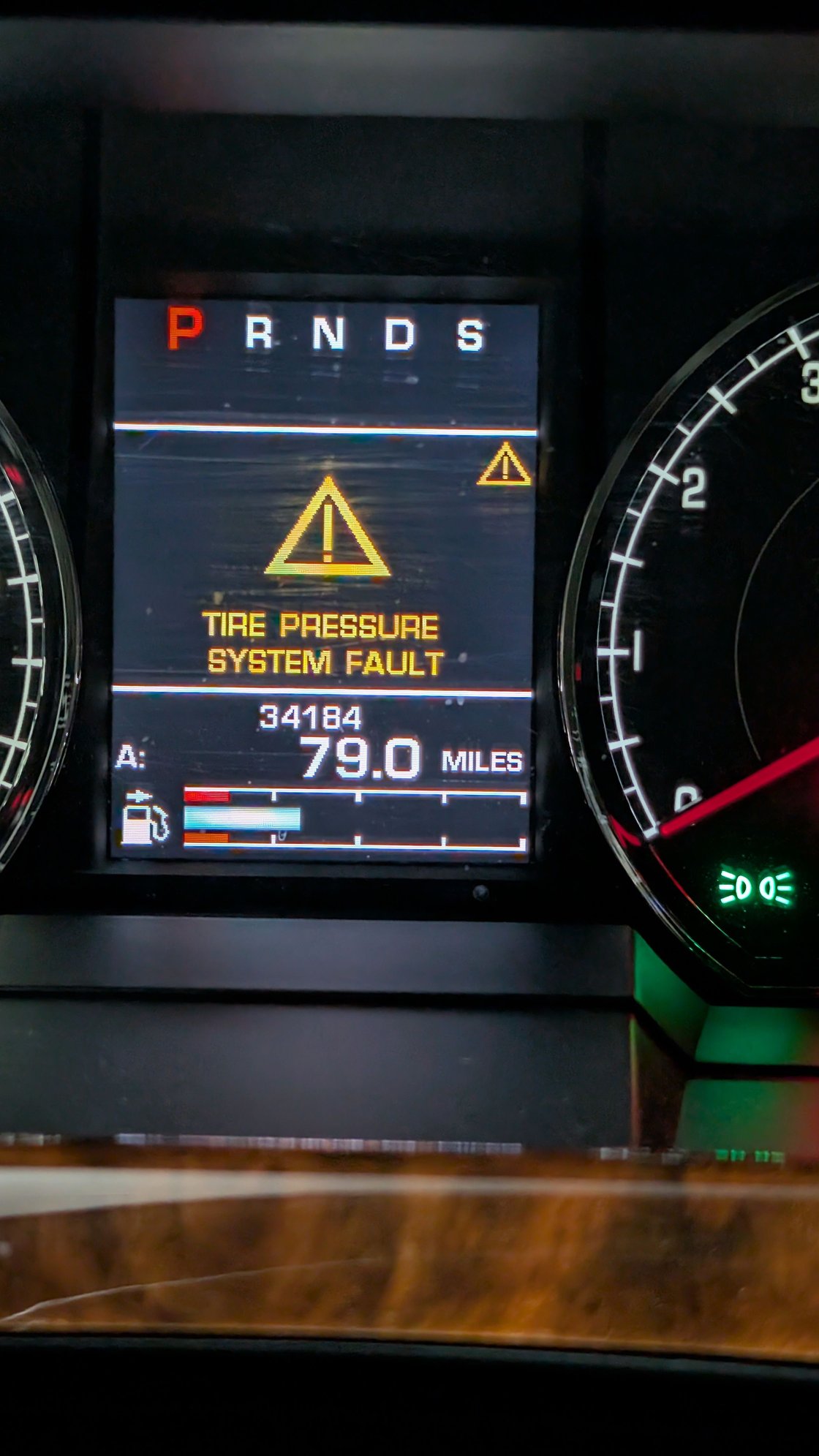

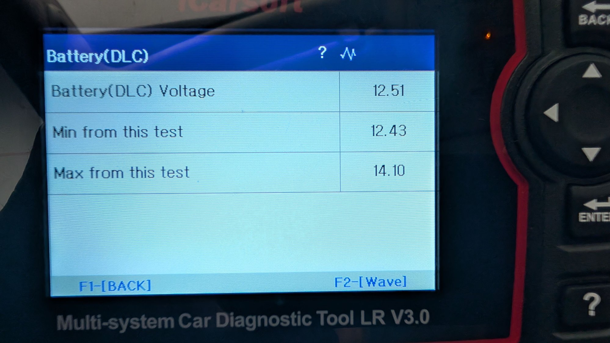

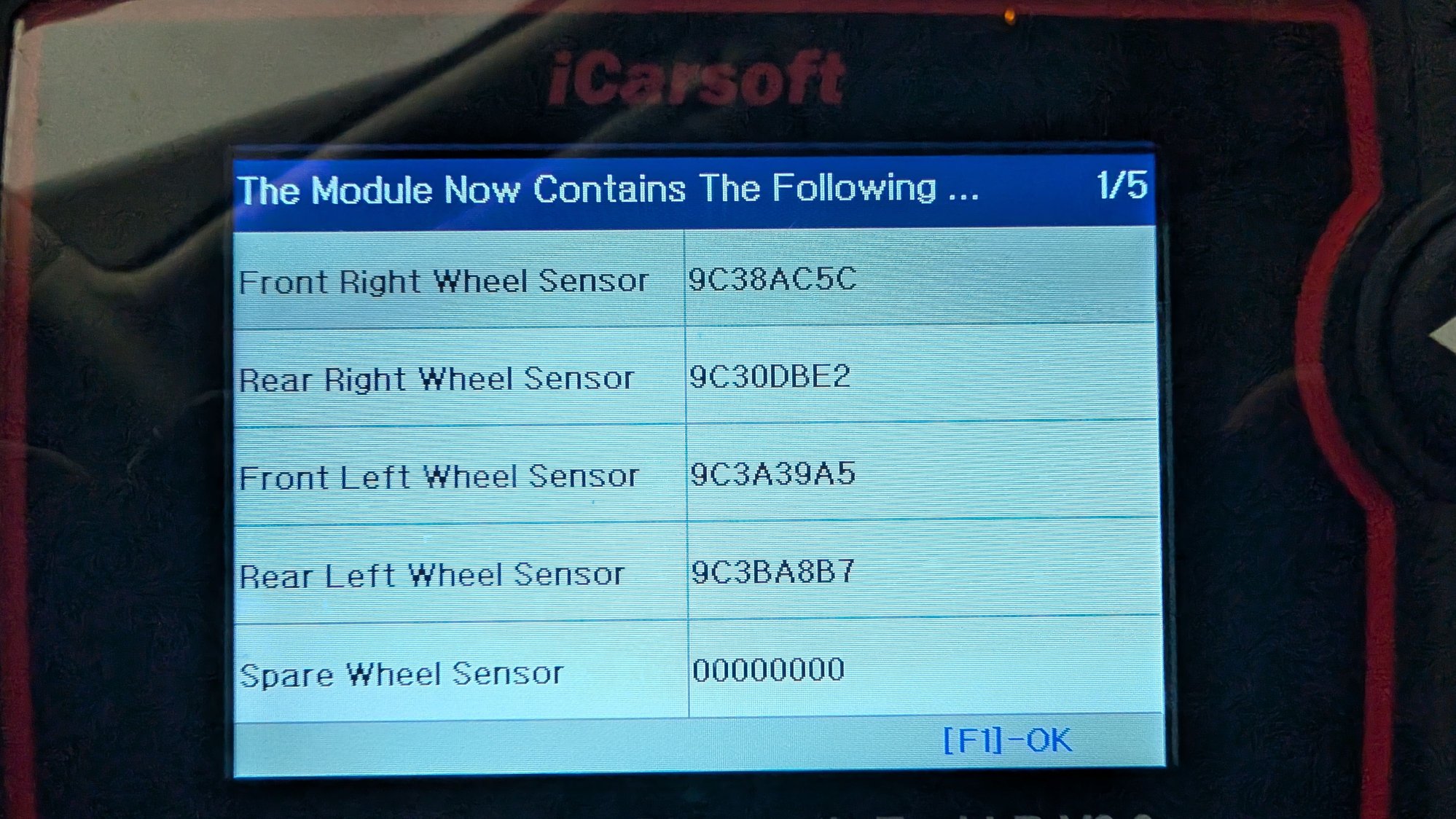

I bought my 2010 XKR in May of 2023 with around 25.5k miles. Soon after I began getting the car icon with the arrow "rotating" around pointing to each tire at a time. I assumed the TPMS sensors were original and bad so in 2024 I had the tires replaced along with 4 new TPMS sensors by Bosch (QF0470) purchased on Amazon.com. I also have an ICarsoft LR v 3.0 DTC. Based on readings, I am getting CODE: C1A57-13, STATE: Intermittent, DESCRIPTION: Front Left Initiator.
Yesterday, I replaced the initiator (tennis racket antenna), on the Front Left and installed the "old Front Left" into the Front Right. Still getting the same error, and both front original initiators and the new initiator read around 1.8 Ohms and when using a voltmeter I get a closed loop beep.
I also pulled Fuse 2 from the Junction Box behind the rear seat center part. In fact, I checked all fuses and even the large 3 bars by the battery. I unplugged the receiver but didn't look for the module as I was under the impression that was under the right/passenger front seat or at least that seat needed to be removed to get to it.
Using the Icarsoft DTC, under TPM I have "Tire Pressure Monitor System--Replacement where all Bosch sensors are registered. "Tire Pressure Monitoring Confirmation Application" which works fine, "Tire Pressure Monitor System--Receiver Calibration which also completes fine, then I get to "Tire Pressure Monitor System--Sensor Identification Display gives me a Communications Failure.
I haven't removed the bumper cover but have removed both headlights and tracked potential pinch points on the wires, removed the electric tape and re-taped each wire individually than the set together.
After reading this Sub-forum it appears a few of you had success after replacing the TPMS sensors with VDO/Siemens which are the original sensors. Before spending another $300 on this potential fix, I was wondering if anyone has/had the same issue and found replacing the receiver and/or module brought you any success.
Any tips/suggestions are much appreciated.
