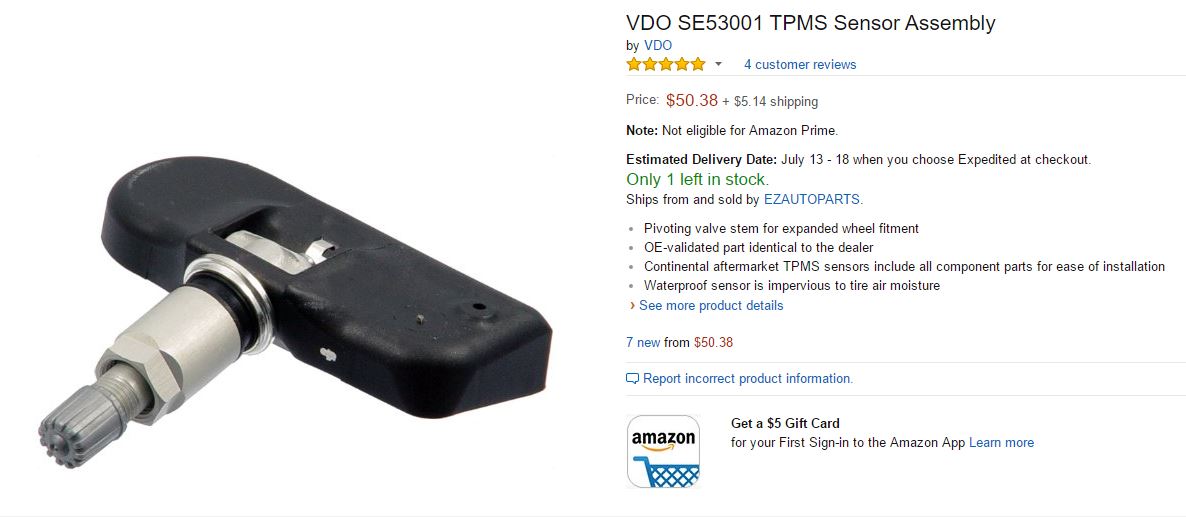

UPDATE:
2 years ago when having a new set of tires installed on the Jaguar XKR, I also purchased a set of new TPMS to replace the OEM TPMS that was originally placed in the car.
I made the purchase via the internet from vendor OE Wheels who stated the TPMS was a match to my 2009 Jaguar XKR. I made the purchase.
Over the past 2 years, the new TPMS worked intermittently, going on and off. It was truly annoying.
After the most recent post by member RICHEYJ I decided to buy the OE TPMS sensors #VDO SE53001 TPMS from Amazon. The cost was $222.00. These are VDO Siemens OEM sensors and were quite different from the sensors purchased 2 years ago. VDO Siemens makes the OEM TPMS for the Jaguar brand.
I had the new VDO sensors installed at my local Discount Tire for $12.00 each.
Then the test. Immediately after leaving the shop, I got the dash warning showing the icon of the car with the red warning moving from one tire to another showing low pressure. After 2-3 minutes the new VDO sensors picked up 2 of the 4 tire pressures and within 5 minutes the new sensors picked all 4 tires and the dash warning went out. The warning as not come back on. The annoyance is over and it feels so good to have the proper TPMS installed.
The Jaguar XKR was performed flawlessly from the first day of delivery, but the TPMS drove my nuts.
A big THANKS goes out to Jaguar Forum member RICHEYJ for the making the post and supplying the proper OEM TPMS.
If any other member is experiencing the same frustration and intermittent TPMS warnings in the center of the dash. I would highly suggest to replace the sensors with this exact model and make sure 100% it is compatible with your model year.
Problem resolved and it feels soooooo good.

I have now driven the XKR 131 miles without any TPMS problems. I am convinced the last set of TPMS ORO-TEK brand was not a compatible set for the 09 Jag XKR.
The VDO53001 TPMS have worked perfectly.
If you're getting intermittent readings on the instrument panel and the flashing tire icon, consider replacing your old with new Siemens VDO53001 sensors.
You have no idea how happy I am to get this past annoyance out of the way.

Syd:
Each wheel has a TPMS sensor transmitter. Simply remove the wheel and tire, then use an appropriate Torx screwdriver to remove the screws which can seen easily. You will then remove the wheel well liner to see the transmitter. You will find the TPMS sensor transmitter easily. It looks like a tennis racket. These are very low priced to replace.
From there you can follow the wiring, but not all the way. There is a strong possibility that a loose wire connecting the transmitter is causing the problem, They have a simple wire connector that may be loose.
A few questions...
1) What type of dash warning are you getting?
2) Do you see an icon of the car and the 4 tires in the center of the instrument panel?
3) Do you see just the tire that flashes then goes SOLID in the right round instrument panel?
Click the image to enlarge and then click again for full screen.
Perhaps one of the transmitters came loose. Perhaps on the TPMS sensors got damaged upon the damage with the car.
You can replace the transmitter or replace the TPMS sensor seated in the wheel with the Siemens VDO 53001 from Amazon.com.
Attached Thumbnails TPMS System Fault-jaguar-tpms-transmitter.jpg   TPMS System Fault-jaguar-tpms-vdo-53001-sensor.jpg
