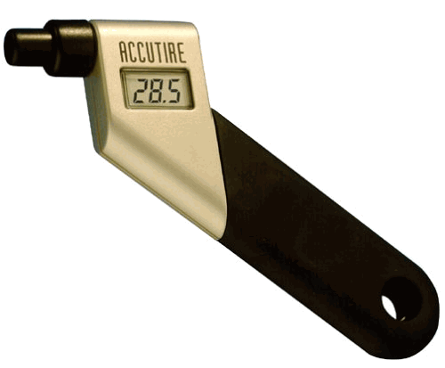

I check my tire pressure on a regular basis with an Accutire MS-4021 gauge.
Attached Thumbnails TPMS-Tire Pressure Monitoring Sensors-accutire-ms-4021.gif
