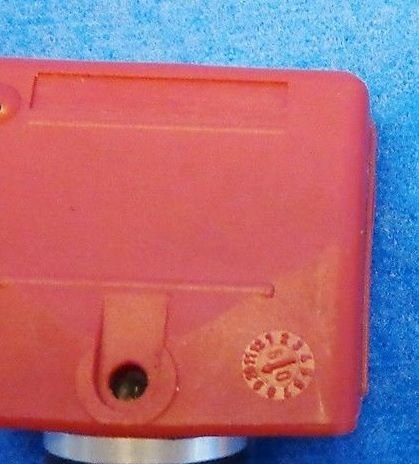

Originally Posted by Stuart S
I enlarged the photo and looked for a date code but couldn't find it. Maybe it's on the other side. That's important because the battery degrades while it sits on the shelf, so a sensor manufactured 10 years ago probably won't have a lot of life left. Maybe that's why they were so inexpensive.
Googling for TPMS sensor date codes, I found that some manufacturers use something like this:
TPMS with an October 2009 (10/09) manufacture date.
So maybe that could be on another side of MarkyUK's unit.

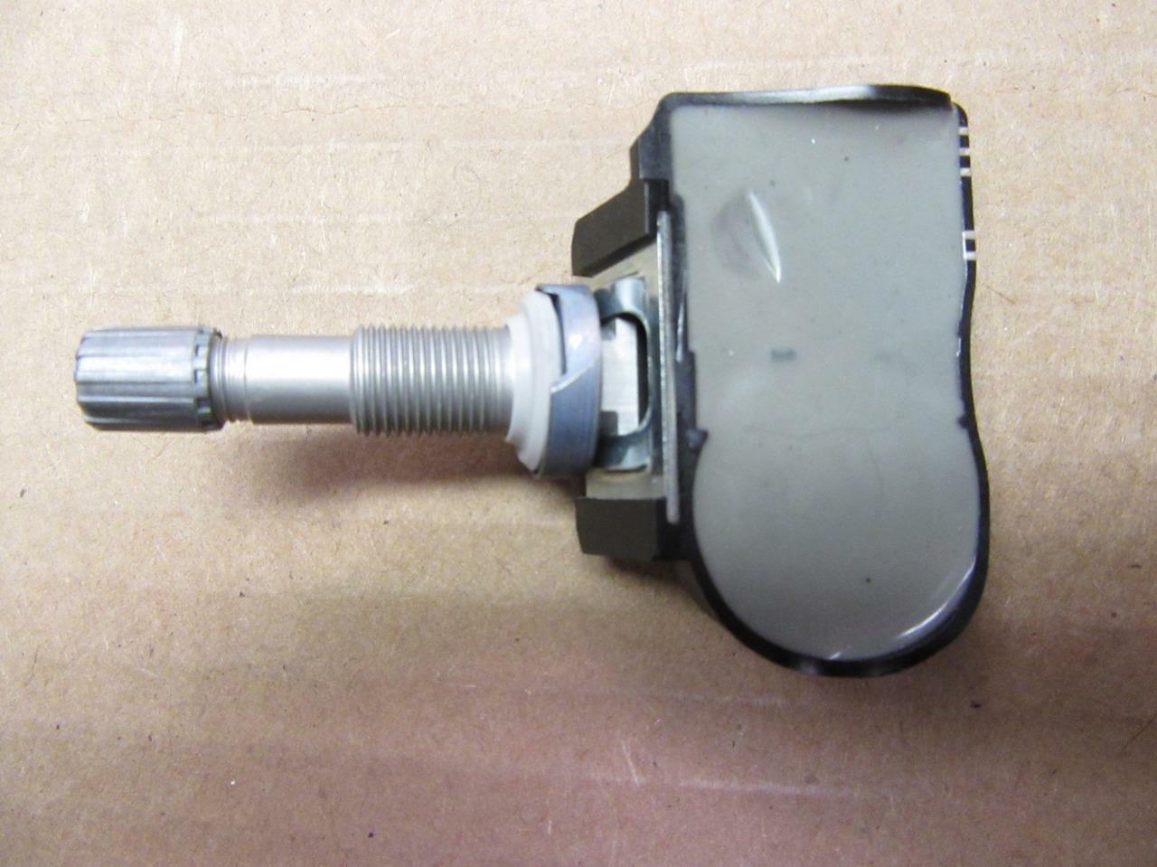

Thought the same thing. Part # GX631A159AA fit Rovers ranging from 06 - 2019. Marky probably knows what year his came off of. Here's a pic of the backside:
