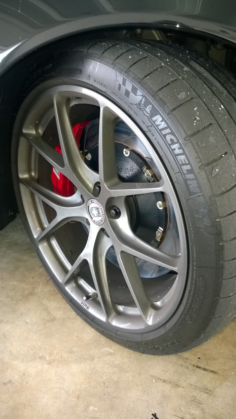

BTW: Albert heres a shot of the PSS tires after the second session. Tire temps were 177 outside 178 inside and 180 outside
Looks like the car likes the present cambers. I suspect those readings are Outside, Middle, Inside. Close enough to be even temps.
From the picture, nice texture on the tire. Seem to be picking up gravel as you drive off track, indicating to me that the compound gets really soft when it is hot. Just like racing slicks.
I'm super impressed with the PSS tires I'm pushing them really hard on the track and as you can see they get super soft. That right front was also getting hammered in the banking, I was pulling 1.2G at around 115 MPH through turn 3 and 4. They pick up a lot of rubber as well so when you are leaving the track they feel out of balance until they shed the rubber. The fact that they are not even half worn after monthly track days and 4k miles of driving is pretty impressive.
The guy set up by suspension and alignment was in the garage next to me and said the tires looked perfect. The tire temps across the back are pretty even as well and with the banking the -2.0 in the right rear was an advantage.
