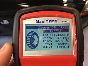

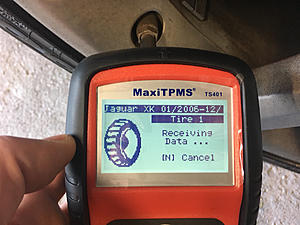

Before throwing new sensors at the car, find a tyre shop who has one of these TPMS scan tools.
You can test each sensor while it's still inside the tyre, and it will also tell you the battery condition in each sensor too.
If all four sensors check out, then you're probably looking at a receiver fault.
