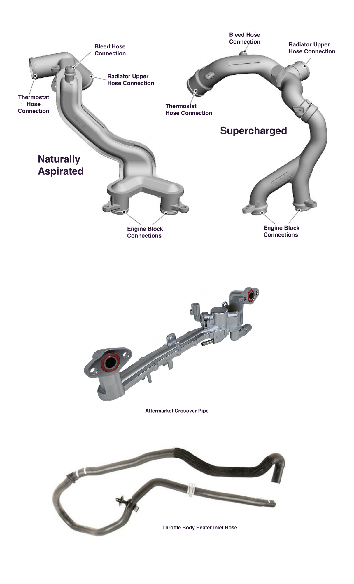

Quick “Valley Pipe” Clarification (5.0 AJ133)
I’d been struggling to reconcile a lot of the online posts and advice about “valley pipes” on the XK100 and X150 with what I’m seeing in the factory documentation, so I did a deeper dive.
For the AJ133 5.0 NA, here’s what’s actually there:
Front of engine: Outlet Tube
• Rigid, externally mounted
• Located forward in the valley between the cylinder heads
Rear of engine: Crossover Pipe
• Routes coolant across the back of the engine near the firewall
• Not a valley component
• (Aftermarket replacement shown in the image)
• Throttle Body Heater Inlet Hose - Goes from the Swirl Pot to the Throttle Body on the 5.0's
The term “valley pipe” generally applies to earlier Jaguar V8s (notably the 4.0 / 4.2 supercharged engines) that used rubber coolant hoses routed under the intake in the V. That architecture does not exist on the 5.0.
The AJ133 5.0 NA has an “Outlet Tube” in front and a “Crossover Pipe” in the rear and the Throttle Body Inlet Heater Hose.
A lot of aftermarket listings call the front outlet a “Y-pipe,” which adds to the confusion.
Comments which follow we posted before this clarification.
(Thank you for your encouragement and support!)
Outlet and Crossover and Throttle Heat Tubes - 5.0L AJ133

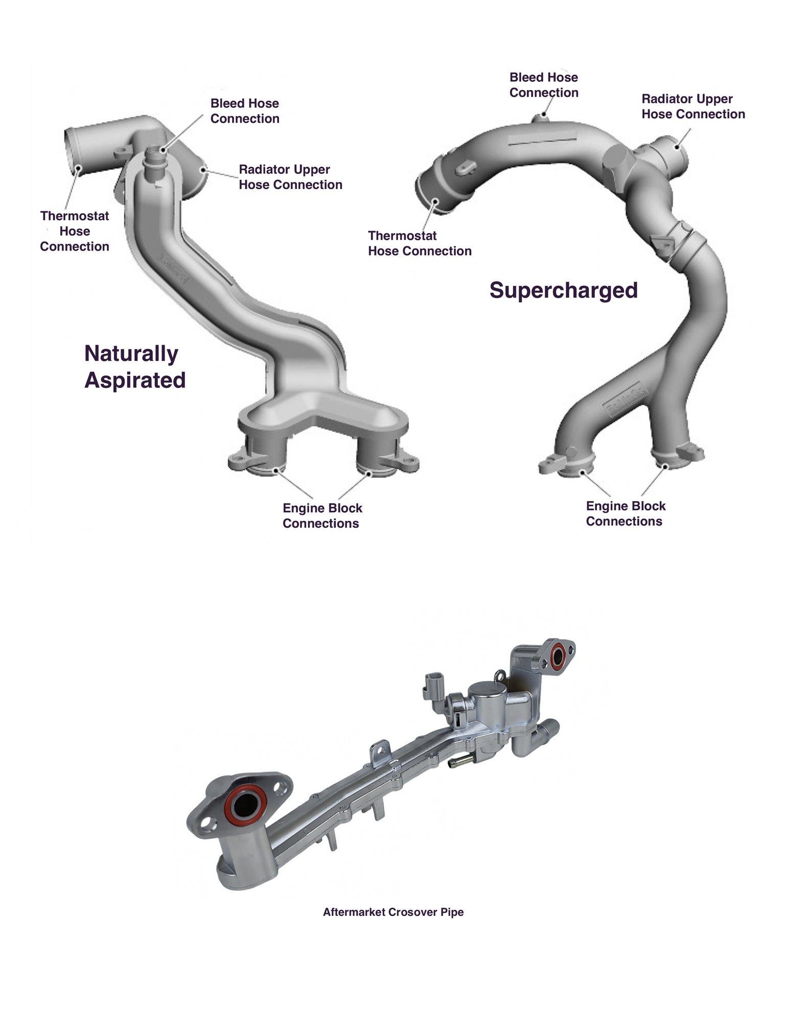

• Not under the intake manifold
• Not located in the valley between the cylinder heads
• Also not a valley component
The term “valley pipe” does apply to earlier Jaguar V8s (notably the 4.0 / 4.2 supercharged engines) that used rubber coolant hoses routed under the intake in the V. That architecture does not exist on the 5.0.
The AJ133 5.0 NA has an “Outlet Tube” in front and a “Crossover Pipe” in the rear..
Neither is located in the engine valley.
Outlet and Crossover Tubes - 5.0L AJ133
does anyone make metal versions of these?
also what preventative maintenance is recommended on the 5.0na motors ?

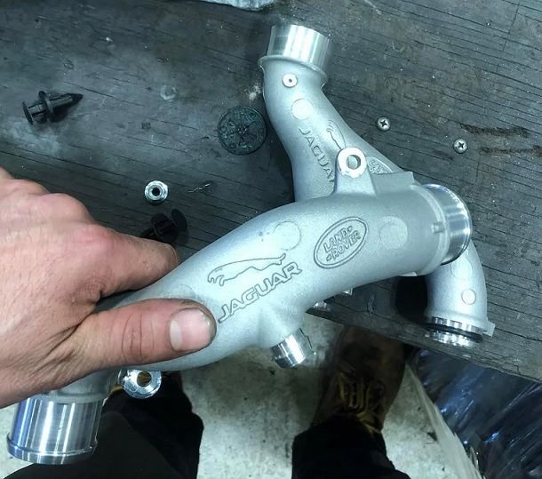

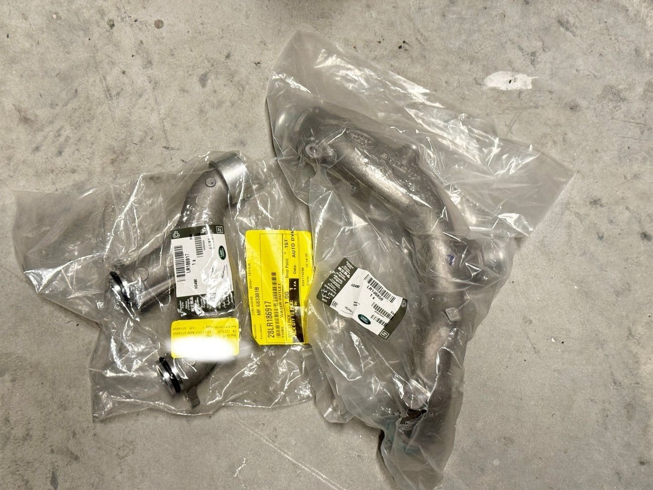

Yes in 2025 or so JLR went back and released the pipes in Aluminum! Surprised that happened. Still not a lot of information about them but we have seen a few pictures.
They do have Jaguar branding cast into them.
But there is some part number differences that have never been explained either.
And with the level of counterfeit parts in 2026 we have to be cautious that these might be as well.
