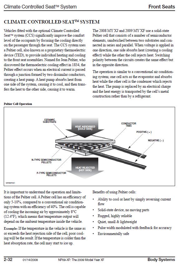

I would assume that the seats in the XK work in the same way as the XJ and XF, i.e. using the Peltier effect not air from the A/C?
That would make more sense. I just know they work very well.
