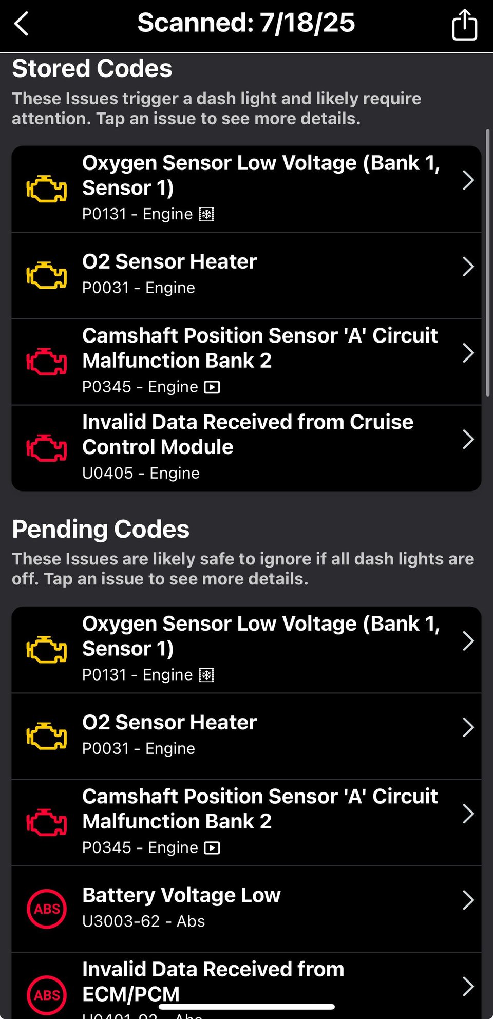

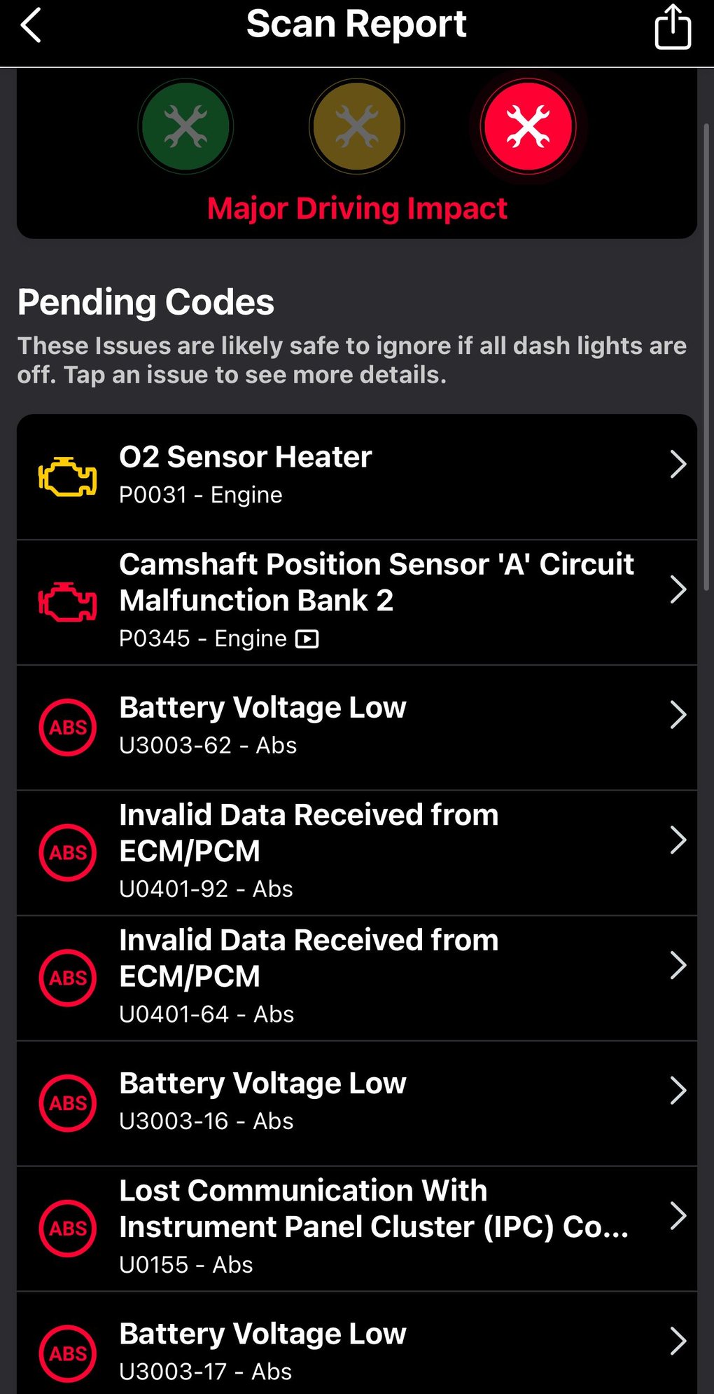

Whelp that was a bust. No unicorn here.
Top did not work at all. Unlatched, rose an inch and stuck. Could hear a motor going but nada.
Couldn’t find the manual allen key.
Fairly decent sized new (paint chipped off on top and was still shiny new) dent on passenger hip.
round enough to be paintless removal but would still need a spray.
Only one key fob and it didn’t work.
Antenna broken off, but I could hear the motor works lol.
Interior was mediocre for a 2007. Bumps, bruises and leather coming off top triangle in front of quarter window driver’s side.
Engine started and ran fine. But threw the codes below and the check engine light came on again after I cleared it.
Drove great, shifted quickly and smooth with paddles and without.
Top didn’t need replacement after all, but rear window was leaning into headliner and did need to be glued.

If it drove and operated perfectly what exactly turned you off to it for $8K??? A 20 year old car isn’t going to be in pristine cosmetic condition especially for that price range. I reckon someone here is going to ****** it up. If it was a colour I like I’d be flying up there tomorrow!

Just realized I didn’t post the image for the codes.
It ran well on the shirt test drive, but there are def issues.
Totally true that an 18y old car isn’t going to be perfect.
But as I added up the things in my head, it would be near 20k total in to get it there.
(I’m not a big DIYer. I can do small to medium things)
I am eyeballing a 2008 xkr portfolio for $21.5 that is pristine.
Honestly though, it was clear the owner didn’t take care of it before he passed. That was my deciding point.
Be a great project for anyone who wants to put in the time and effort. Just too many unknowns.

For future reference low battery voltage can affect the canbus network with module communication failures which’ll trigger a number of DTCs. The O2s though could be an issue due to repeated starting but not driving. Best to reset all and drive for a while and see what comes back.
