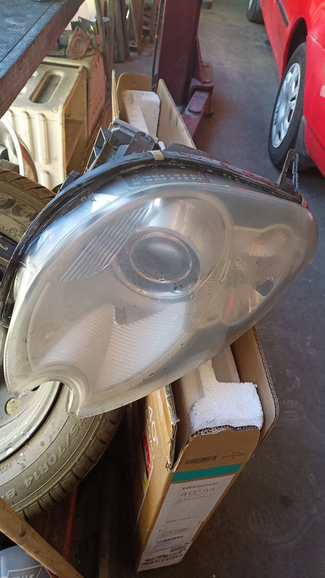

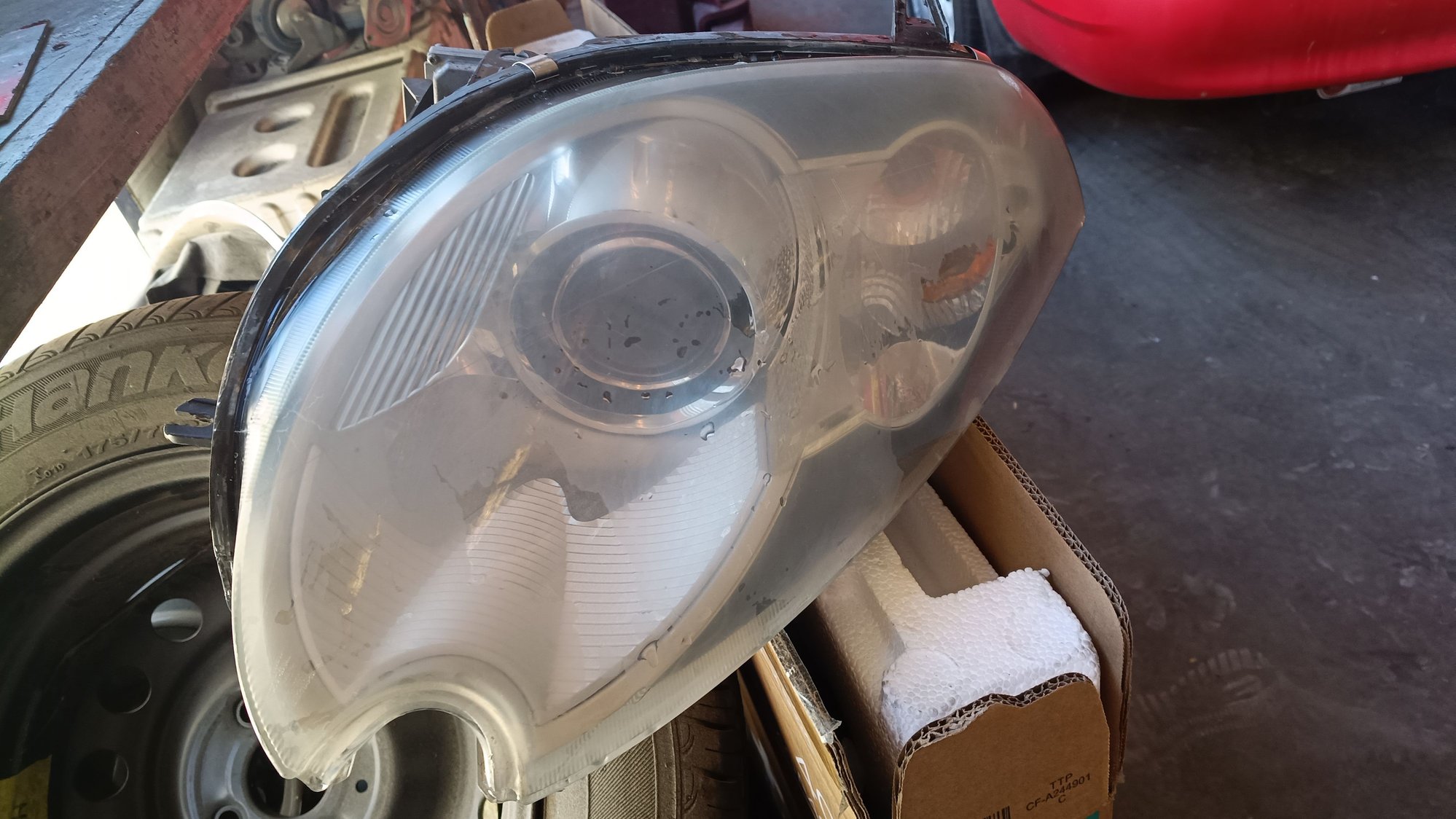

Next task clearing the headligjts in 2k clear
Wet 1200 followed by 2000 grit
I polished my lens after 2000 grit sanding. They have held up for 2 years, starting to yellow a tad.
wj
That's pretty good actually
Mine were done about 7yrs ago and I just noticed it starting to flake and 2k is great it won't dull off or yellow it's quite resistant to the elements as well

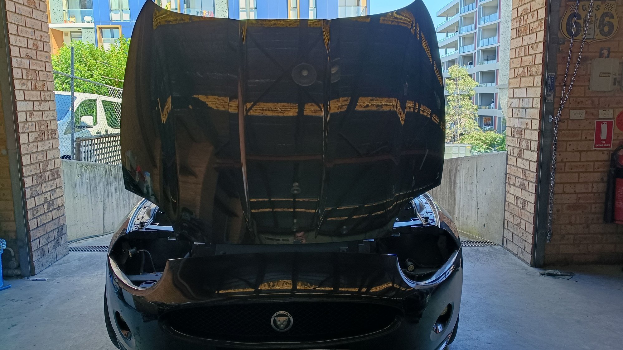

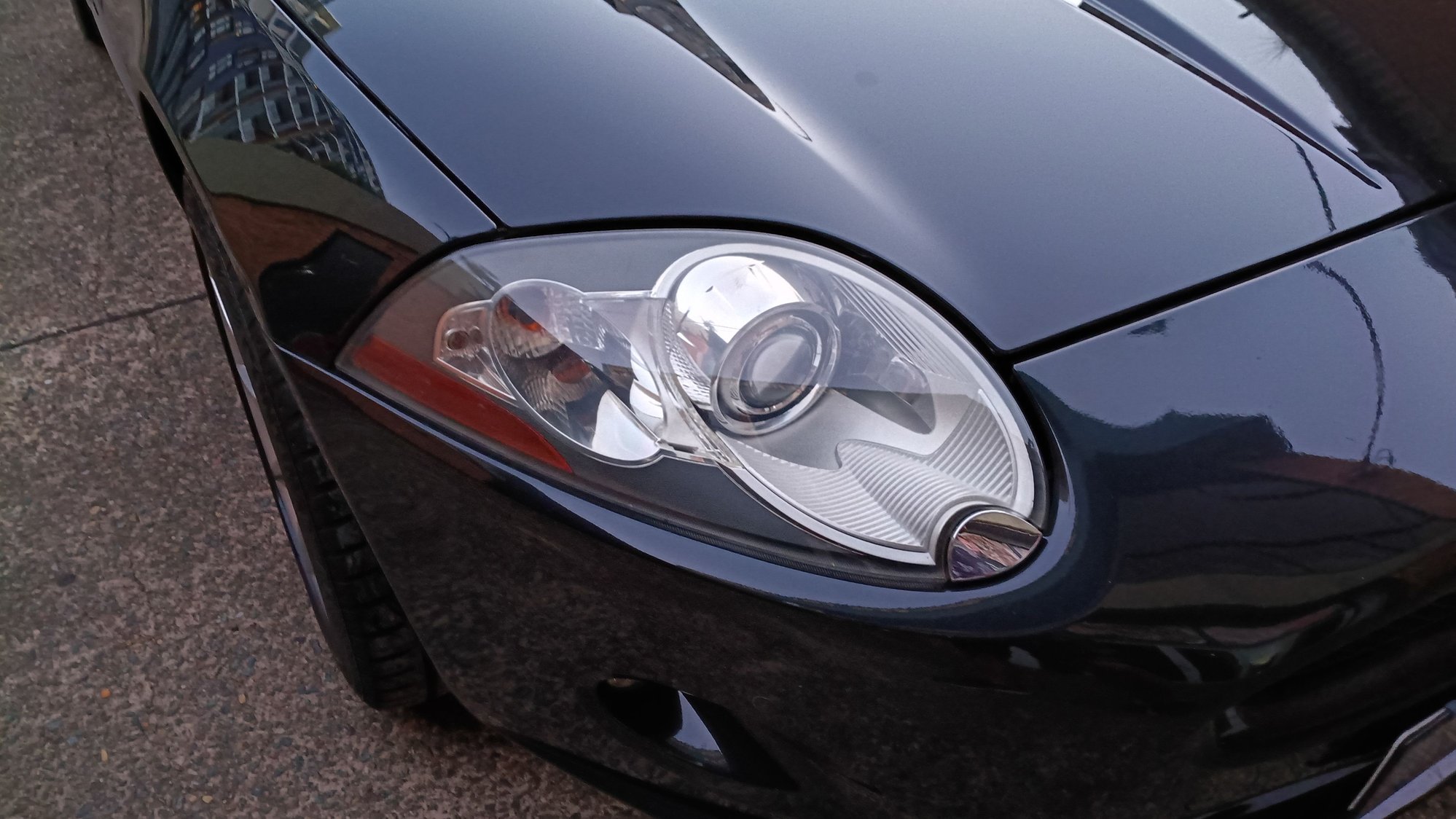

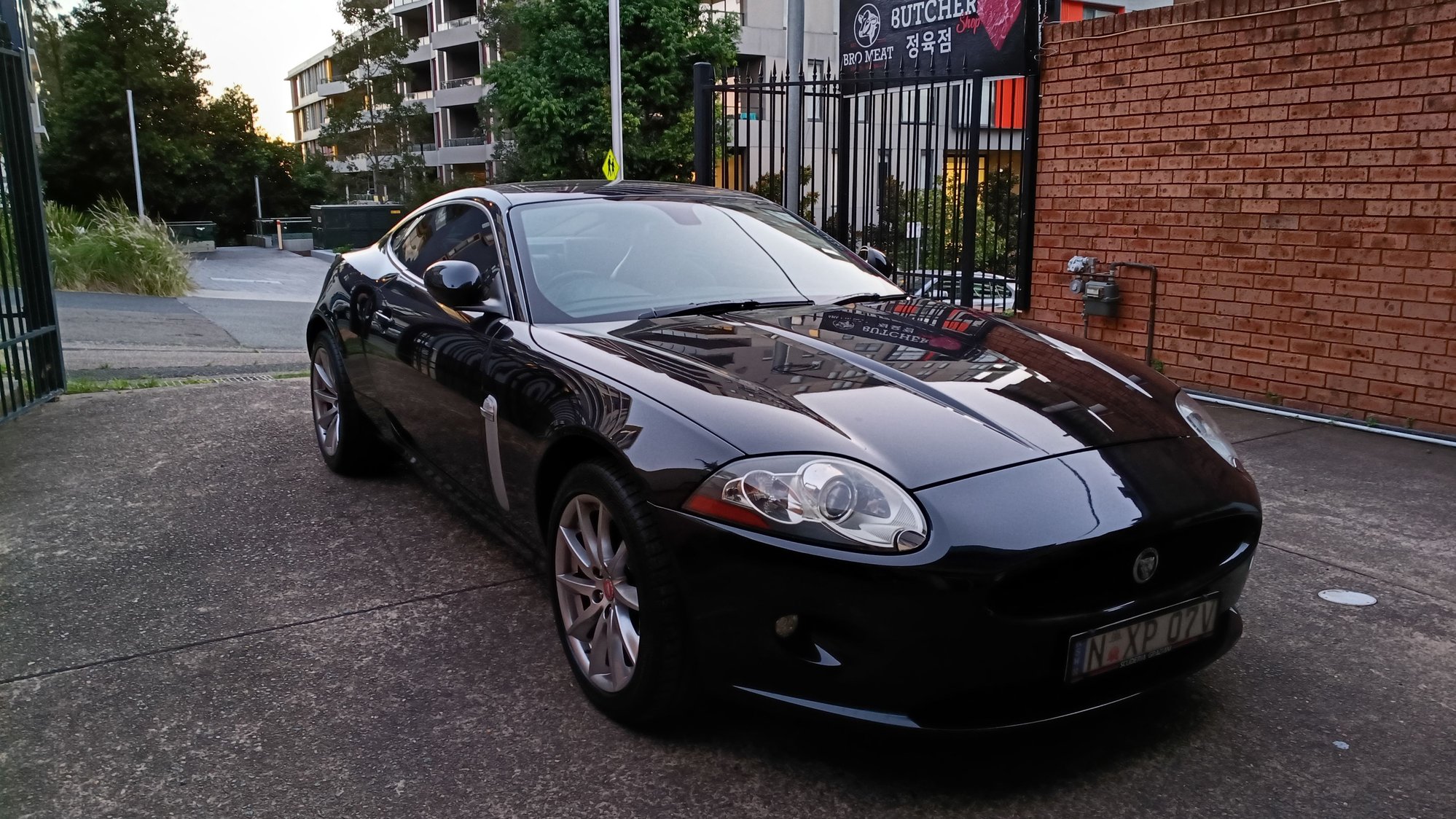

2k cleared headlights installed today should be good for another 7-10yrs

The headlights look great as does the auto!

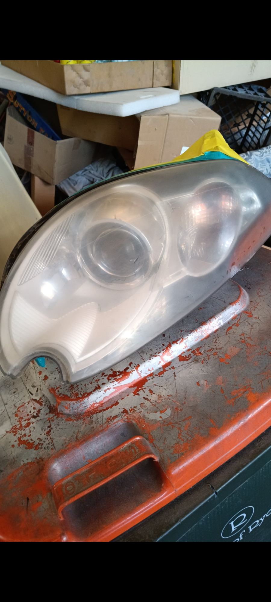

Originally Posted by guy
Did you clear coat them, after the polishing? I did that and they look as good as new.
Guy no polishing I went 1200 then finished them off with 2000, followed by prepsol to prep the surface then cleared.
This is how they looked before applying 2k clear
This is how they looked after sanding , then cleared .
