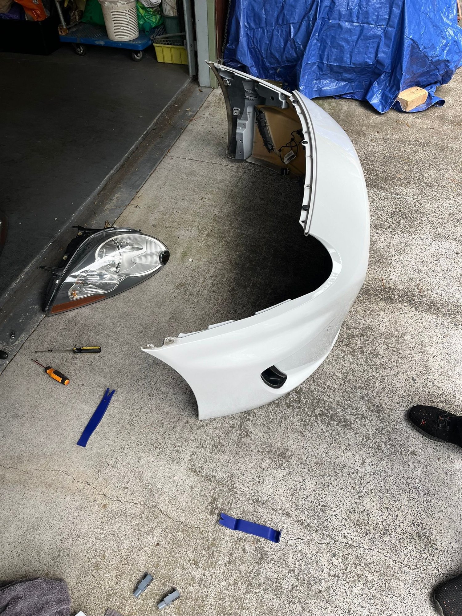

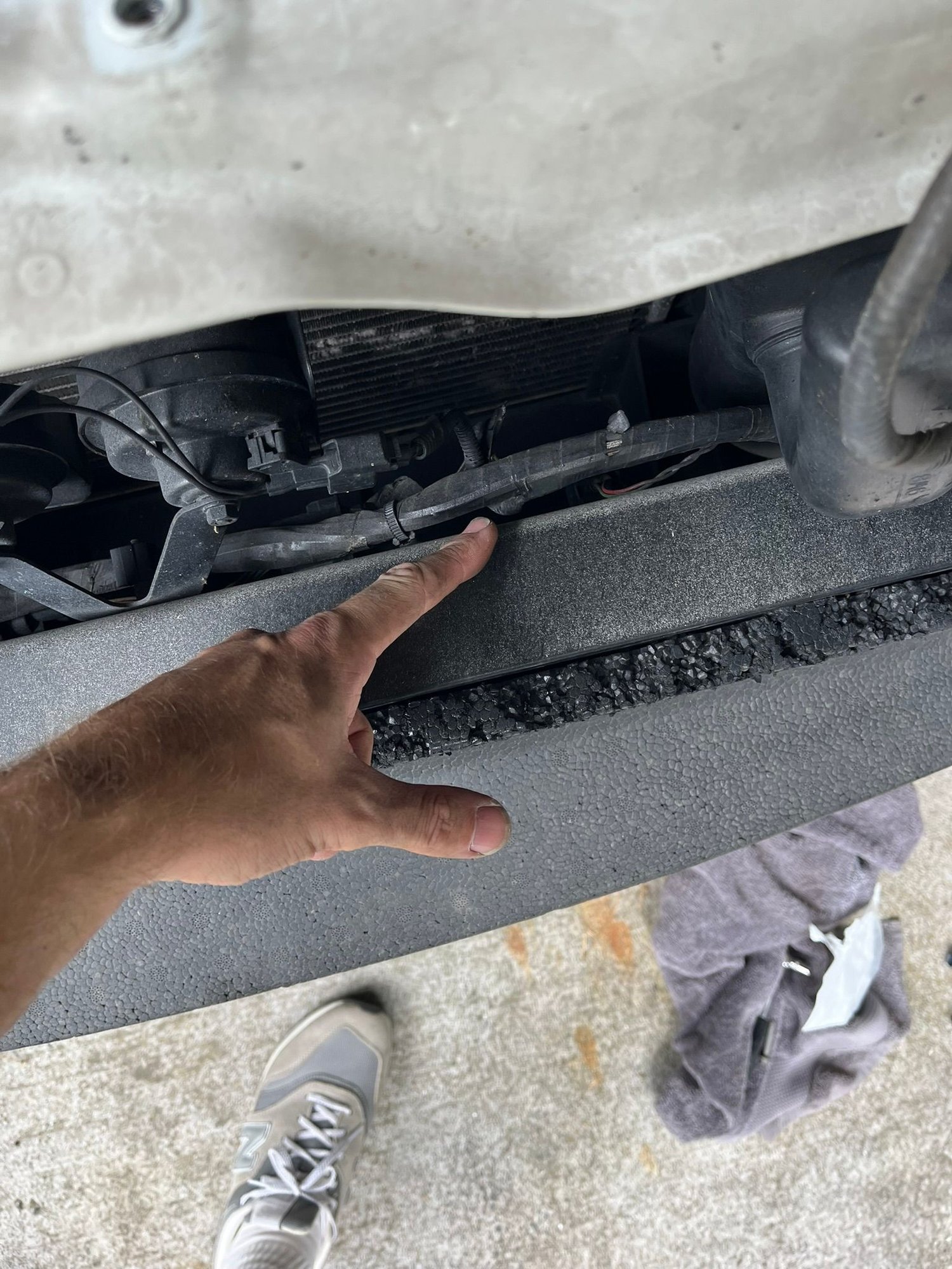

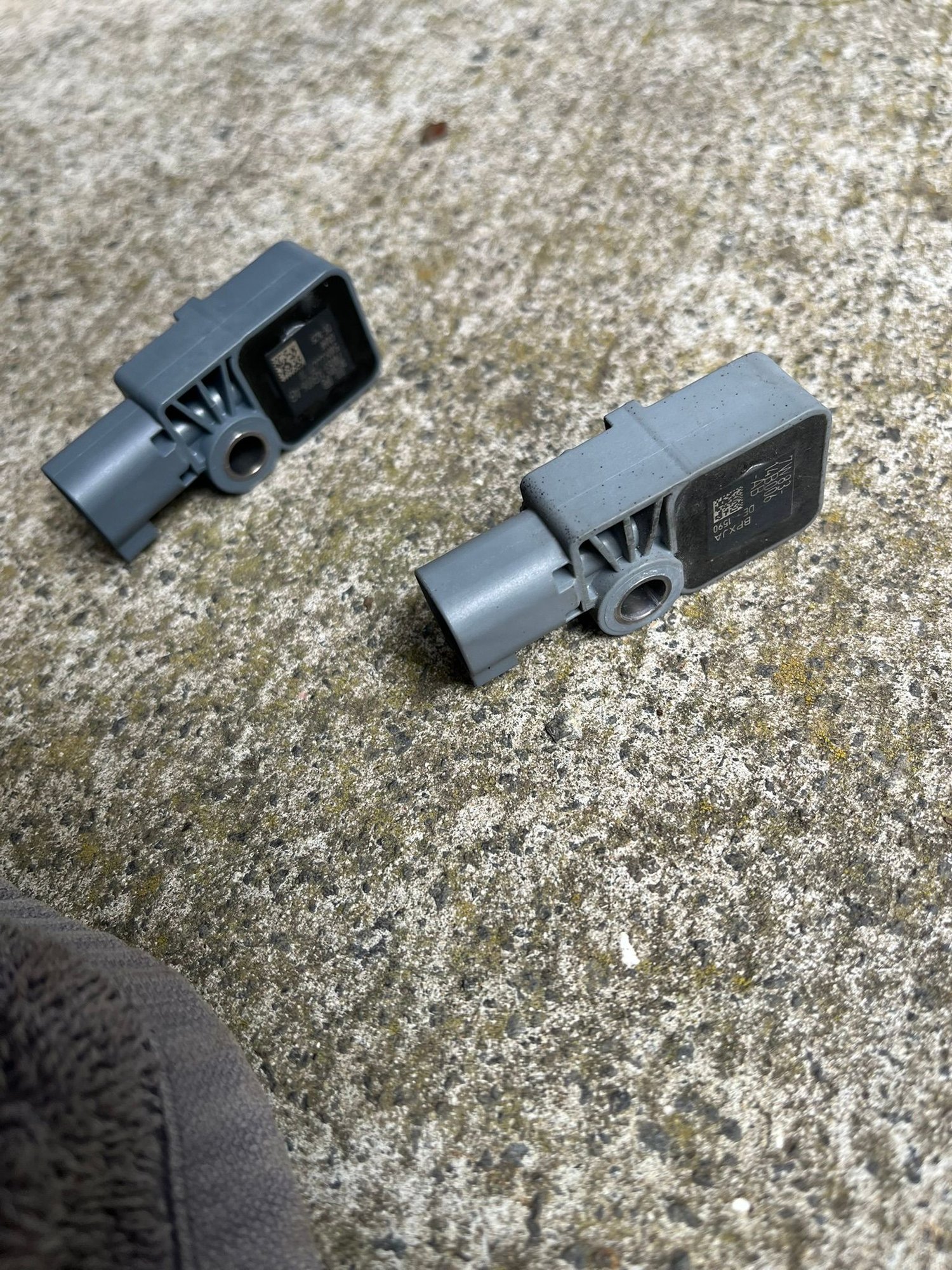

Today I replaced the left pedestrian sensor which was starting to cause errors. Unlike on earlier cars the only way to access these on the 5.0 XKR is to take off the bumper. Fortunately that isn't a very difficult task and all up took me about 2h to do with some breaks and cleaning in the middle of it.
They hide behind this crash beam which you cannot get to from either the top scuttle panel or the radiator splash tray.

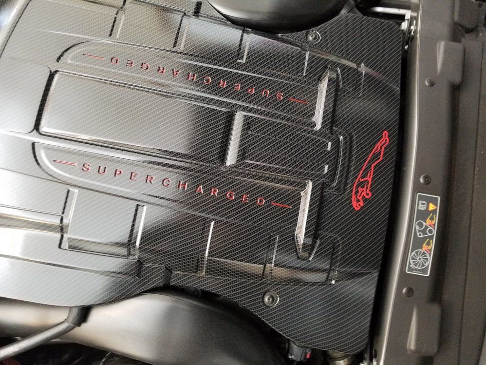

Originally Posted by Circumnavigator
You won’t regret that mod.
Some have the Supercharger lettering stenciled.
Don’t forget the two covers near the windscreen!
This looks fantastic. I’m about to do mine, but can you tell me what container you used to dip the engine cover in? I’ve got a concrete mixing tub on order, but concerned it’s not good as it tapers inwards as it deepens and I’m concernred it won’t allow me to dip deep enough. Your advice appreciated.
It was done by the previous owner. He paid someone to do it, so unfortunately I don't have that info.
This looks fantastic. I’m about to do mine, but can you tell me what container you used to dip the engine cover in? I’ve got a concrete mixing tub on order, but concerned it’s not good as it tapers inwards as it deepens and I’m concerned it won’t allow me to dip deep enough. Your advice appreciated.
I had mine done in 2014 and it still looks great. Click this link for details. Note that photos are missing until you get to Post #14.
I didn't have the other plastic covers done because that's how the factory did the XKR-S GT. See https://share.google/hl4T3wRLKjzS1syGo
To keep it like new, I always open the hood when I get home and park in my garage. After the cover is cool, I wipe it off with a damp microfiber towel and close the hood.
