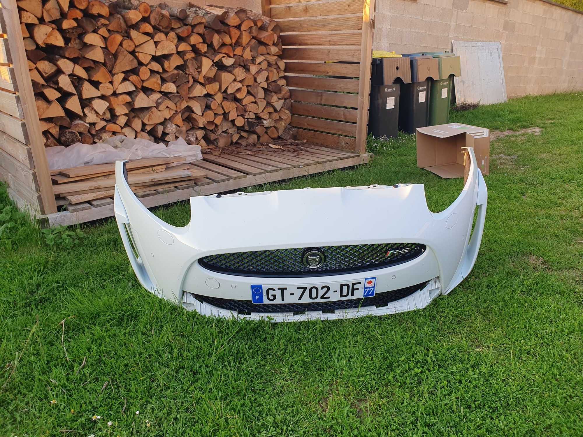

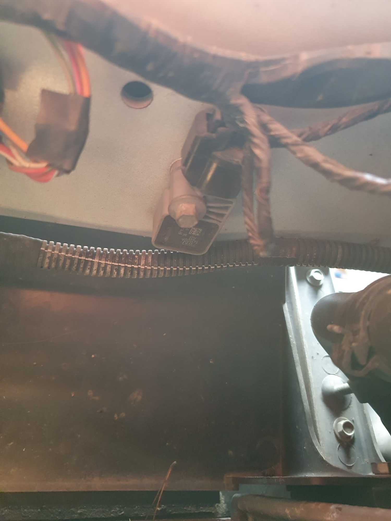

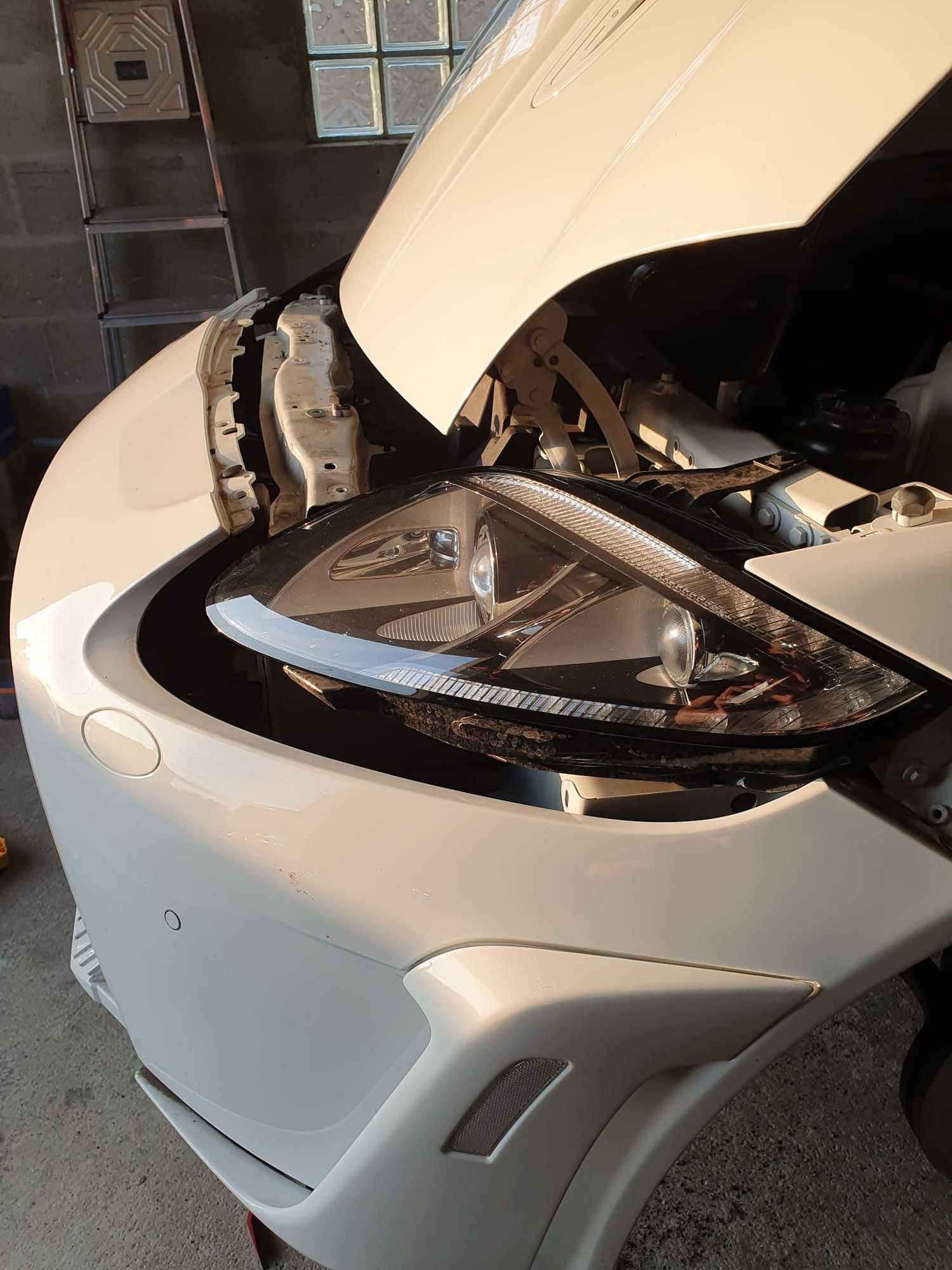

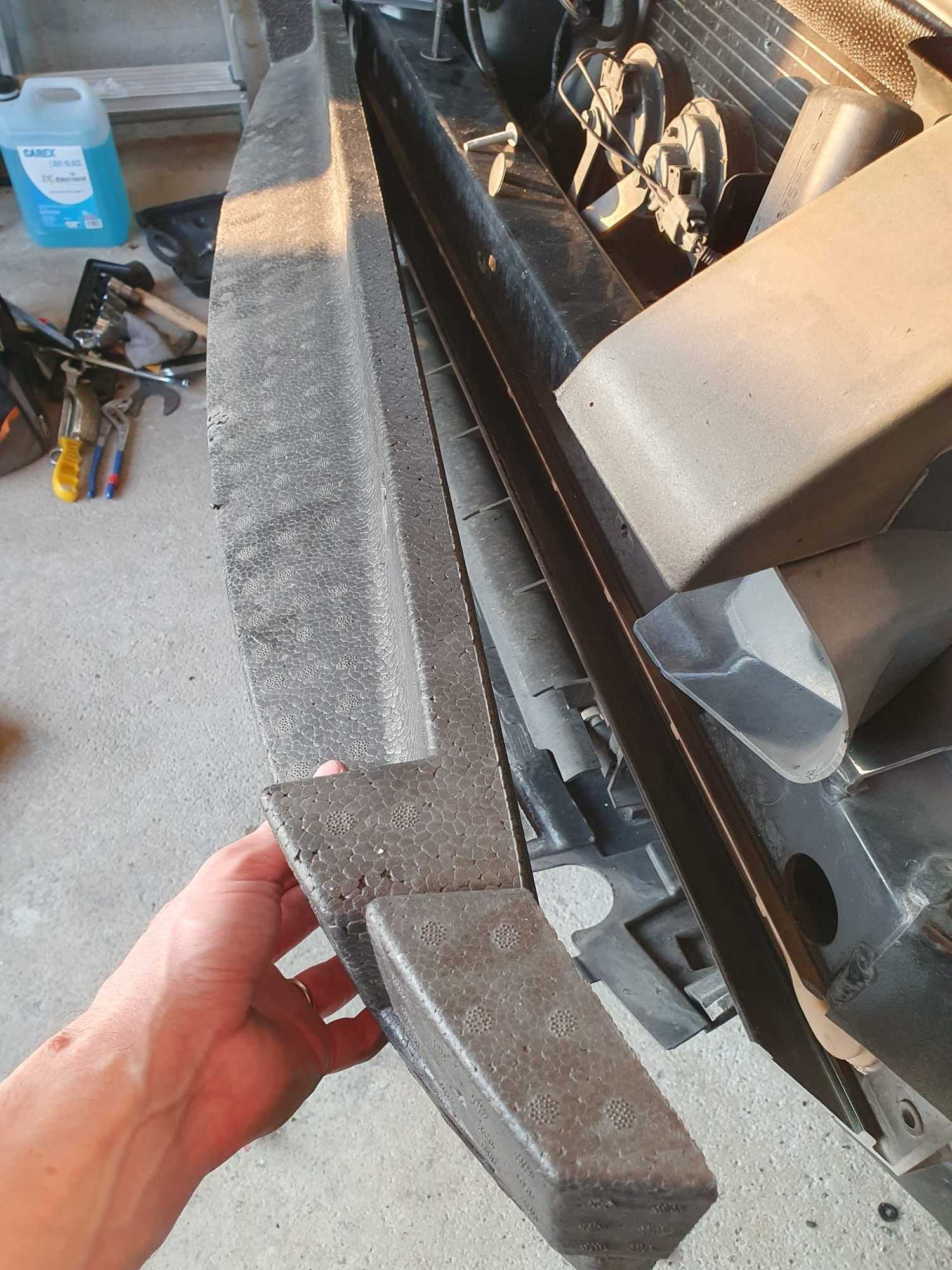

Not today, but my major DIY this year was replacing the pedestrian crash sensors.
No way of doing it without removing the front bumper.

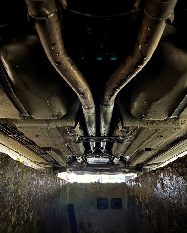

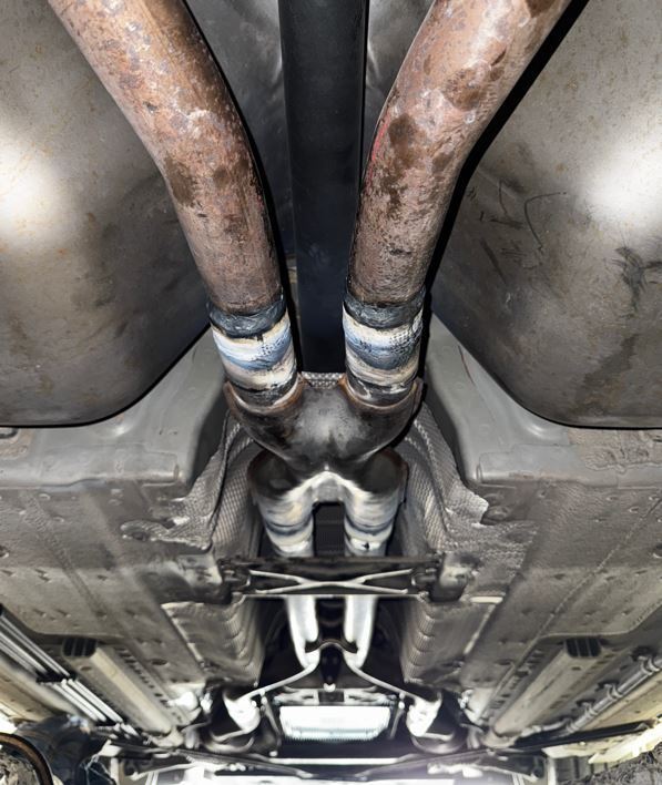

I already had an XKR backbox on my naturally aspirated 4.2 XK, but this weekend I decided to swap the middle resonator for an X-pipe.
Here is the result:
Old Feb 19, 2025 | 01:10 AM
  #2494
neven.gordic's Avatar
Joined: Mar 2024
Posts: 66
Likes: 57
From: Abu Dhabi
The sound I got with the X-pipe wasn’t to my liking at all.
The growl at low RPM completely disappeared, and while it sounded good at high RPM, it lacked depth. So, I went back to the garage and swapped the X-pipe for some straight pipes. Now, I’ve got straight pipes after the cats and the XKR backbox (with the valves, of course, disconnected and always open). No drone, not crazy loud, just perfect.
I think I’ve got the best-sounding 4.2 XK out there!

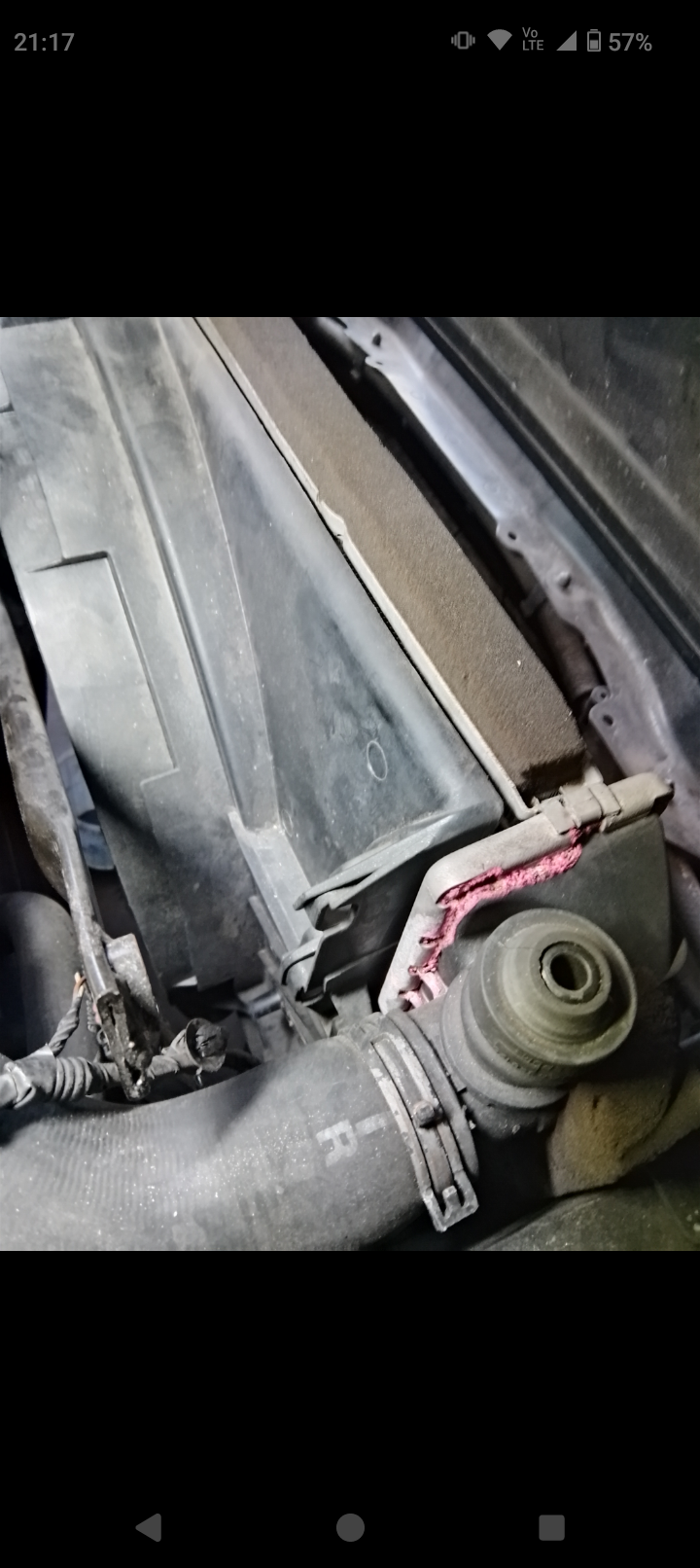

Nasty spilt located at the top of the radiator leaking the whole way down
The culprit (top of radiator split)
Finally got around to replacing the radiator
