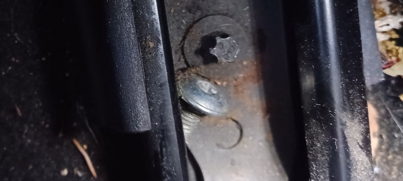

Recently found that drivers' seat wouldn't retract back (legroom) to accommodate a taller driver. SDD calibration didn't resolve the situation. Looking for possible obstructions, found a screw (probably from something inside the seat) wedged in the track, restricting rearward movement. Pried out screw, ran SDD seat calibration again, and all well. Do not fear SDD, but respect it.

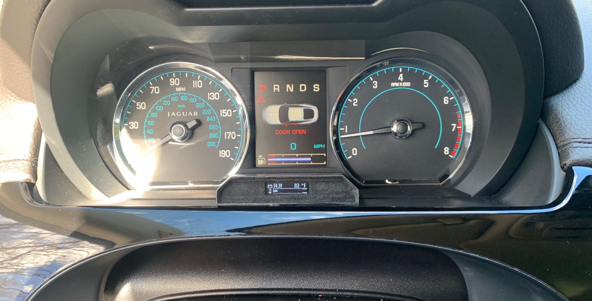

Default Coolant Temperature Gauge
I used a Chinese Obd2 gauge under the dash for a year and I then found a small enough Arduino screen to fit it on the cluster in a custom pod.
This configuration ended up too small for my vision and I worked on a version with larger digits. If anyone wants to do it, I can share Arduino parts, schematics, code and 3d STL
Video: https://share.icloud.com/photos/0fcR...UimKlwDg1Qhx6A
This project became obsolete a week later, since I installed mr12volt CarPlay and have a bt Obd2 sending the data to carscanner app. With a small iOS automation starts & works on the background with set earlier temperature or voltage audible alerts.

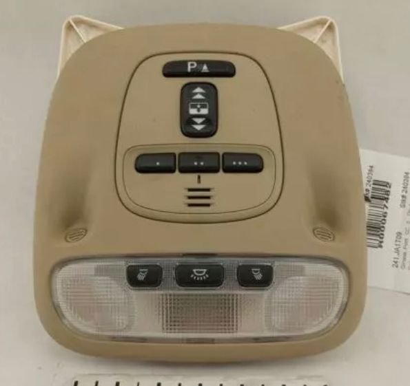

My overhead console needed help. Two of the Homelink buttons were broken and hanging down…still worked, but felt very fragile. I had been searching for a replacement…most on eBay were for a coupe and I have a convertible, and the suitable ones were $500.00…finally saw one from a breaker in Wisconsin that was the right one, pics looked good and priced at $125.00 OBO. We agreed on $85.00 shipped, it arrived yesterday and it was an easy plug and play. Lights work, parking sensors work, convertible top switch works and all Homelink buttons are perfect and work too! Made my day!
