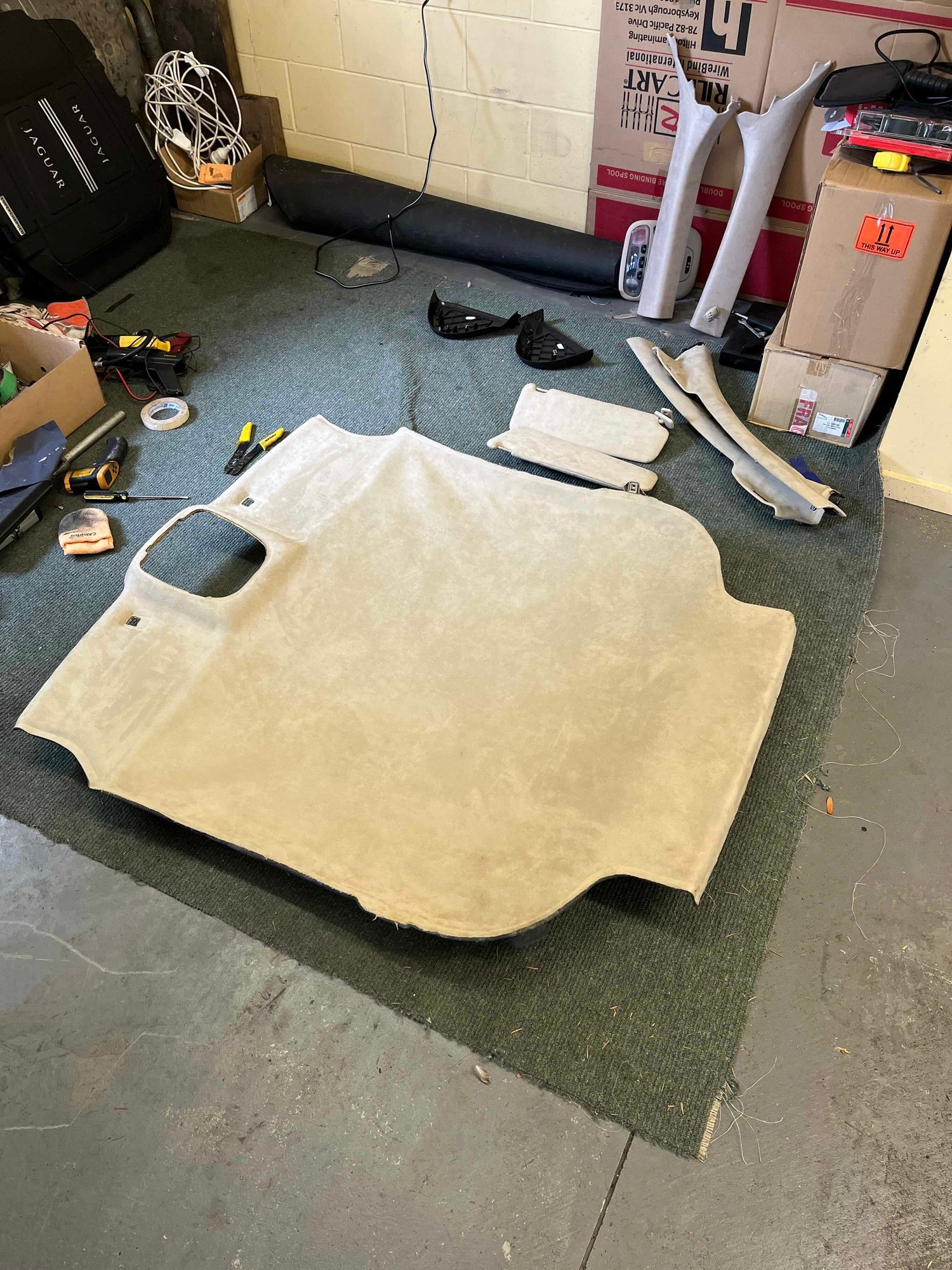

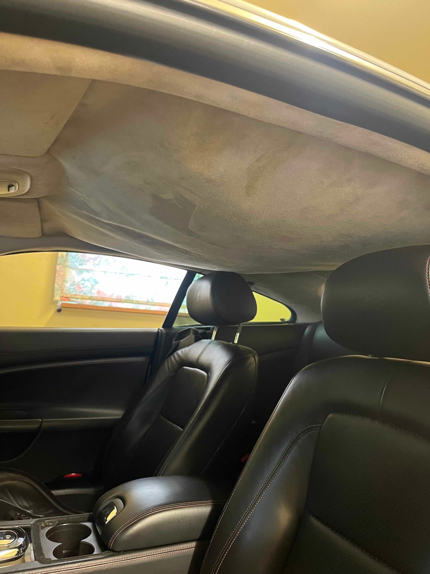

I went to visit my Jag today, hopped in and found the headliner touching my head!! I laughed out loud. I think unlike some of you in the US who had the cold snap and leaking gaskets, the humidity in NZ just killed the headliner! Took me an hour (being careful!) to remove the trims from the car. Mainly all clips and a few screws for the vanity mirrors and the jacket hooks etc.
Going to take it to an upholsterer and see what the damage is. After that it's down to the wheel shop to get my wheels refurbished.

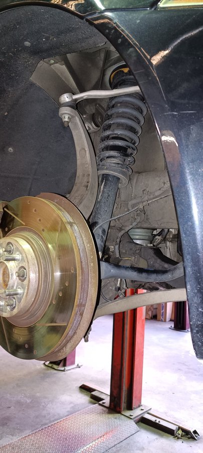

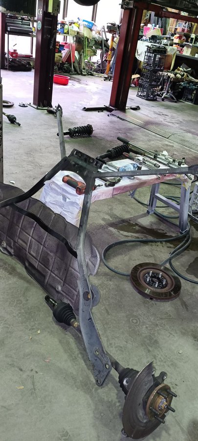

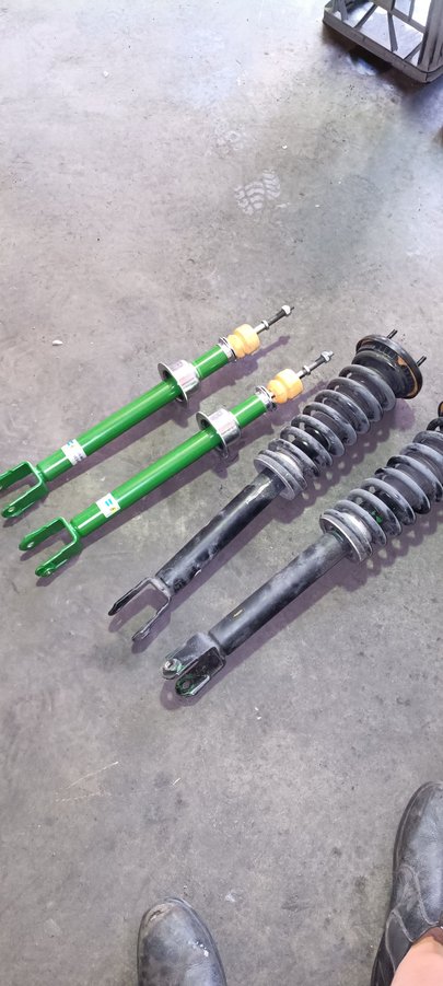

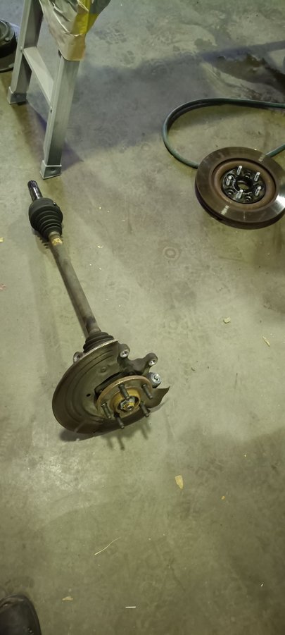

Started the process of swapping out the diff and struts

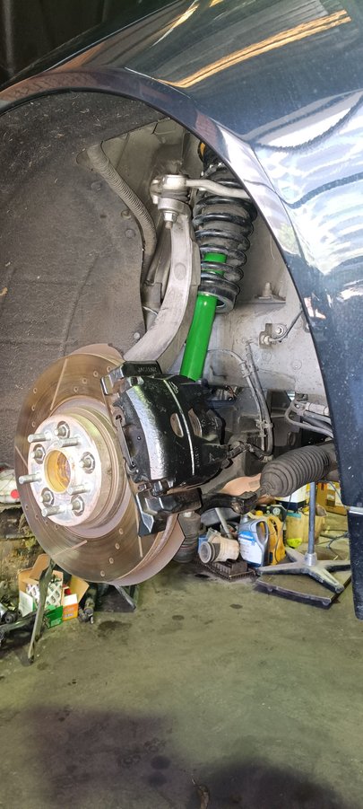

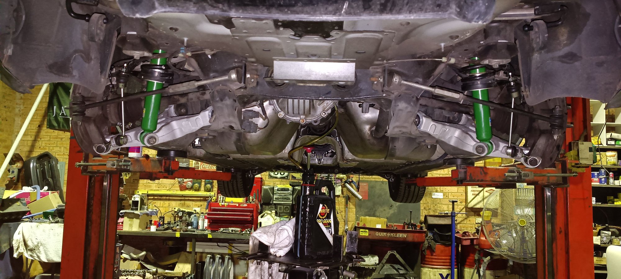

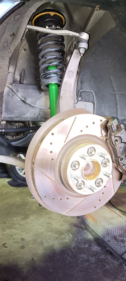

Managed to finish up the fronts today
Are those XKR struts? Look skinnier than OEM.
Old Feb 22, 2026 | 12:44 AM
  #2670
steve_k_xk's Avatar
Joined: Jun 2015
Posts: 3,005
Likes: 1,675
From: Sydney, Australia
You're correct ! they arent CATs hence why the body is thinner.
They are Bilstein B4 sports suspension they also make a comfort shock which comes in black & are oem on s-type sports and xf sports (w/o CATs)
A good alternative for anyone looking to elimanate the CATs system without sacrificing ride quality

Which diff did you put in @steve_k_xk ? Looks like the upgraded style. Different ratio? Been there and done that is why I ask.
Old Feb 22, 2026 | 03:04 PM
  #2672
steve_k_xk's Avatar
Joined: Jun 2015
Posts: 3,005
Likes: 1,675
It's 3.58 ratio from a 2002-2006 Thunderbird. I replaced all 4 bearings new seals and set the pinnon preload with the crush sleeve
Will there be ay warning lights that the CAT system is not working??
Old Feb 24, 2026 | 02:51 AM
  #2674
steve_k_xk's Avatar
Joined: Jun 2015
Posts: 3,005
Likes: 1,675
As per Jahummer insight (he's running bc racing coilovers) if you pull fuse f14 in left hand foot-well no codes will be thrown on the dash .
Finally put down some more km's on the B4's and I'm thinking my old shocks must have permanently defaulted to bone - jarring mode ...I'm extremely impressed with the new shocks it's exactly the ride quality I was chasing

It all comes down to your driving style if you want it more relaxed go the comfort shocks.
Including postage I was all in around 900aud
These are the sports shocks I went -
bilstein 24067447 - fronts (green)
bilstein 24067454 - rears (green)
