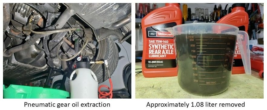

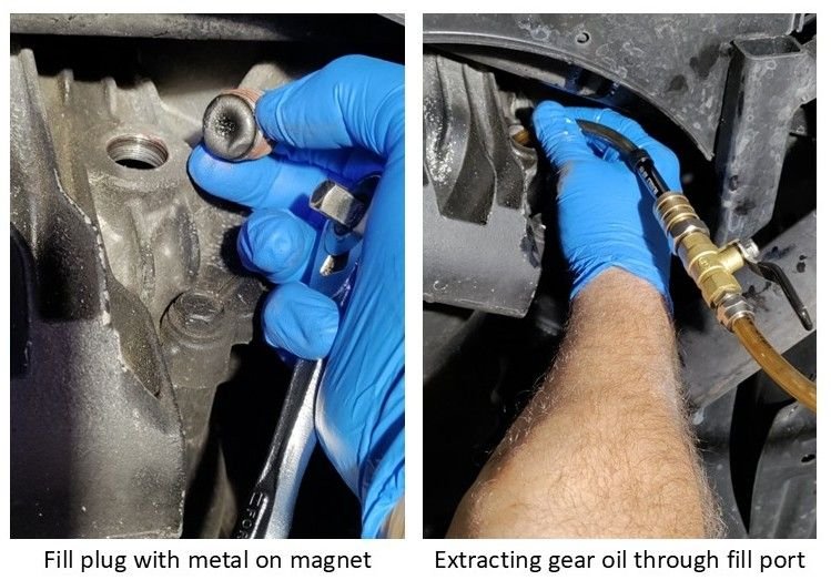

Default Differential Gear Oil Change
With the weather being lousy right now, I decided to change the rear differential gear oil. At 48,665 miles, there was a fair amount of metal on the magnet so I'm guessing this had not been done before by previous owners. Unfortunately, my differential is the style without a drain plug so I extracted the old gear oil pneumatically. After about 30 minutes of "vacuuming", I got almost 1.1 liter out. Thoroughly cleaned up the fill plug and refilled the differential with Motorcraft® SAE 75W-140 Synthetic Rear Axle Lubricant (specification WSL-M2C192-A and GL-5).

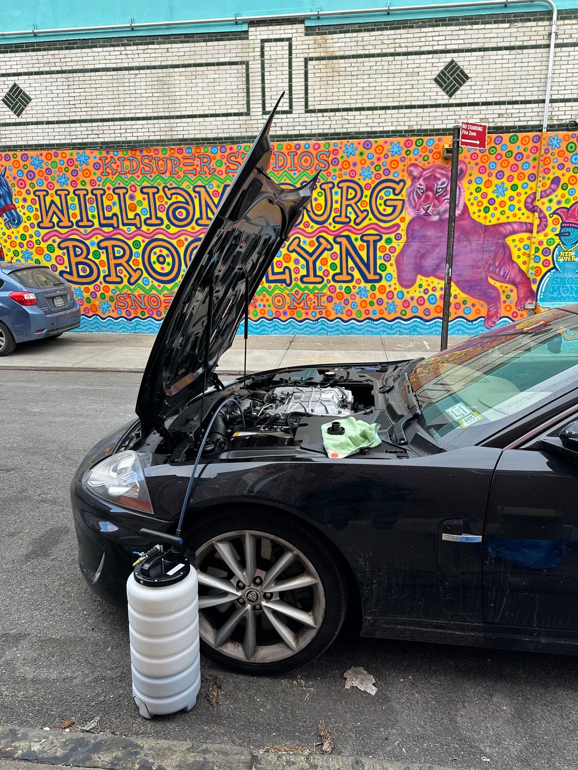

Oil change with an Amazon oil extractor. Took 5 mins to extract the oil. I’m estimating it left less than a liter in the sump. Love it.
