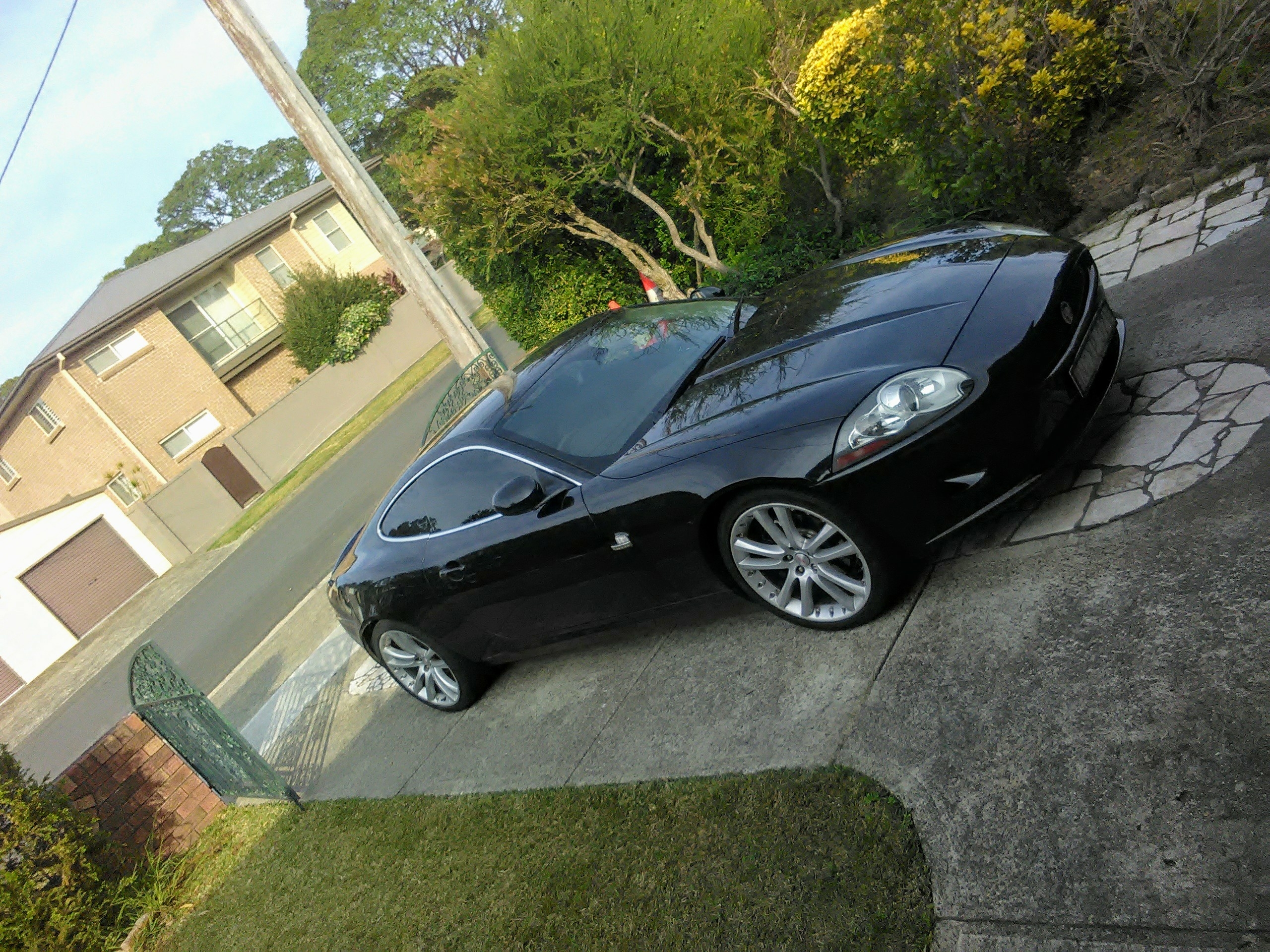

Installed brand new faulty shocks
Attached Thumbnails What did you do to your X150 today?-img-20180911-wa0041.jpeg   What did you do to your X150 today?-img-20180911-wa0029.jpeg   What did you do to your X150 today?-img-20180911-wa0031.jpeg
Old Sep 11, 2018 | 05:25 AM
  #357
steve_k_xk's Avatar
Joined: Jun 2015
Posts: 3,005
Likes: 1,675
From: Sydney, Australia
Rule 101 check your parts first before installing

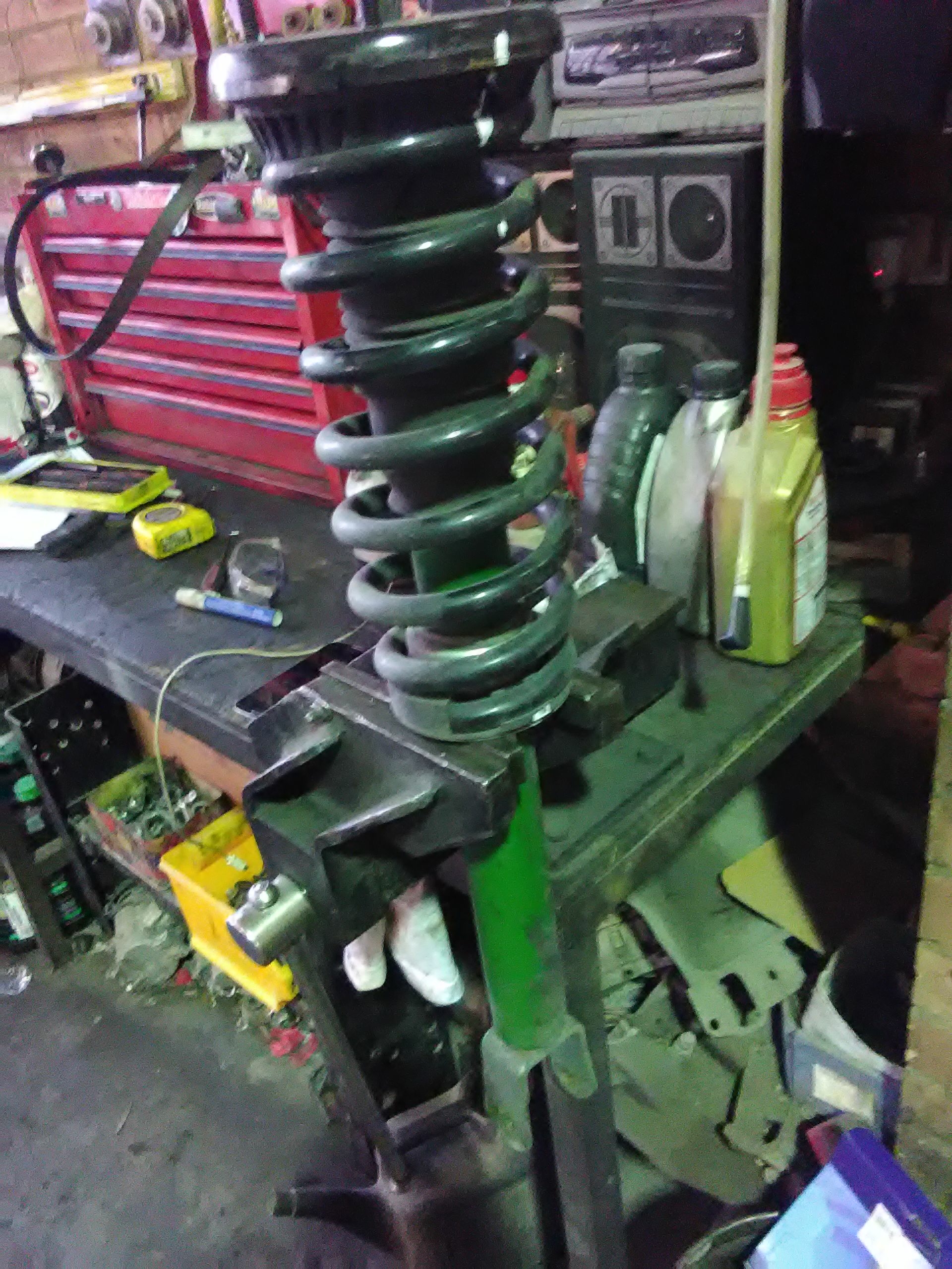

That stinks... Care to fill us in with some details? What lead you to changing them? Where did you source the new shocks? Whats wrong with new shocks? Are they difficult to change? ect.
Old Sep 11, 2018 | 08:52 AM
  #359
kj07xk's Avatar
Joined: Jan 2015
Posts: 5,314
Likes: 2,588
Yes, do tell. What’s the problem?
I see that you’ve got both XK (black) and XKR (green) shocks, and maybe (could be photo angle) the shaft out of the green shock appears a tad shorter. But I had that too, when I replaced my 2007 XK front shocks, with those intended for a 2010-2011 XK (by the part numbers anyway).
Had to squeeze the springs a bit further to get the nut on, but got it done. Just think the shaft on the old shocks was loosy-goosy, so it stuck out farther.
Old Sep 11, 2018 | 08:55 AM
  #360
steve_k_xk's Avatar
Joined: Jun 2015
Posts: 3,005
Likes: 1,675
The original XK springs are too soft so at the time I decide to purchase a set of 20mm lowered eibach springs for the simple fact of improved handling . ( The eibach were lower than original these were straight forward to fit. )
Fast forward to the present ..as the front was just a tad too low and I already had a faulty CATs front shock I decided to replace the front shocks , whilst replacing I would use the xkr spring as these are stiffer then the Xk and looks to sit a tad lower than the standard xk
In terms of compressing the xkr spring yes very very difficult alot harder to compress then the xk, xkrs and 20mm lowered eibach spring. I actually ended up using 4 coil spring compressors .
At this stage I'm leaving the lowered springs in the rear as the combination (eibach rear,xkr front) actually looks perfect now , I've contacted the seller and he is sending replacement shock to me.
