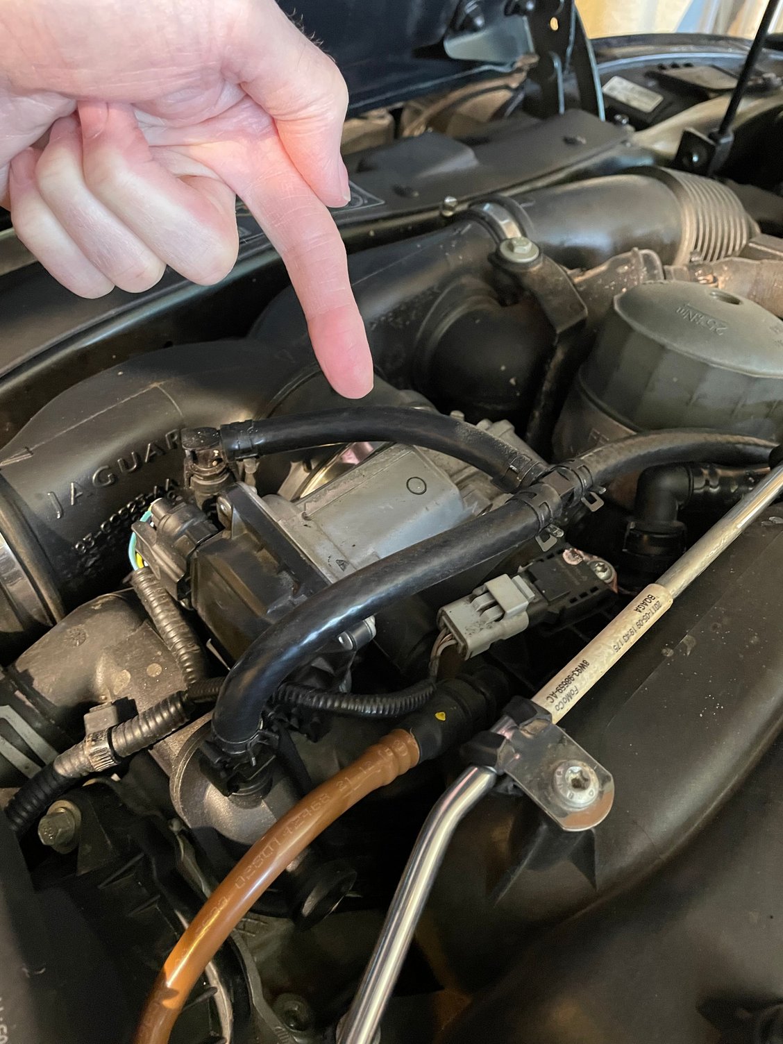

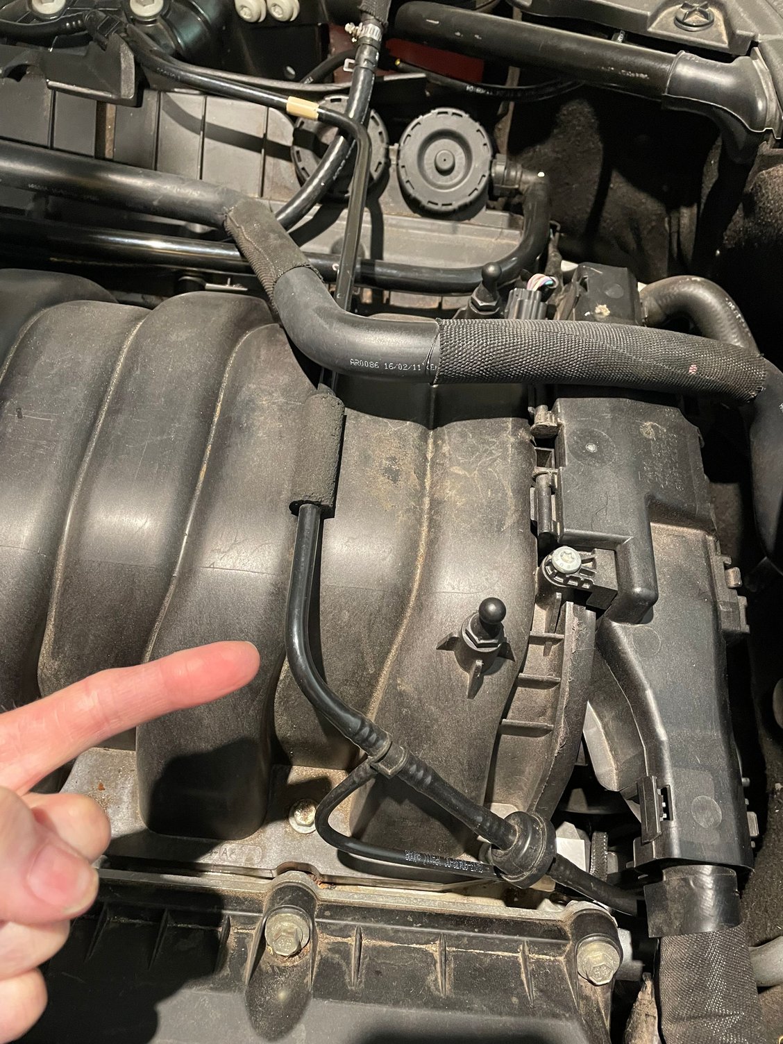

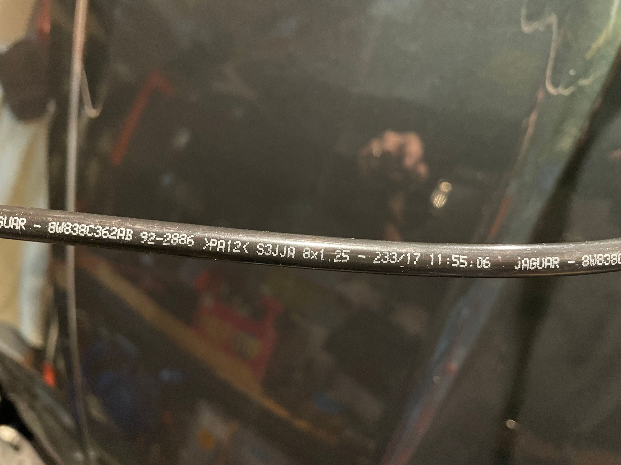

The thing I’d look at first is the black PA-12 tubing that runs around the engine. It gets brittle with age and heat.
There’s a production date code printed on it. If it’s over 5 years old, I’d replace it. The one that feeds your throttle body gets quite hit.
