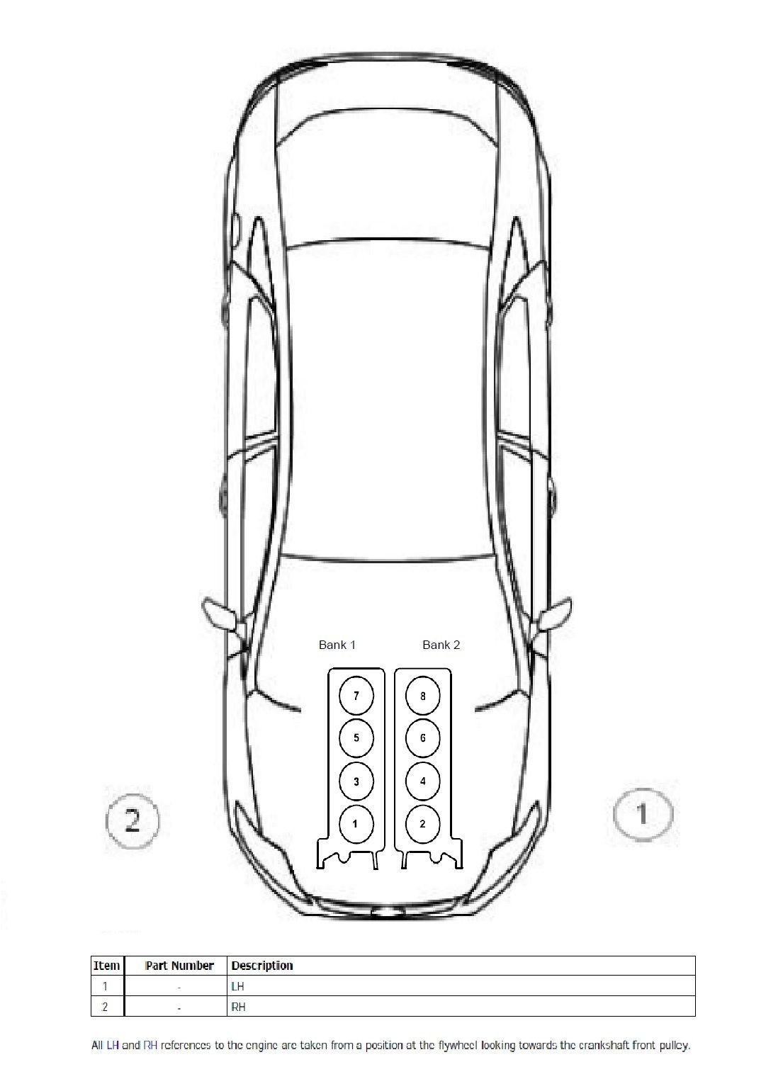

What side is bank 2 when sitting on car

Default What side is bank 2 when sitting on car
left or right, 2007 , thx

Its the left drivers side (american car) for 5.0L XK's
I'd assume its the same for 4.2L
Hello Canadacat
Attached is a multi-model reference of car specifications. Engine bank/cylinder numbering starts around page 78. Tarokyama is correct that bank 2 is the left side.
Regards, Mike

Jaguar seem reluctant to release a simple diagram of body and engine so here goes:
