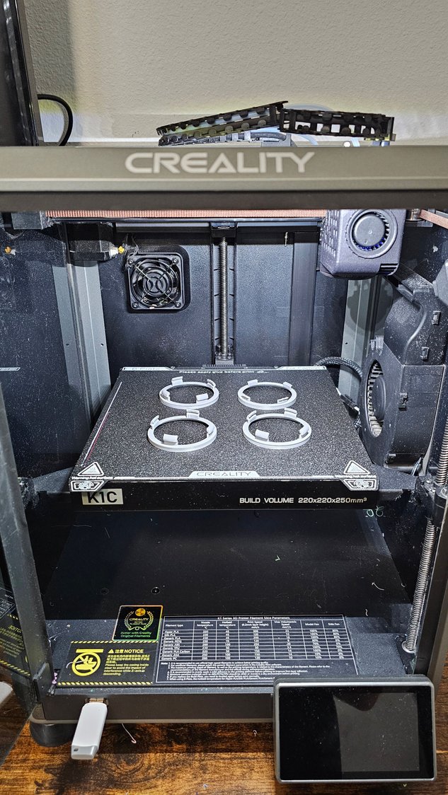

If you know anyone that has a 3D printer, I found this post on Thingyverse which claims to solve this issue...
https://www.thingiverse.com/thing:3549286
I haven't tried the print yet (plan to this weekend) so I can't vouch for it, but it's relatively simple, so I expect it will work. Also, the print is super simple compared to most 3D print jobs.

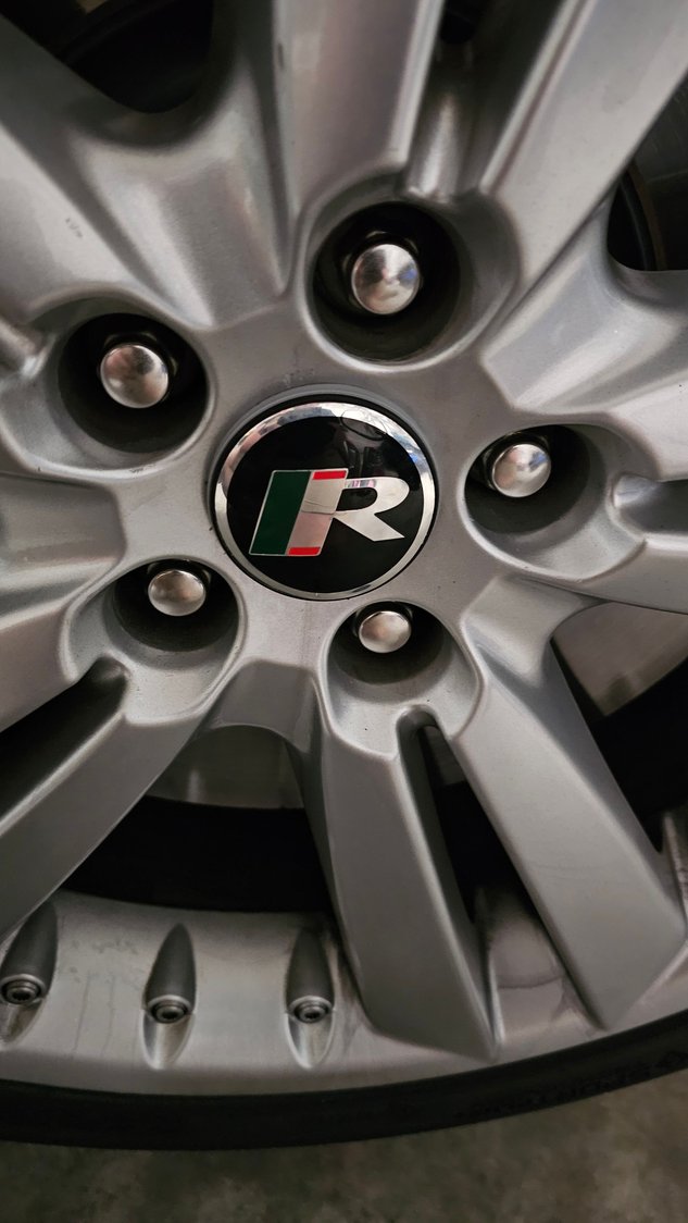

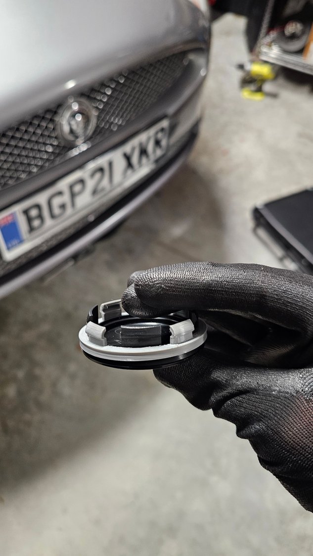

I was able to get these printed on the 3D printer this weekend. They work great. Perfect fit and the lose wheel caps are no longer lose at all.
3D adapters took less than 30 minutes to print
Adapters easily snap on the wheel caps
Wheel caps with 3D printed adapters
