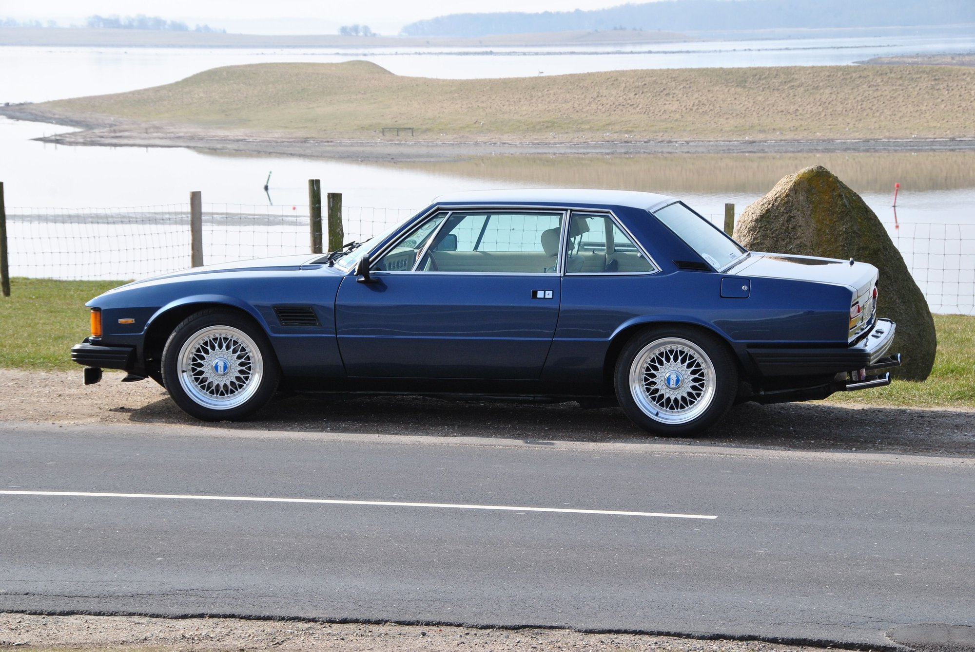

I feel for your paint mark problem. Don't kill anybody.
I had a DeTomaso Longchamp painted. First windshield and rear window out. Then paint. Back to the window guy, windows in. The day after, when assembling, I noticed small marks on rear lid, white, meaning deep. Found more on the roof, front and back. Short story, the young guys working there installing the glass, had placed their tools on the roof and rear lid and front hood without any protection! A full respray at the expense of the window company, and no more work for that company. The level of stupidity is amazing.
Hop your's buffs out.
