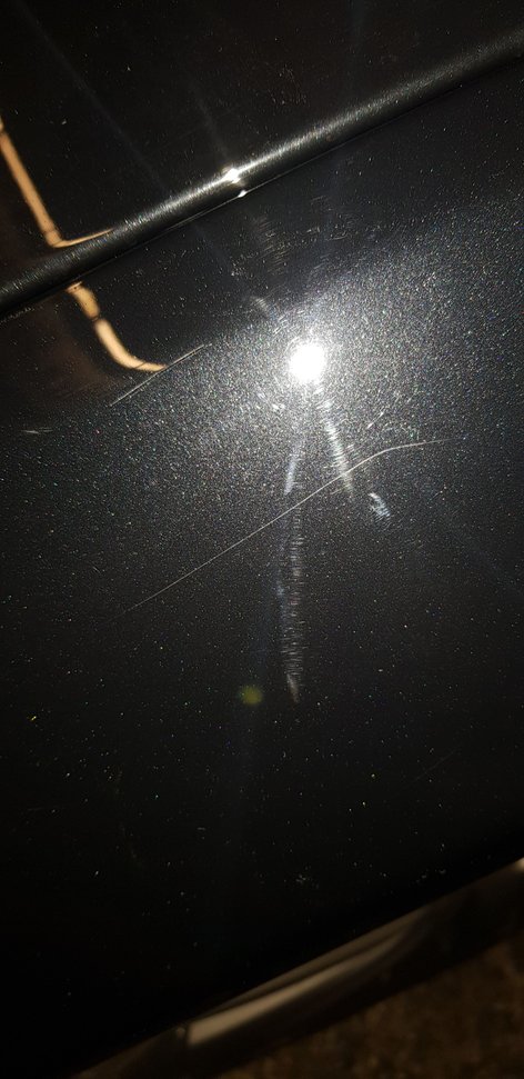

Got out of the car last night and she was fine... Started the car this morning and a loud whirring noise came from the front end of the engine...
Took my car to a garage that I've used in the past and they seem to think it's the water pump? I'm sceptical as I would have thought it would be progressive.?
To top it off... I walked the shop manager round the car and pointed out the tree marks Mark's on the paintwork... I did that because I was paranoid that they wouldn't use protection on the wings when working on the car...
Low and behold!!!!
Totally visible totally in my face!!!! I'm gutted as I'm so very careful with my car! It's meant to be going in for detailling and a ceramic coating on Monday but now I might need to get the wing painted!
And I'm not even convinced I have a water pump issue...
