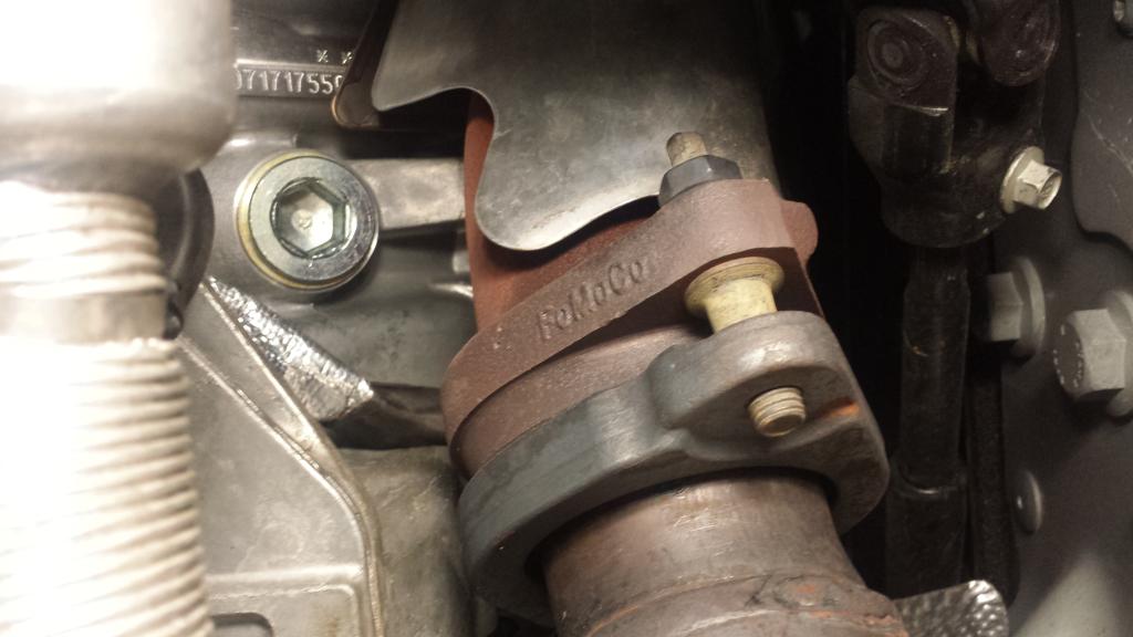

So who really builds the 5.0 engines? Ive got my '10 up on the lift doing some work and also some inspection, and I see FoMoCo stamped more than I do Jaguar! (yes, I know the relationship and the whole story, yada yada)
But my real question is, and maybe I havent searched enough, but isnt it a little too fishy that its a 5.0L that says Ford all over it? So, what aftermarket Ford parts has anyone found to work on the '10 and up XKR engine/transmissions?

Anywho, the purpose of this thread was really to find out if anyone has had any successful aftermarket, or even OEM parts that work on the Jag whether it be for upgrade or repair/replacement.

The engines are made in the Ford Bridgend engine plant, in a separate room, for JLR.
So "made by Ford" but "engineered by Jaguar" but it's not actually a Ford engine and you won't find any aftermarket parts to suit.
Lots of parts are sourced in the Ford supply chain, and will be for a while yet.
My Land Rover has a Volvo engine, and the ECU file is written by Volvo, it was part of the family at that time. Don't let it get to you...
