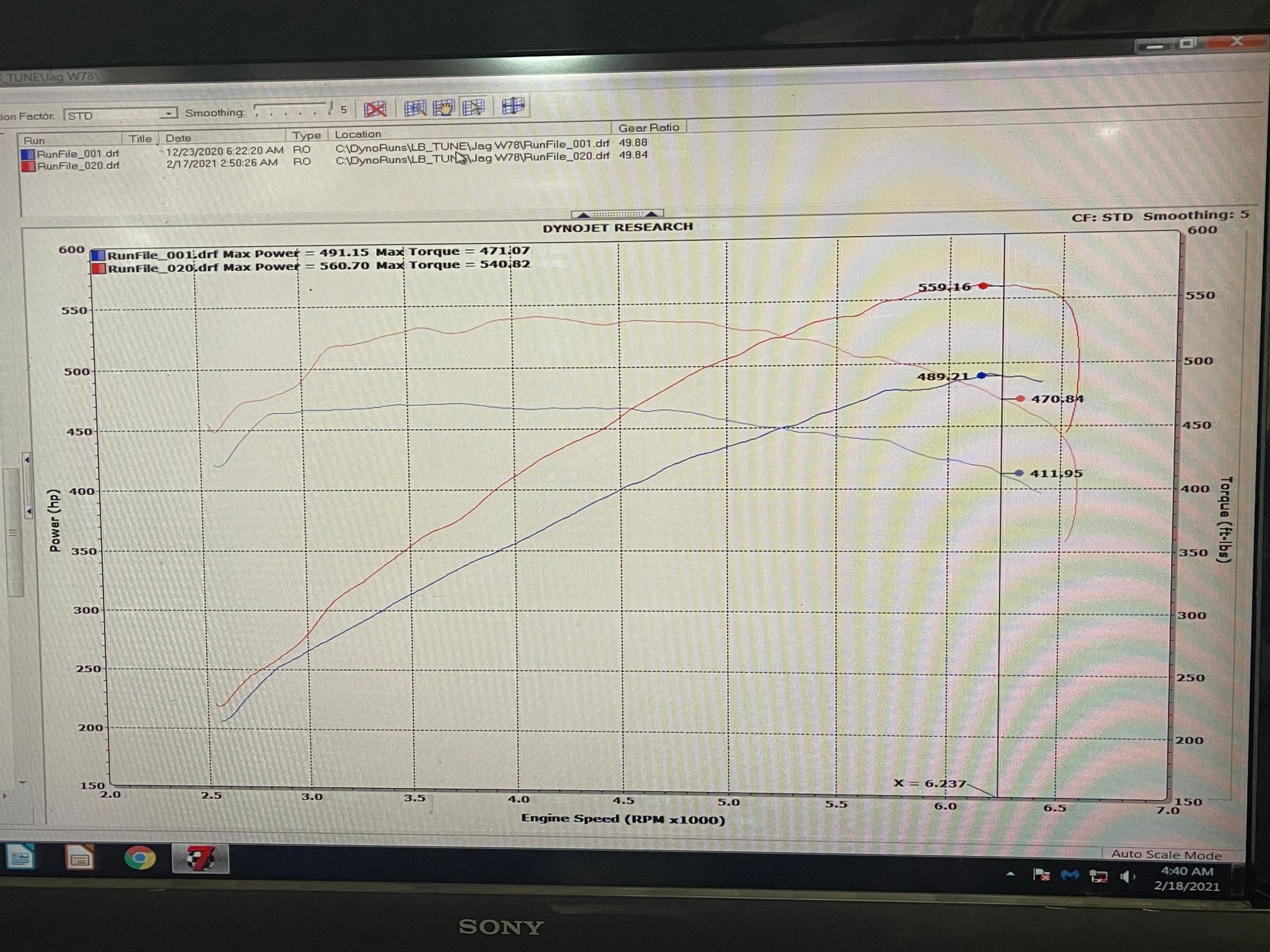

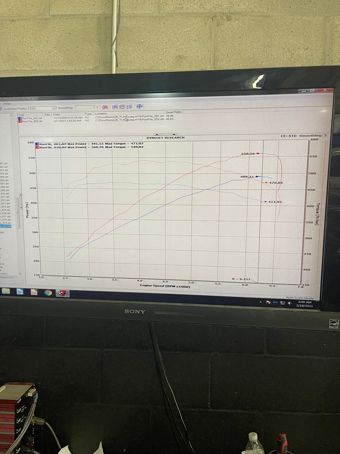

Jimbo2898's Avatar
Joined: Jul 2019
Posts: 6
From: Brandon FL
Default Who Expectations
Ok so all got done. New lower pulley, cold spark plugs, water meth kit installed, oil catch cans and nitto 555r2.
Dynos in picture. From 491 to 560 whp. Close to the 600 benchmark.
So with this stuff done.
wThoughts on 1/4 mile runs. Can I do 11 seconds with this or my still dreaming.
aAlsi, what would be best launch set up in order to maybe achieve this?
Comments appreciated.
Thanks
Jimbo
Old Mar 29, 2021 | 01:54 AM
u102768's Avatar
Joined: Jan 2010
Posts: 2,941
Likes: 1,511
From: New Zealand
The biggest issue with my two XKR's has always been traction but, with your drag radials and the mods done, low to mid 11s should be achievable.
Let us know how you get on!
Old Mar 29, 2021 | 08:48 AM
htrdlncn's Avatar
Joined: Sep 2019
Posts: 262
Likes: 133
From: Texas
Jimbo, i ran 12.3 bone stock,,with your additional power you should easily run 11s.
