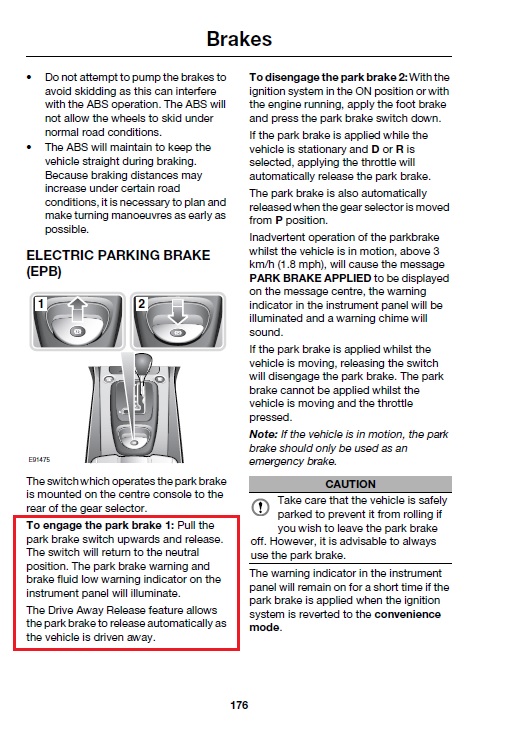

Originally Posted by ssteveb63
From what I have read, the car engages the electronic parking brake when you put it in park. .....
NO - the parking brake RELEASES automatically when you move the selector from P or drive away but it has to be ENGAGED manually.
Where did you read that?

Thanks GGG, I may have explained it wrong. Don't remember where I read that, this problem occurred a couple of months ago. I've been researching possible causes and how to fix it since then. Car still will not turn over with good battery. Error message says "cannot engage parking brake"
