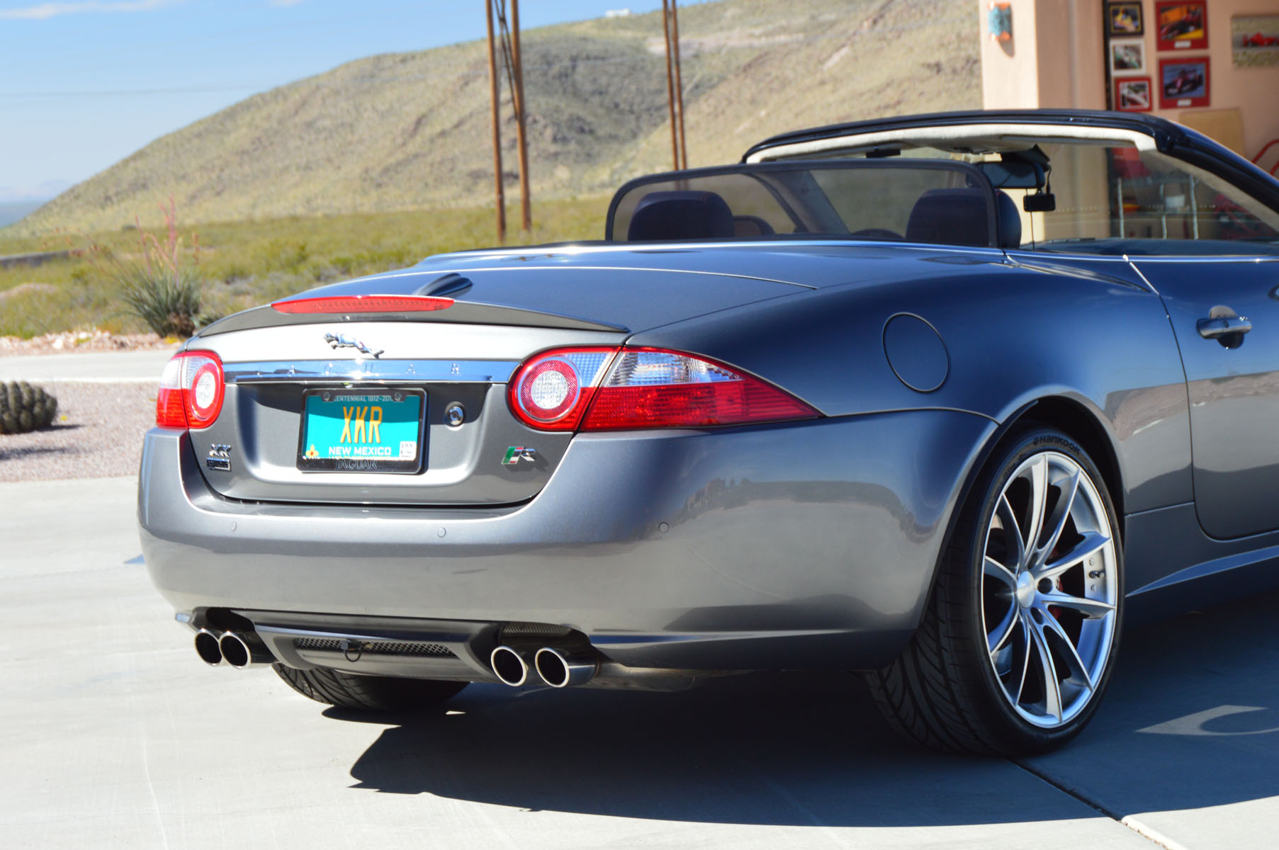

Consider the Adamesh Wind Deflector also. Shipping from the UK is within a few days.
