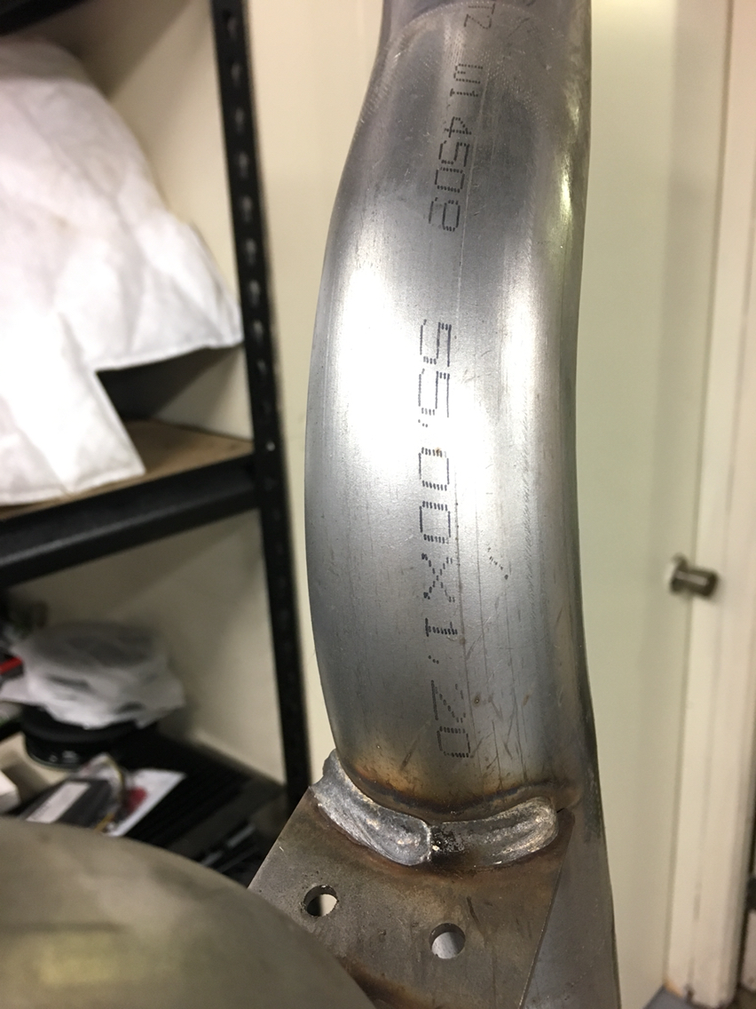

Original pipe is Metric spec. There's also the confusion about how the size is measured. Tubing measurement is typically the outside diameter, pipe is the inside. You need to allow for the material thickness as well.

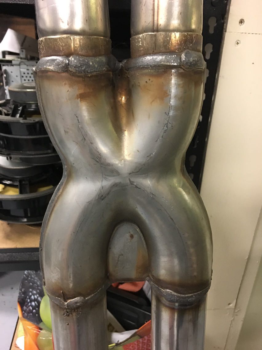

And yet what is best for these pipes, to order 2 and the master to stretch them a little, or to order 2.25 and put the original tube in the x pipe to cover. By the way I do not know the standard when doing such an intervention should the original pipe enter into the X pipe to cover it?
The picture looks like this.
