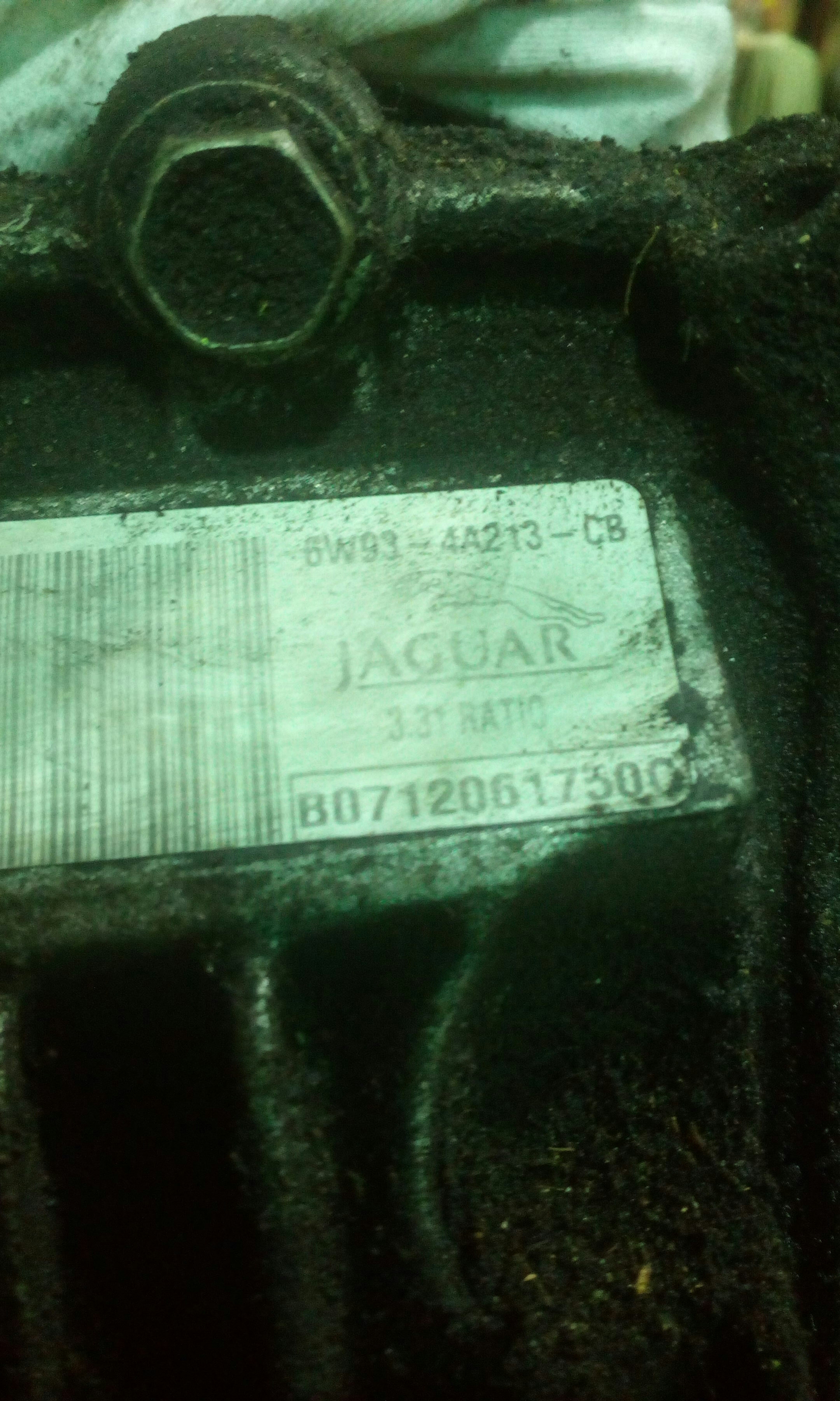

Lincoln gen 2 (3.58)

Confirmation the gen 2 (3.58) lincoln diff will work in xk/r 4.2 with 3.31.
Shifting fine no limp mode however yet to do a full power run due to a broken l/h engine mount .
The rear cover on the Lincoln diff is slightly deeper resulting in a larger capacity to hold oil.
Attached Thumbnails X150 (4.2 Xkr) differential-img-20180329-wa0007.jpeg   X150 (4.2 Xkr) differential-img-20180329-wa0005.jpeg   X150 (4.2 Xkr) differential-img-20180329-wa0009.jpeg   X150 (4.2 Xkr) differential-img_20180329_234302.jpg   X150 (4.2 Xkr) differential-img_20180329_234654.jpg
