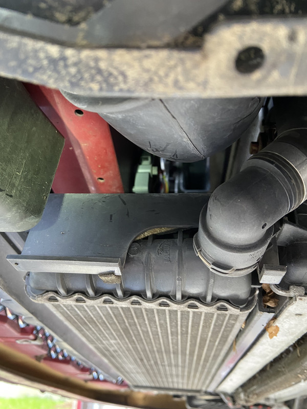

The horizontal aux radiator is in the way of accessing anything inside the bumper, including the parking sensors.

Undertray off & you're presented with this. Left sensor can be seen but not accessed, right side is hidden completely.
