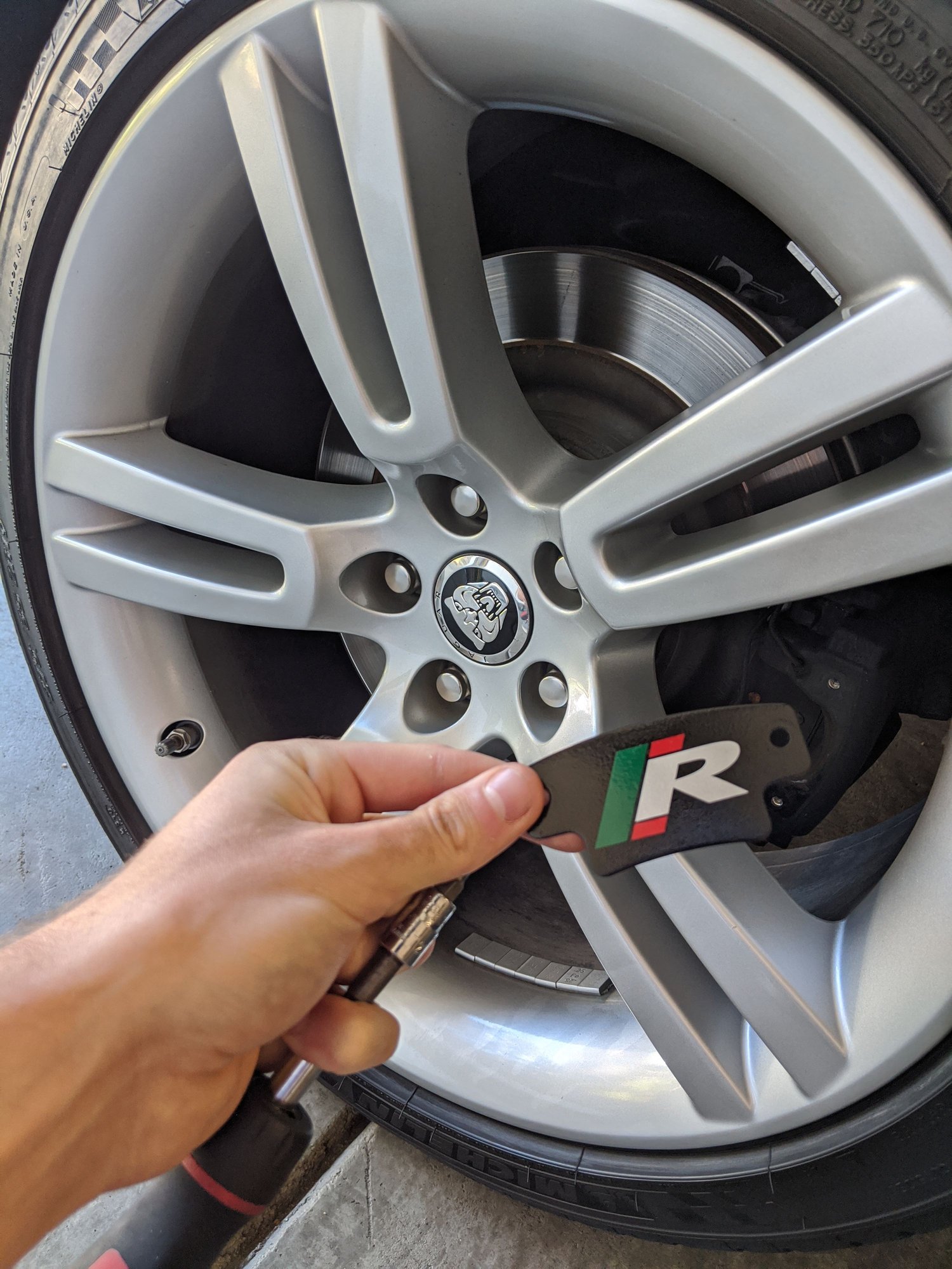

The original faded //R logo plates (rear)

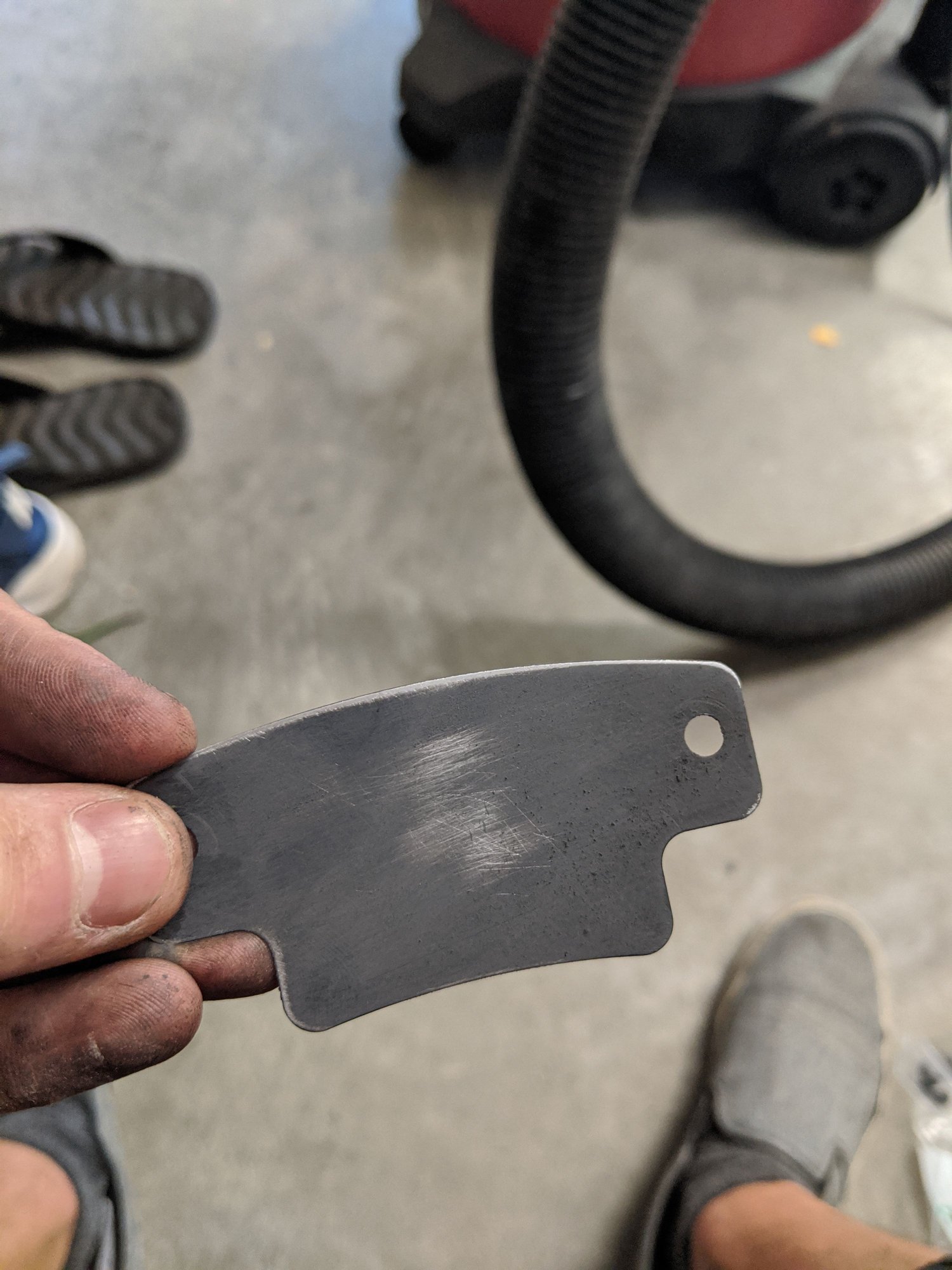

Sanded down with 150 grit followed by 320.

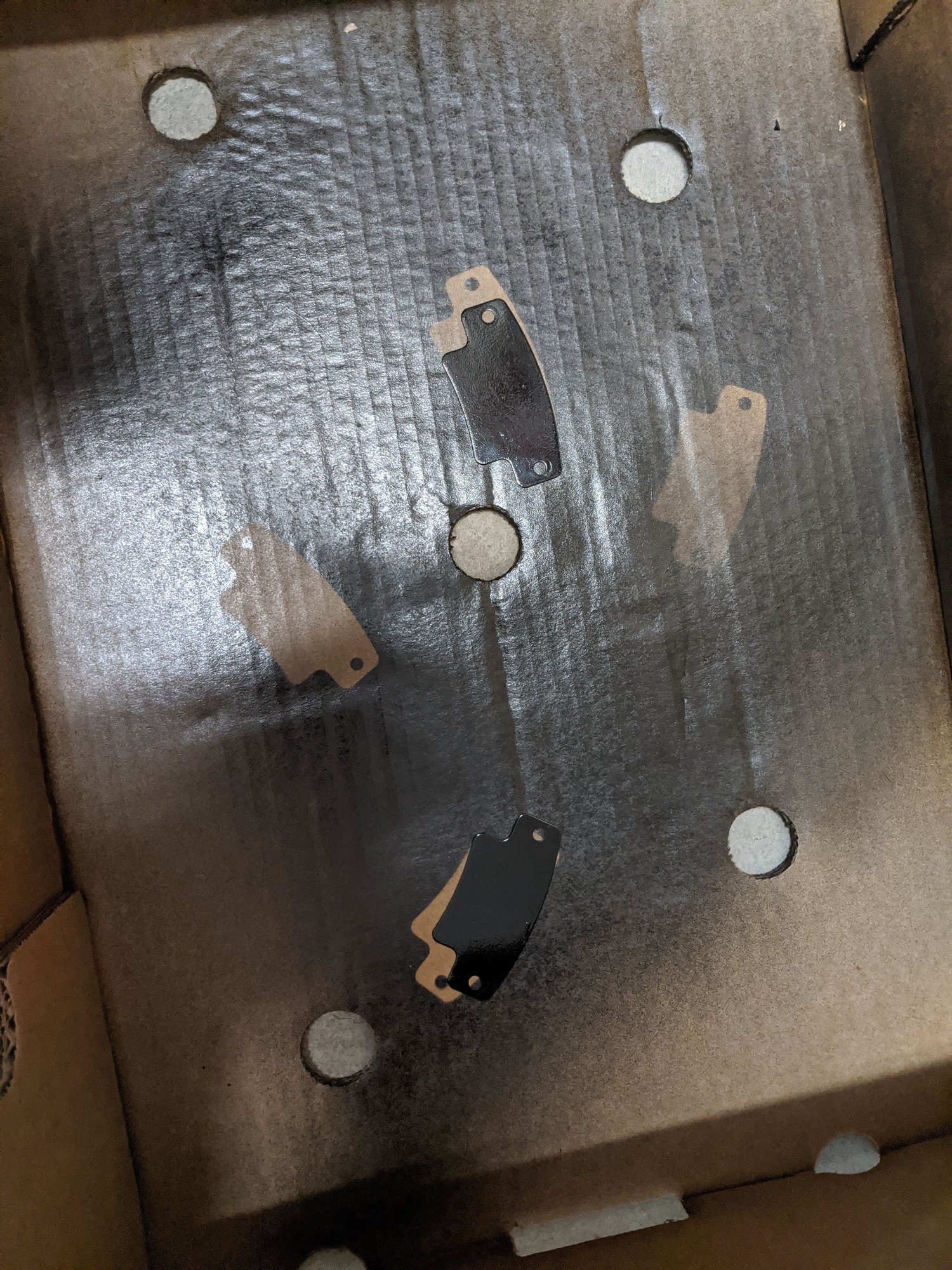

Sprayed plates with gloss black high-temp automotive spray paint. Applied 3 coats.

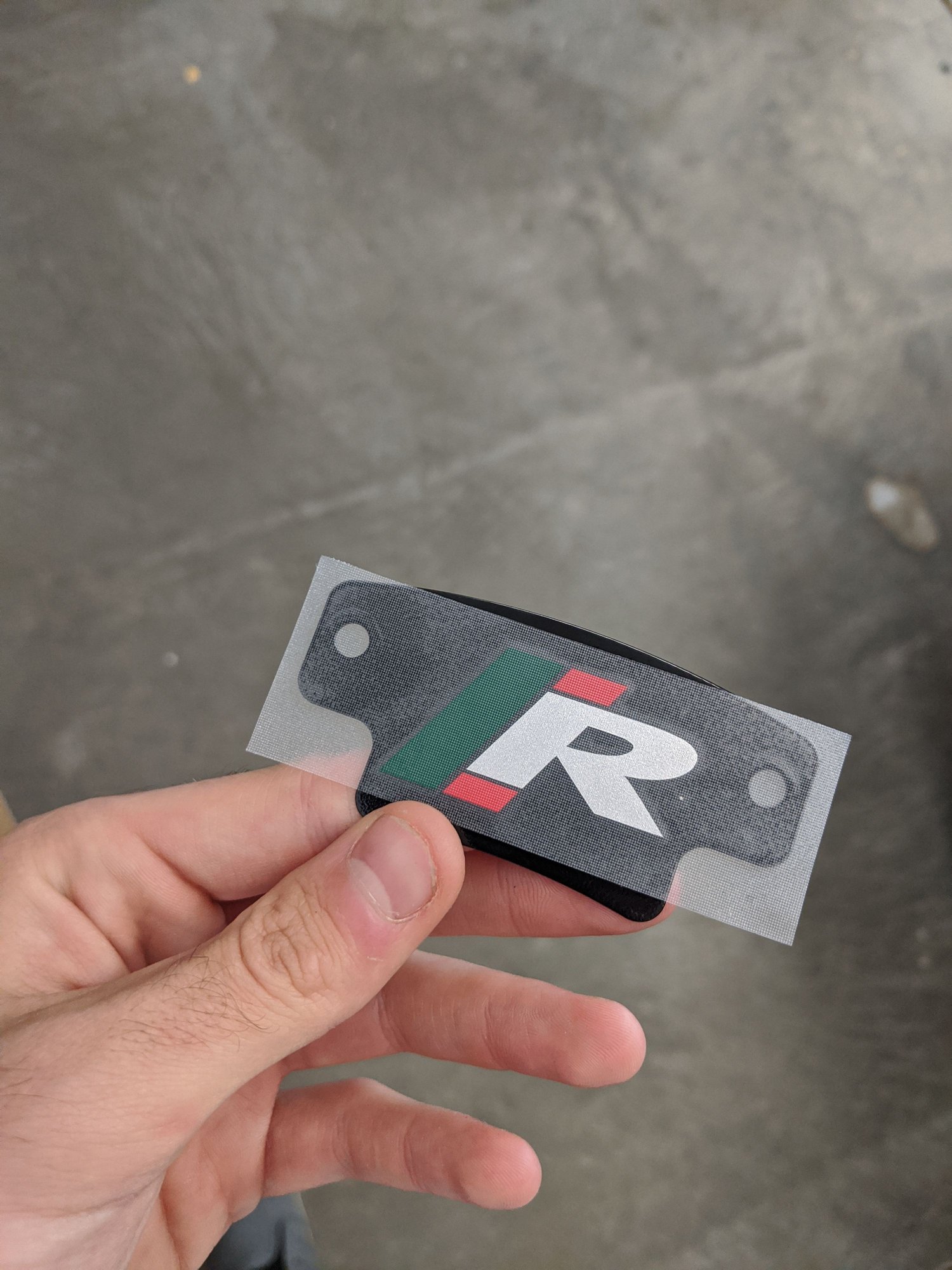

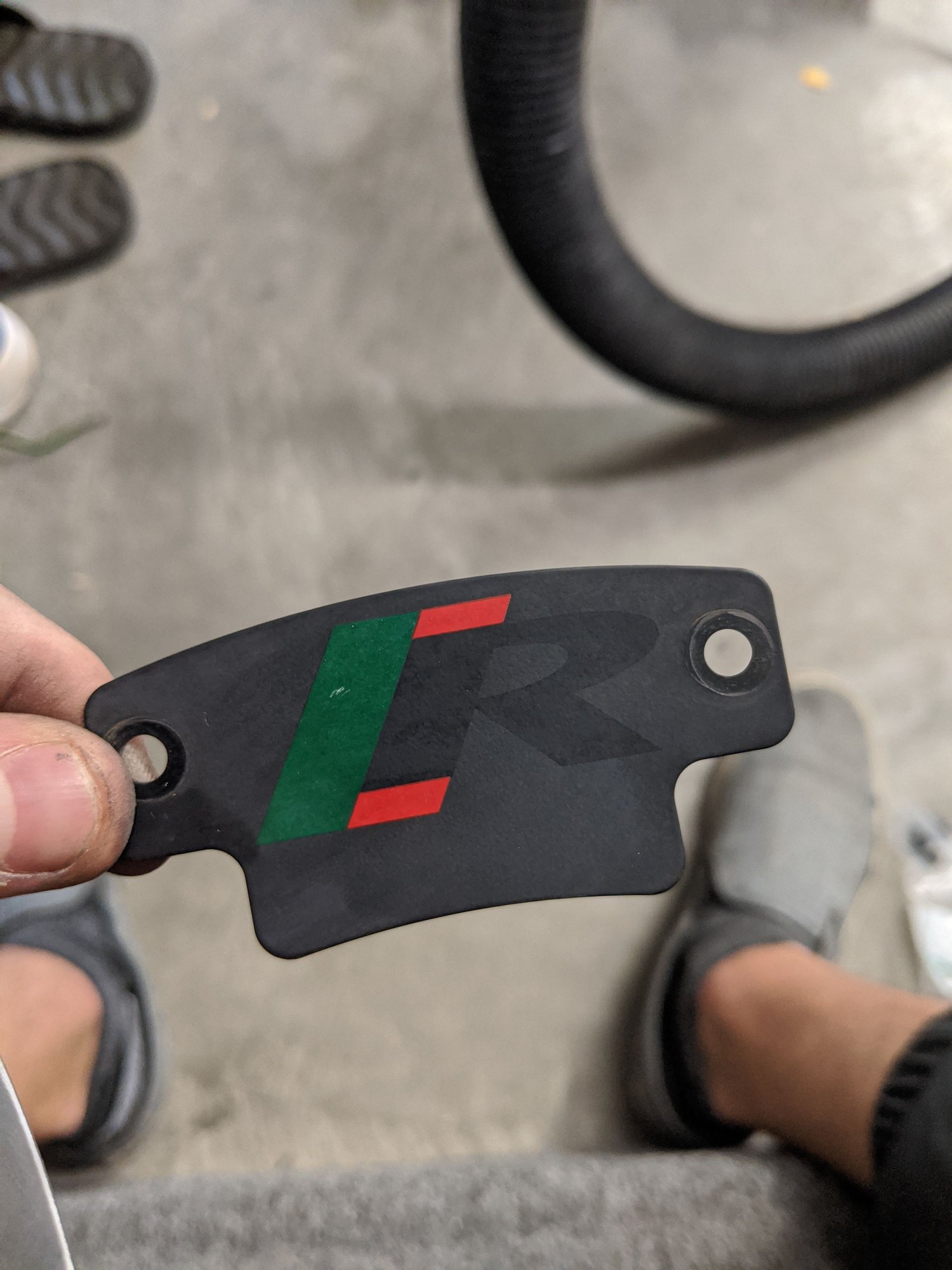

Applied high temp. vinyl //R logos. Around $25 for a set of 6. Direct message me if interested.
Final product - 1
Final product - 2
Final product - 3
For around $30 I was able to refinish all four brake caliper logo plates. Jag charges $60 or more for just one of these plates.

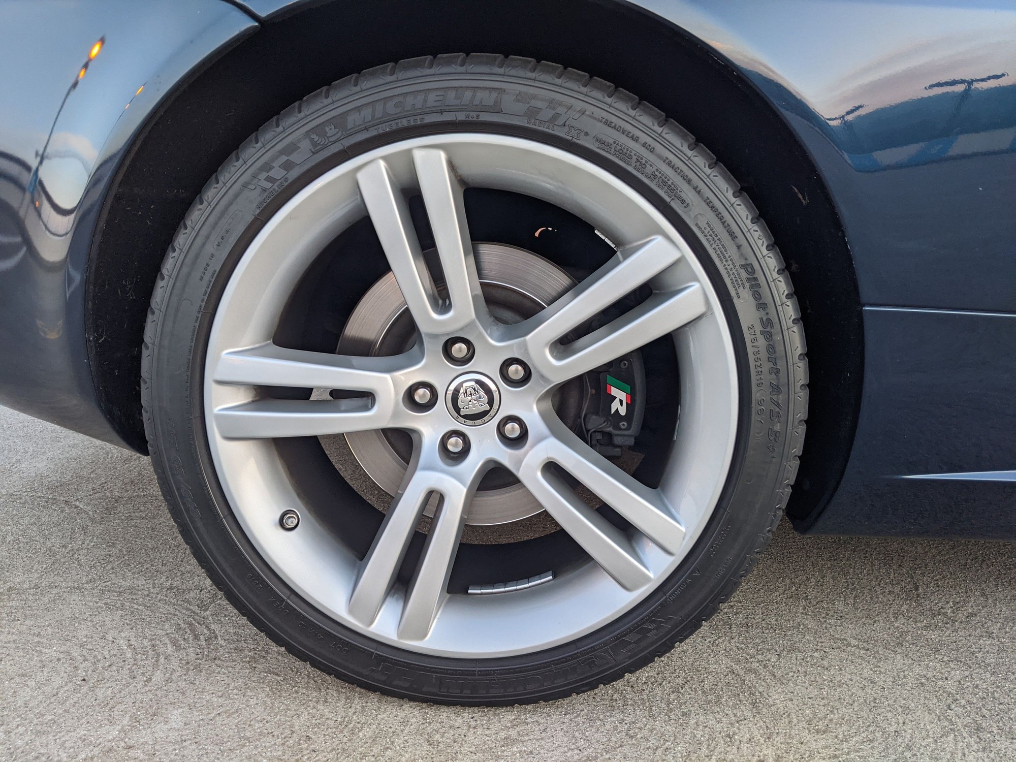

Here's the same //R logo decal on my dash.
I paid $11.99 delivered for 6, direct from the manufacturer in Serbia. Here's the link: Brake Caliper Decal. They're available in various sizes and colors.
