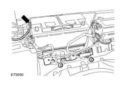

7. Disconnect Negative terminal (10mm bolt) on the left. (#1 in the photograph)
8. Disconnect Positive terminal (10mm bolt). (#2 in the photograph)
9. Pull the vent tube off, and save for the new battery.
10. Remove battery retaining plate (10mm security bolts x2) and swing aside. (#4 and #5 in the photograph)

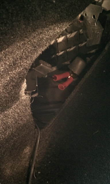

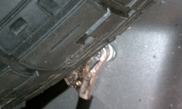

Jaguar has provided 'jump start' battery charging posts in the trunk.
The Positive one is in a compartment on the left hand side, behind a ribbed cover, as shown in two of the photos.
The Negative one is a bare stud under the trunk floor, next to the spare tire, as shown in another photo.
However, I only recommend using these terminals for jump starting or emergency battery charging.

12. Ensure the battery terminal fit snugly all the way down (they are tapered) - there's a Jaguar Factory Service Message (SSM38790) suggesting this is a common cause of failure.
13. I always put some Vaseline or grease on the terminals afterwards to prevent corrosion
14. Don't forget to plug the vent hose into the side of the new battery – the battery MUST vent externally (even AGMs).
15. Reinstall the trunk liner, etc. For the convertible, reinstall the luggage separator. Ensure it is seated correctly - there is a microswitch on the LH side of the separator that will disable the convertible top open/close system if it is not located correctly (ask me how I know this.......)

11. Battery then simply slides out, new one slides in, and reassemble.
