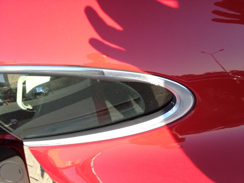

Hello!
I own a red XKR 2010.
On both sides, the oval aluminium trim round the back window are now mated.
It seems a material problem.
Is this common?

Ah you mean "matted" as in lost it's shine. I have the same with the chrome trims around the windows on my X-Type. I used a silver polishing cloth (the type used for polishing cutlery) and they were shiny again, but eventually it went dull once more.
I think it's because the trim is actually made of aluminium and it eventually oxidises. The way around this would be to polish and then coat them with some kind of wax or sealant. I haven't bothered with it yet...

It's not a warranty issue -- it's just a cleaning issue. Just like polishing the tailpipes... just clean and shine them.

WD-40 with a clean rag will do the trick very nicely, just discovered!

On the driver side of my car the "chrome" trim around the windows has had a blotchy look like water stains for two years. I just tried the WD 40 and it worked!!! I'll see what it looks like in the morning but right now it looks new! WOW!
