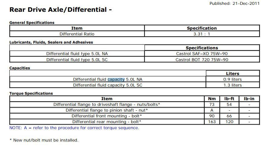

new Jr member here and trying to navigate my way around.
I have a 2012 XKR convertible and am uncertain if it has an E Diff or mechanical.
Vehicle has 100,000 KM and I want to change diff fluid
Need to know type of lubricant to use.
Tks
Ronnie

Brand doesn't mean anything, just quality and viscosity. Yes, all 2010+ XKRs have E-Diff.

Thanks so much CJ for your help.
Totally agree, quality / the correct lube is what you want for the E Diff.

For us new XK guys, what kind of differential does the XK have? Same rules apply for quantity/quality?

All except the 2010+ XKRs have an open differential. Yes.
