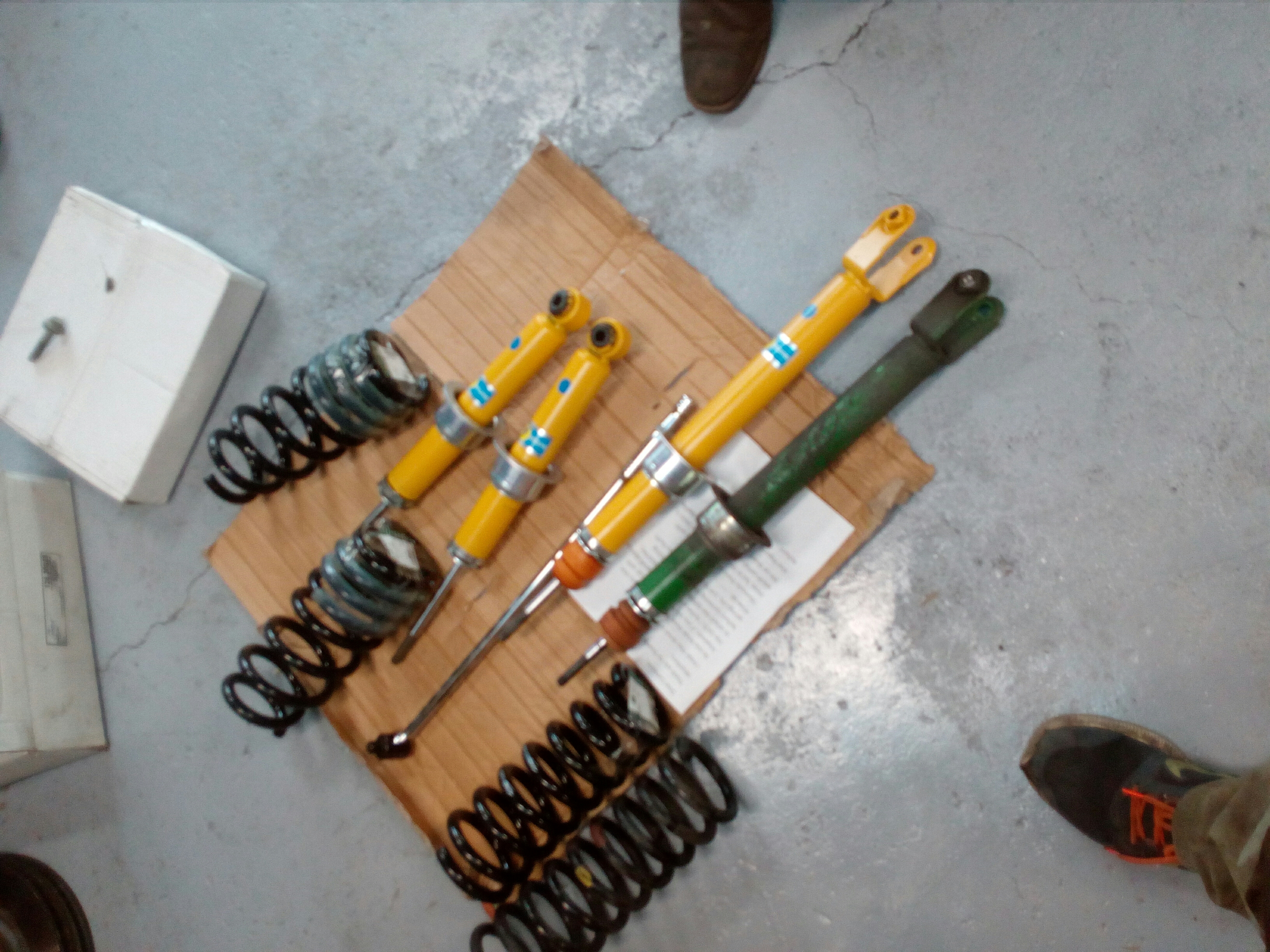

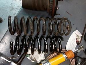

I have lowered a couple of Alfa Romeo's in my days and wonder if an XK is DIY?
Any special tools needed?
Is it a pain to get them off and on?
Cambo's XKR portfolio recently received the full XKR-S treatment.
By memory 13, 15 & 18mm sockets were used along with a T60 bit for the front.
With the spring compressors make sure you use three as the coils are very firm.
Attached Thumbnails XKR Lowered H&R Suspension-img_20170925_143212.jpg   XKR Lowered H&R Suspension-img_20170925_151923.jpg   XKR Lowered H&R Suspension-img-20170925-wa0005.jpeg

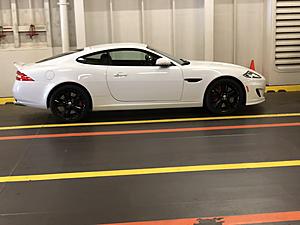

Originally Posted by Freedom8675
Lowered my 2014 XKR over the weekend, might not be everybody's look. I think it looks nice and aggressive.
Great taste in colour lol.. I literally just picked up the same car but 2013 and found this thread because I’m looking for the proper size wheel spacers and now you got me thinking of lowering the Cat when I said I never would lol...
