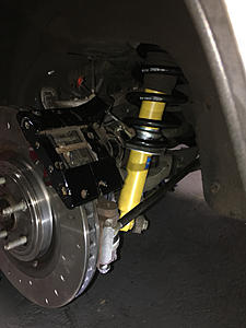

Actually Cameron (Cambo) and myself swapped out his portfolio suspension today for xkr-s shocks & springs .
The xkr and xkr portfolio have the same ride height its the xkrs that sits lower

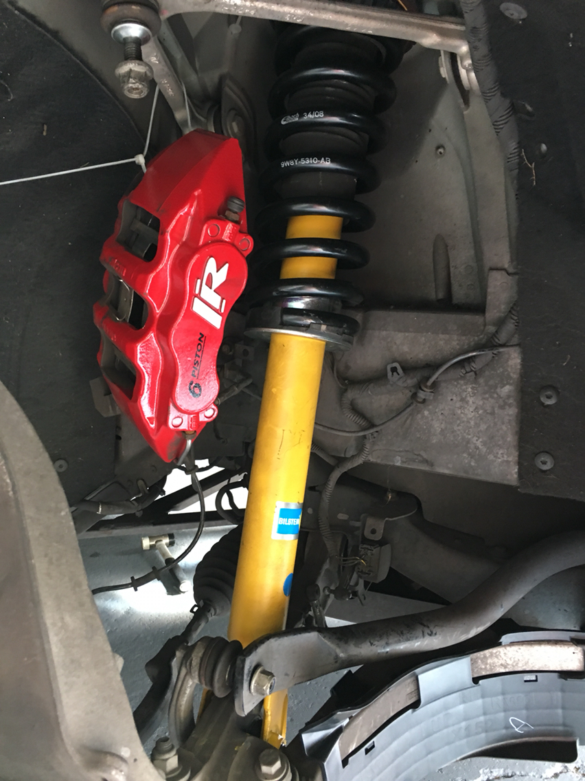

Yeah, was a big day.
The XKR Portfolio had the same ride height as the regular XKR.
According to the book, the 4.2L XKR-S was 10mm lower at the front and 15mm lower at the rear than the XKR, those are the springs & shocks we put in today.

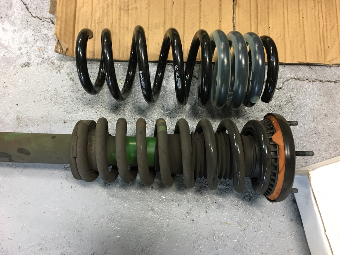

And fwiw here is the XKR-S rear spring compared to the regular XKR one

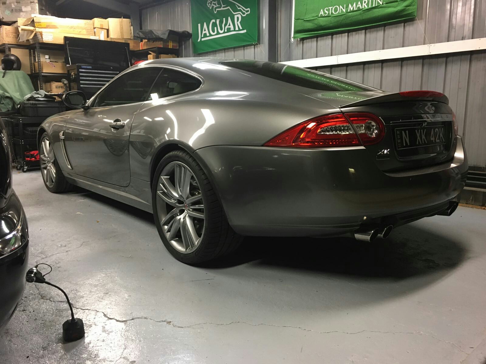

Old Sep 28, 2017 | 03:42 PM
Cambo's Avatar
Joined: Jan 2011
Posts: 8,637
Likes: 4,526
From: Sydney, Australia
This was taken the day after the install.
I don't have any better pics right now sorry.
