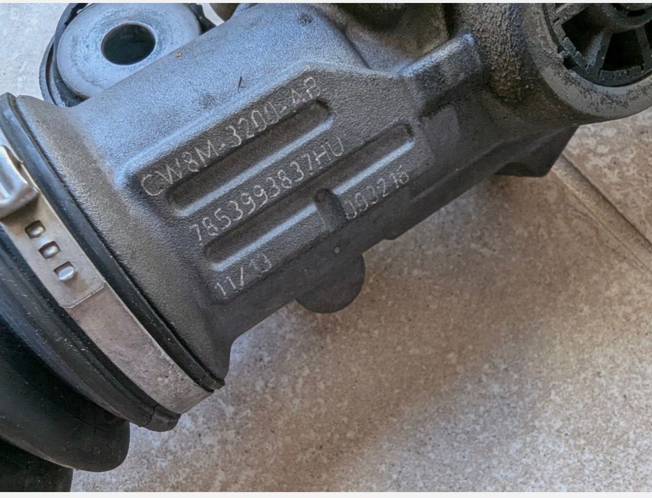

Hello everyone,
I’ve bought a XKR-S RHD an have started the convertion process to LHD. So far I’ve been able to source all the parts except a decisional problem with the steering rack.
does anyone know what’s the difference between the XK/XKR and XKR-S rack?
I’ve looked up the Jaguar site and part nr for the XKR-S is :
C2P23655 - Steering rack and pinion
C2P24859 - Steering rack and pinion
C2Z25888 - Steering rack and pinion
latest one being the c2z25888
when I google this only thing that comes up are the dealer websites. If I go for a used one the part nr changed to : cw8m-3200-ab wich brings up a lot of parts for different cars and year production.
question is:
how do I find the “C2” on this used parts and is there a difference between the different variants of the XK
Here is an example photo:

C2Z25889 - Steering rack and pinion £7,045.81 RHD
C2Z25888 - Steering rack and pinion £6,953.38 LHD
Old Feb 7, 2026 | 05:02 PM
Key Log's Avatar
Joined: Jun 2015
Posts: 14
Likes: 6
Originally Posted by ericmcn
Seems like an awful amount of work, why not get a LHD model?
These are for the 2008 XKRS
the C2Z25888 is for Xf and XKR-S vin number after 49
RHD is about 70/80k after registering it in Italy wich is double of what my RHD also because I wanted the convertible French racing blue and that is about 25/26 produced Fi both LHD and RHD

there is no modification to be done to the body as it’s already predisposed for both LHD and RHD the pedal assembly and the brake buster cilindro needs change together with pipes that go from master cylinder to abs no other modifications
next steering rack needs to be change together with hi pressure pipe and return oli
on cabin there is a bit more to do but more or les
floor carpets
windows and mirror switches
dashboard and heating box
wiring lome is same as the Xkr and can be found on braking yeards easily
the harness of the doors are reversible
the door handle needs to be replaced
glass mirrros also
headlight have a mechanical
switch for LHD alignment
there are more bits but nothing that can’t be found out there
Again the Xkr-s was just a mechanical upgrade and a facelift parts for convertion are the same.
xkrs-get uses a standard F type 2013-2016 steering rack (can always use that for about €500 used) but wanted to see if someone knew more about this numbers before I do

The steering rack is different, as are struts, springs, roll bars, control arms and if you are unlucky the Alcon set-up. Much of the interior is different too. It's a ball ache but interesting to see what happens

Except for the steering rack (wich again is not unique to Xkr-s but also used in xkr dynamic version, xfr-s and some xk with wider 20 inch tires) everything else is cosmetic parts.
