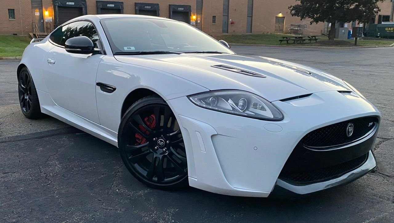

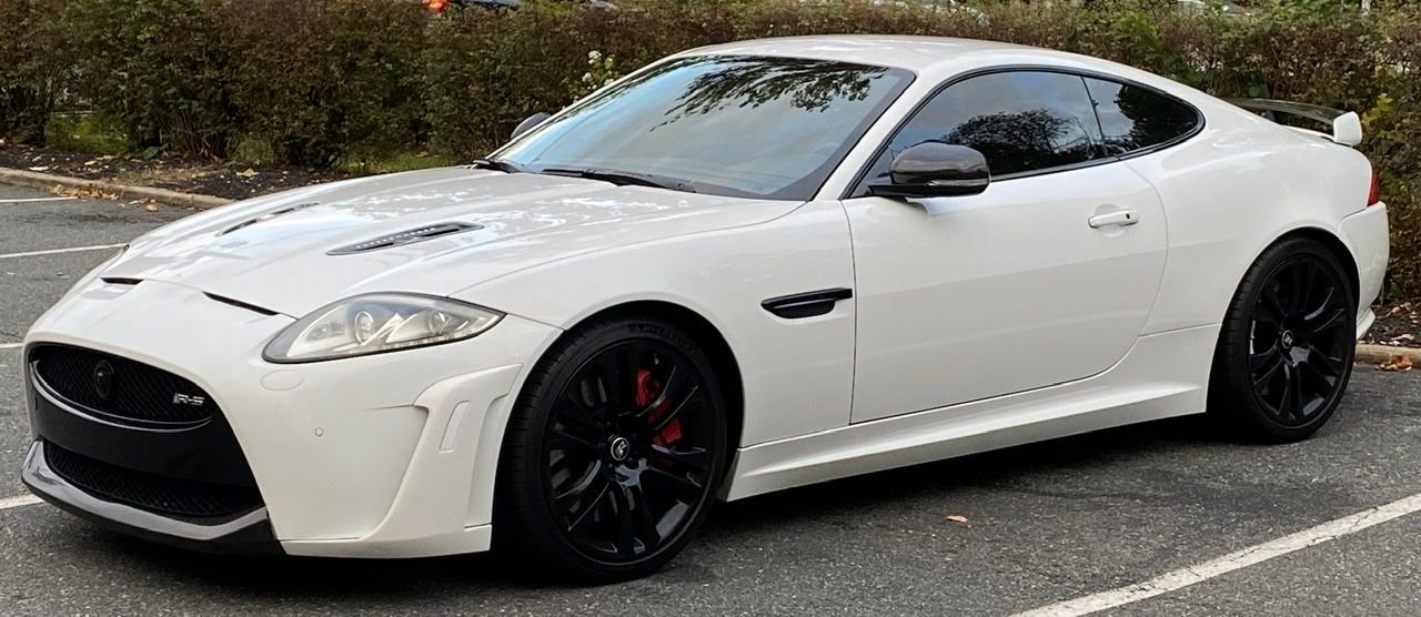

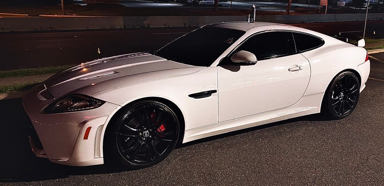

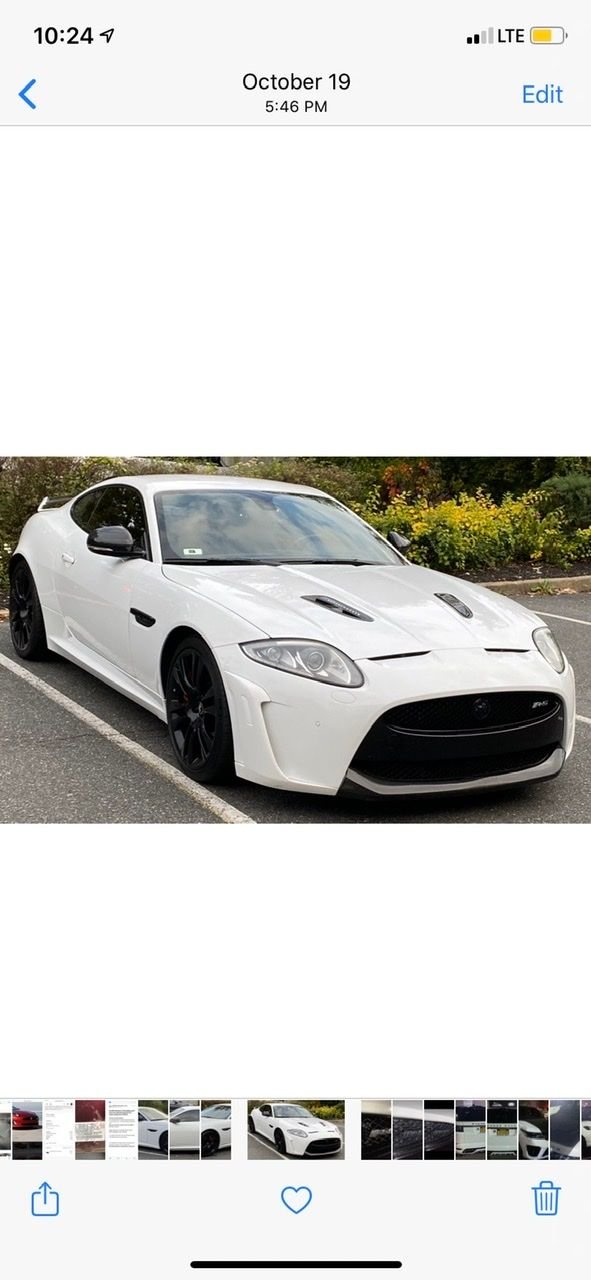

Default XKR-S Upgrades you should do
I have a 2012 XKR-S. This is my 5th one. 2nd S. Rest were XKR.
get tune from Eurocharged as well as the pully. You get the most gains from their tunes.
also they make a kit to replace the couplers and seals of the supercharger. It’s called a “rebuild kit” but it’s only couplers and seals. Not the snout. I gained another 16hp at wheels but replacing them.
intakes you can get on eBay. 2 K&Ns. They are installed by taking the front wheels off and pull down inner fender walls. I Gained 6hp from those
so I dynod car after each install
just with those I mentioned.
Currently I am at 648 HP to wheels & 591TQ.
and to be safe your not loosing any “stock” HP. Have your aux water pump for charger looked at, both engine fuel pumps and both engine fuel pressure sensors. If they are all good. You will have a rocket.
also rule of thumb. These cars with higher mileage over 80k. Put 0w20 high mileage full synthetic and a quart of Lucas high mileage oil additive every oil change and every 4-5 times you fill up. Throw in a Lucas high mileage fuel injector additive in the tank as well. I have 0 lag..ran a 10.2 at 1/4 and burried the Speedo numerous times..
