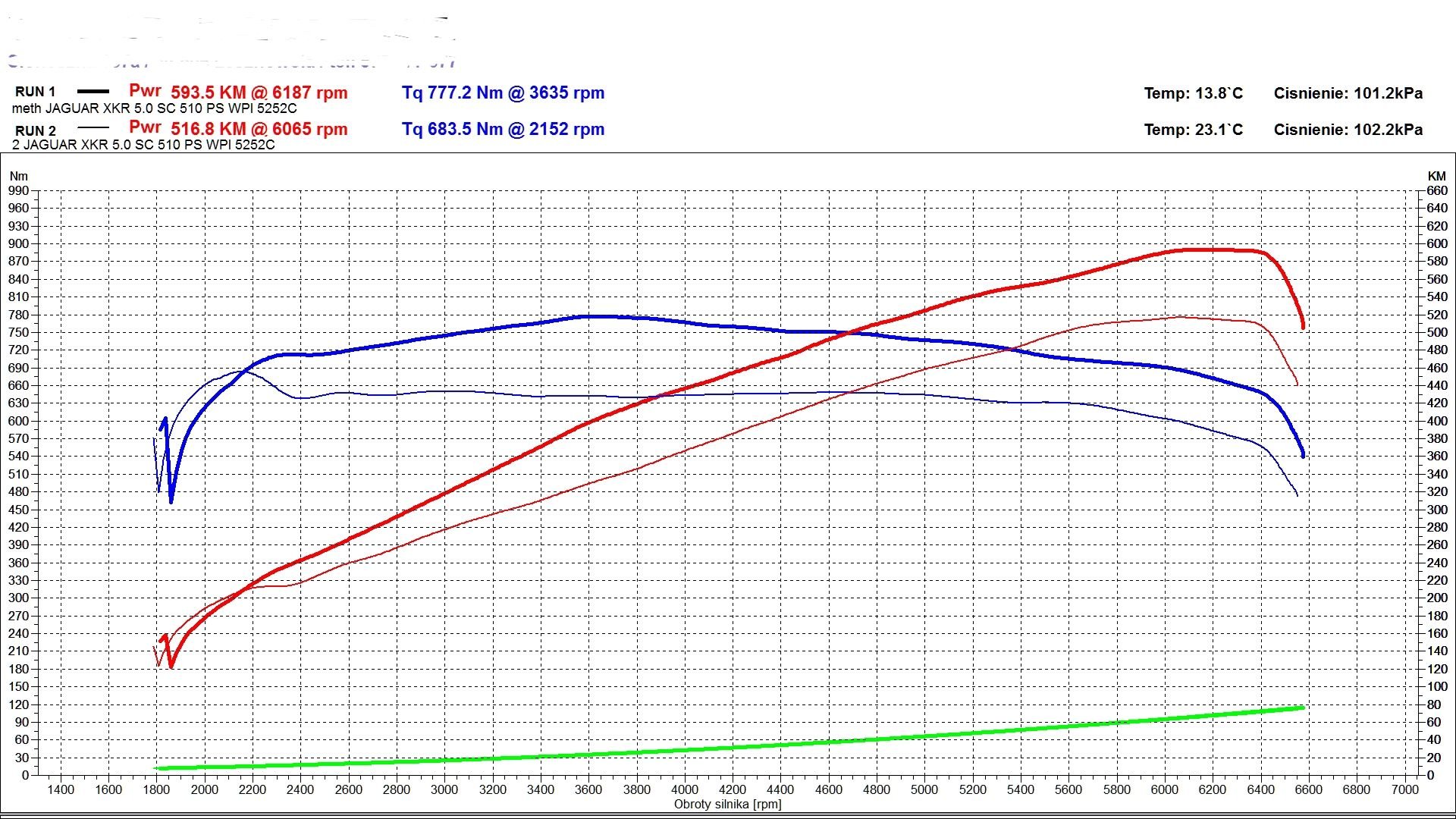

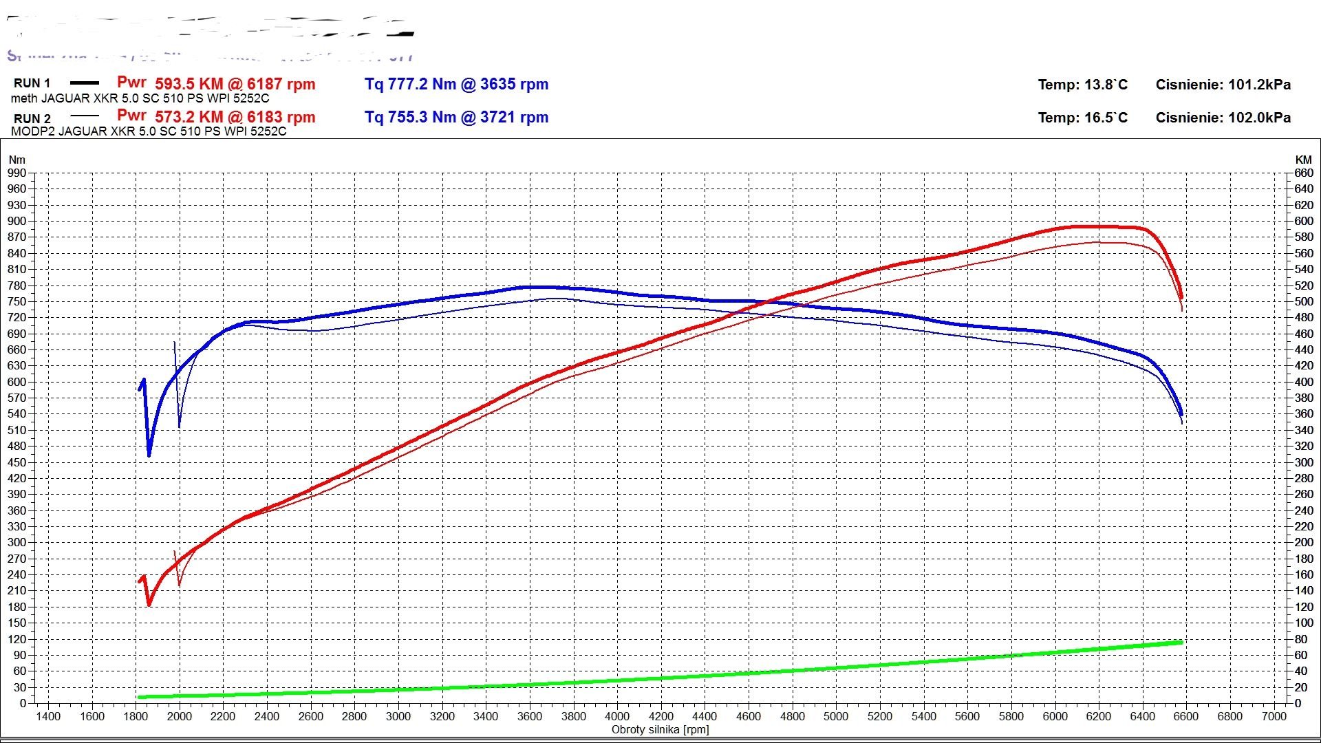

Finally I received my dyno sheets.
Stock soft vs tuned + watermeth (both on hardware changes - bigger IC, smaller upper pulley, K&Ns) & tuned vs tuned + meth.
Hope it helps.
Edit: "Blurred" tuner's details, just not to be considered as spammer/advertiser etc. If anyone wants to get in touch with them - pls PM me, I will share details.

Nice torque curves!
