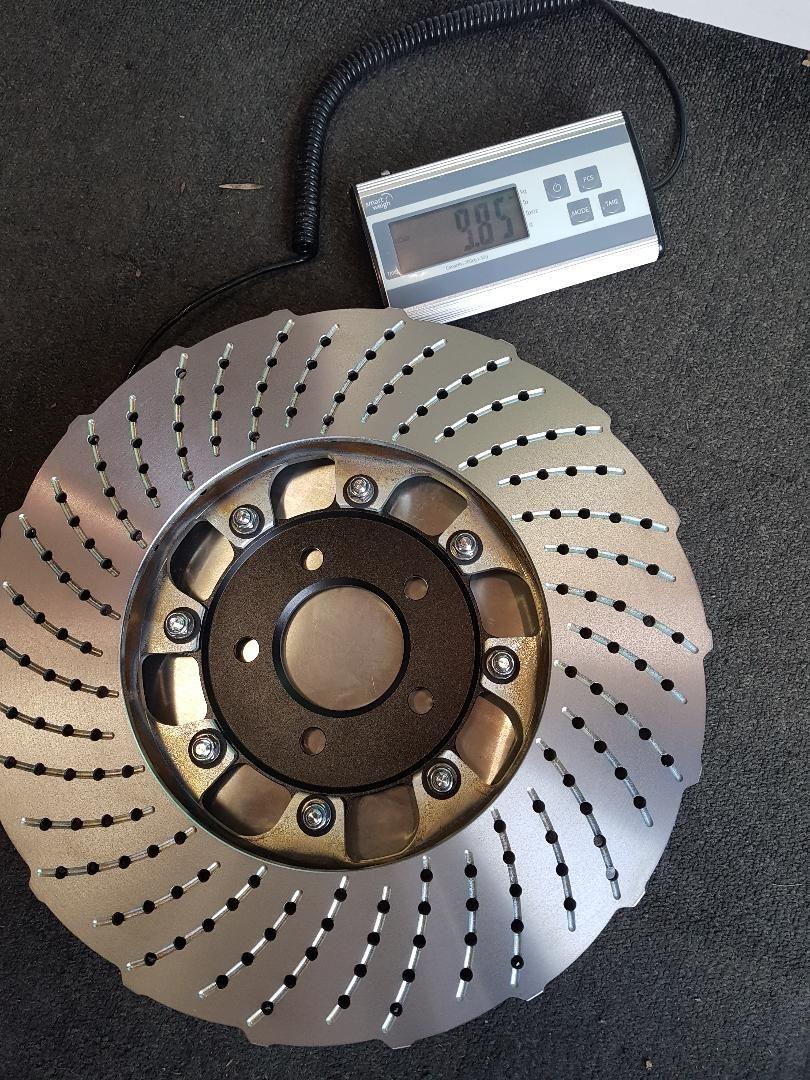

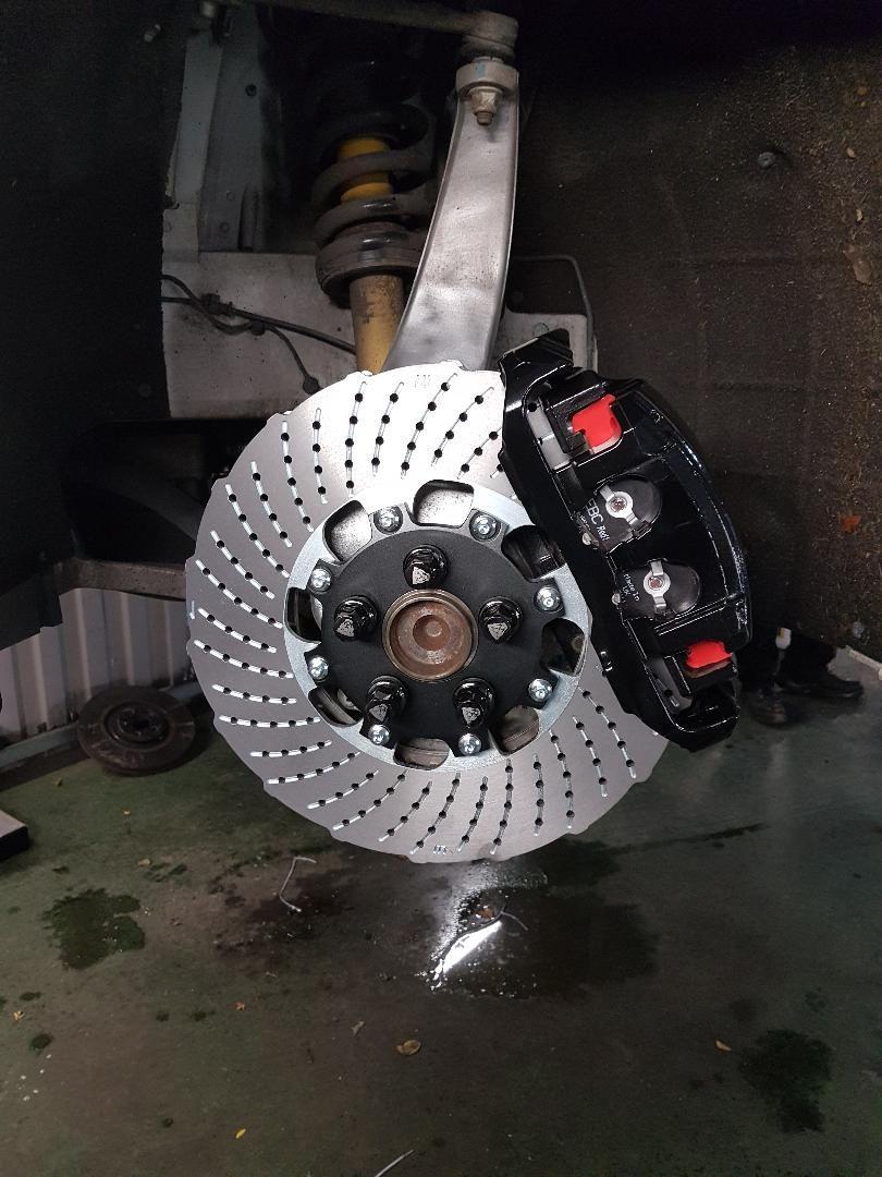

If money were no object and I was tracking/dragging mine I;d fit wortec discs (which I have) and their own race compound 8 pot front calipers and 6 pot rears (which I can't afford)
pic of rotors below:
The rotors alone will save you 45lbs in unsprung, their calipers another 30lbs

[QUOTE=MarkyUK;2084621]If money were no object and I was tracking/dragging mine I;d fit wortec discs (which I have) and their own race compound 8 pot front calipers and 6 pot rears (which I can't afford)
The rotors alone will save you 45lbs in unsprung, their calipers another 30lbs[/QUOTE
Those look amazing !-I read about wortec on the f type forums - anyone in particular to reach out to over there to get more information on cost / fitment and daily driveability of this setup?
Is probs best to contact them directly and check if they have a distributor in your country:
HOME
I went through Swallows Jaguar Specialists
https://www.swallows-jag.co.uk/
Appreciate that supersports (non ventilated) seats save 7kg each over stock, I have no rear backbox saving 20kg plus the 20kg saving of the Wortec's
Plus I weigh a mere 72kgs when the average is 83kg here in the UK, so my car (with me in it) should be 51-65kg lighter than any other 5l XKR out there, which logically means it should go faster!!
As to driveablity, since no other XK has them fitted the voting panel is of one - me!
No difference to stock in normal town driving, hard braking at speed I'd say is 30% up, but appreciate that my pads/discs that came off had lost 20%, the brake fluid had a water content of over 4% (high for a car less than 5yrs old) . So may well be a placebo effect.

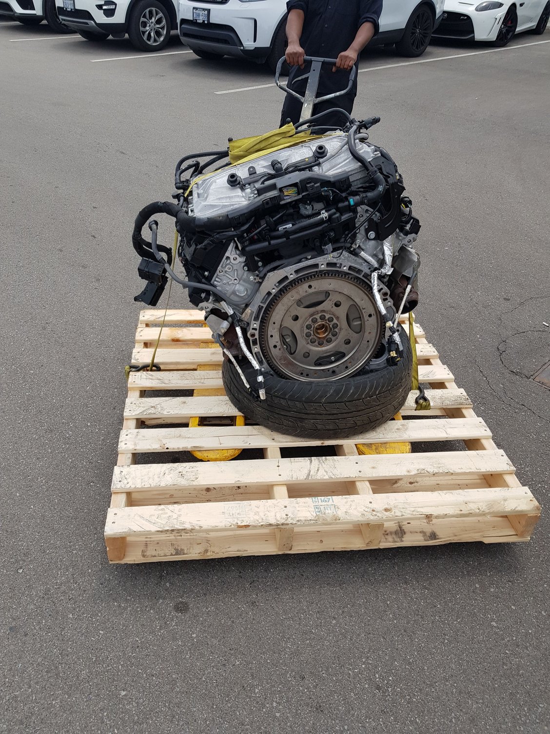

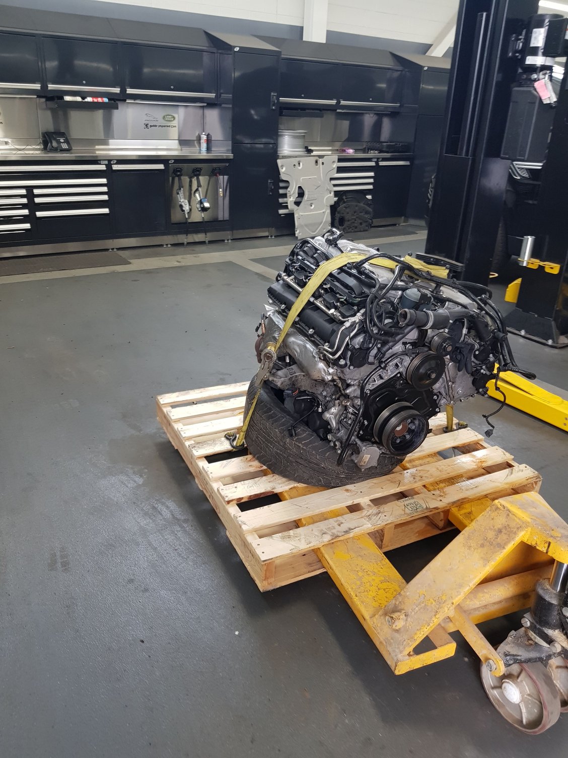

I looked up the reviews and comments on the Pierburg CWA 050 and ordeed it. Thanks for the direction. On a side bot my new to me engine arrived today. Pics below. Things are about to get exciting!

The tire was exciting but not as much as the strap! - .i think i got a good deal. $8500 CAD for a used 2016 SVR engine with 60K so ill take any freebies included.
