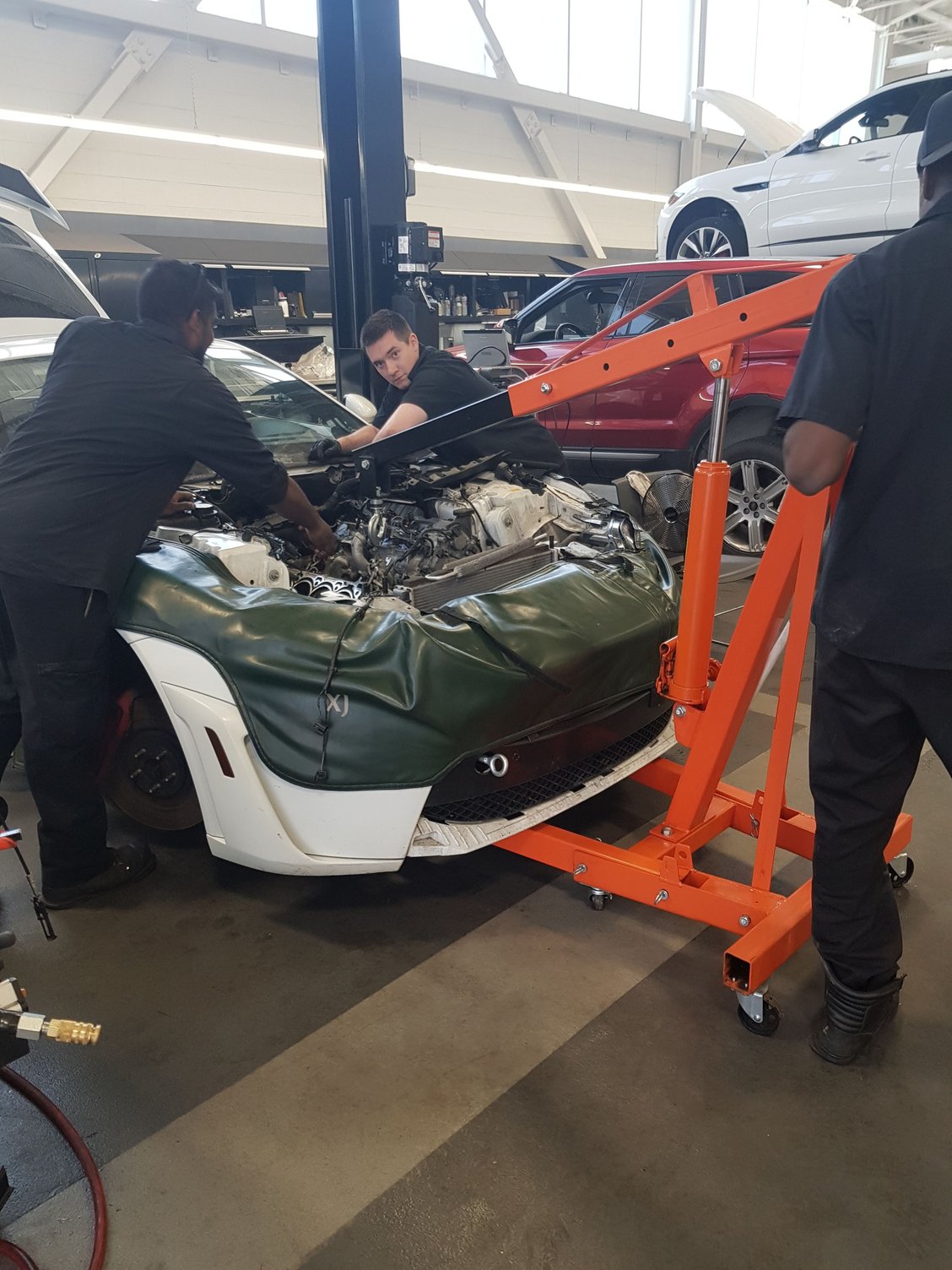

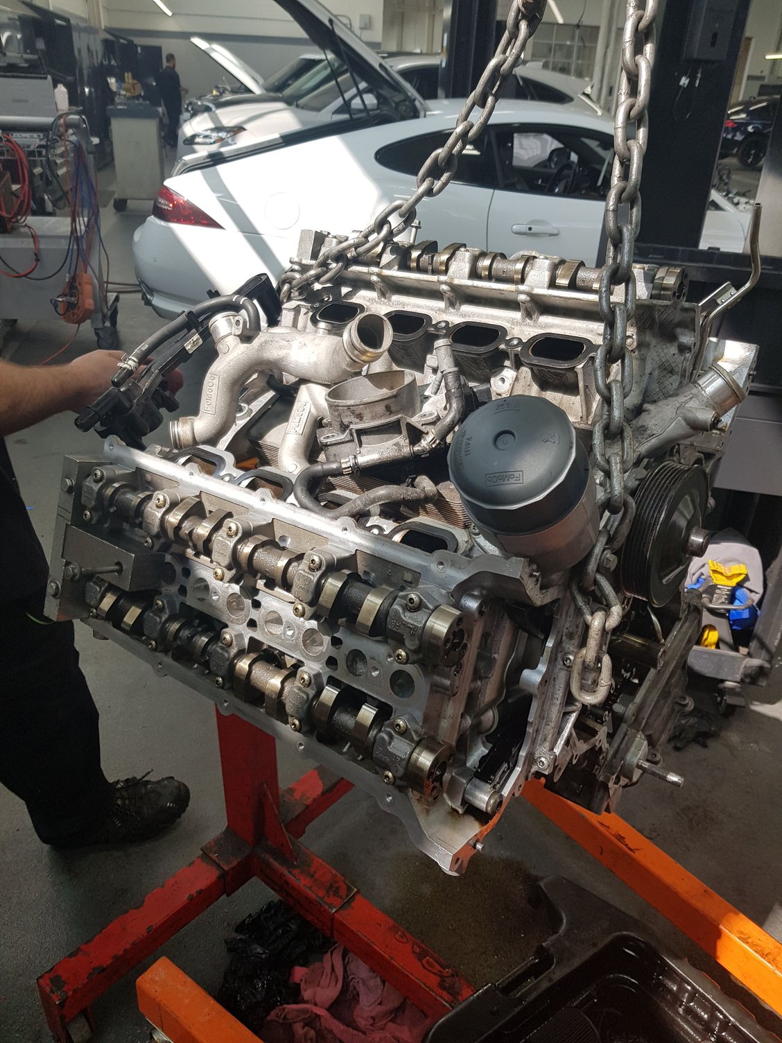

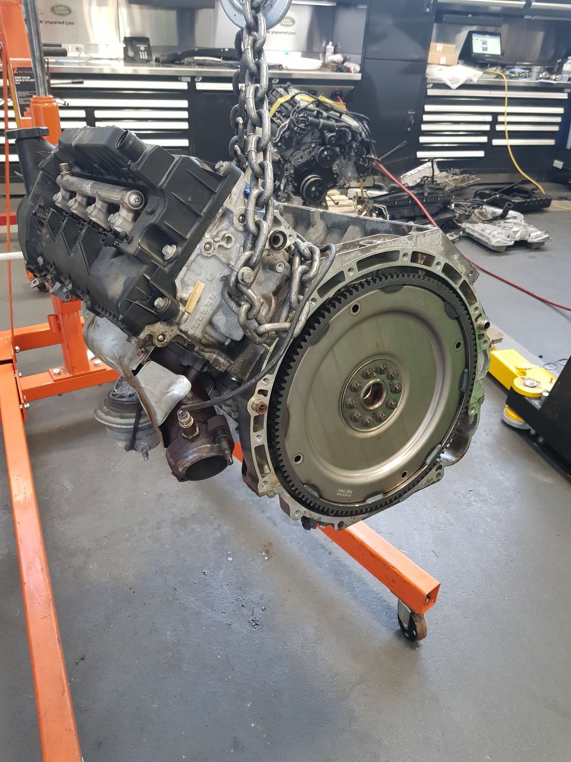

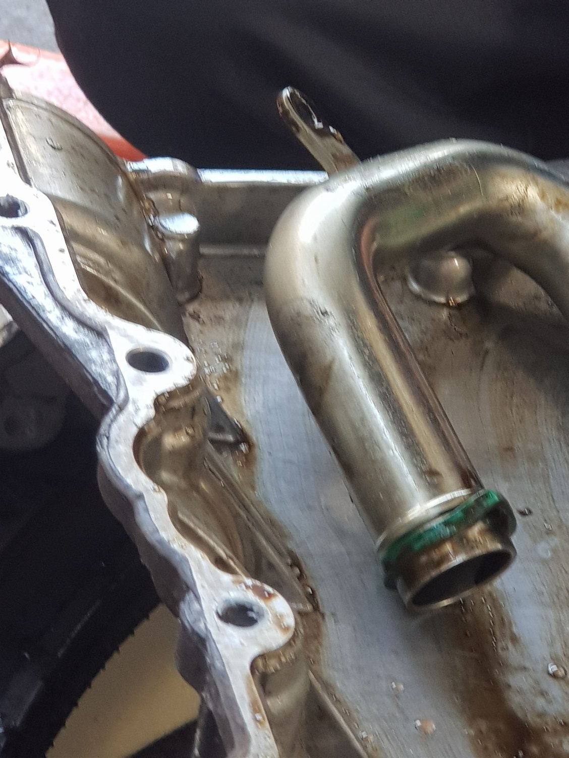

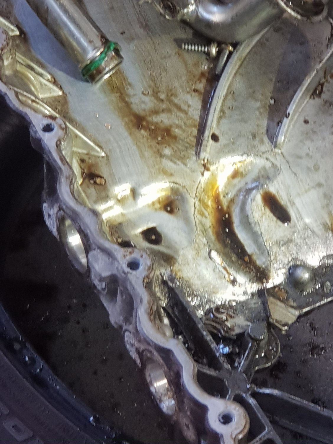

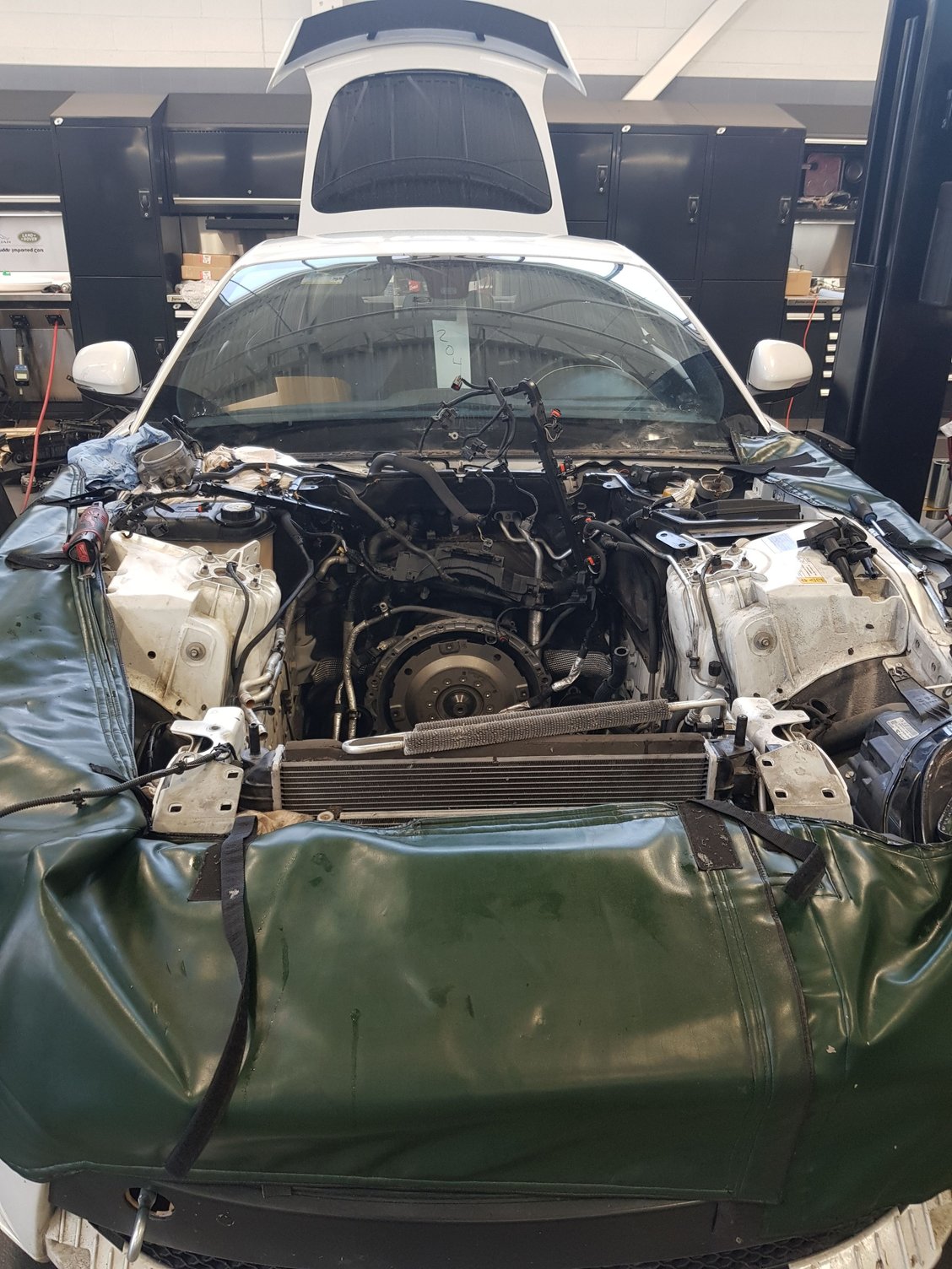

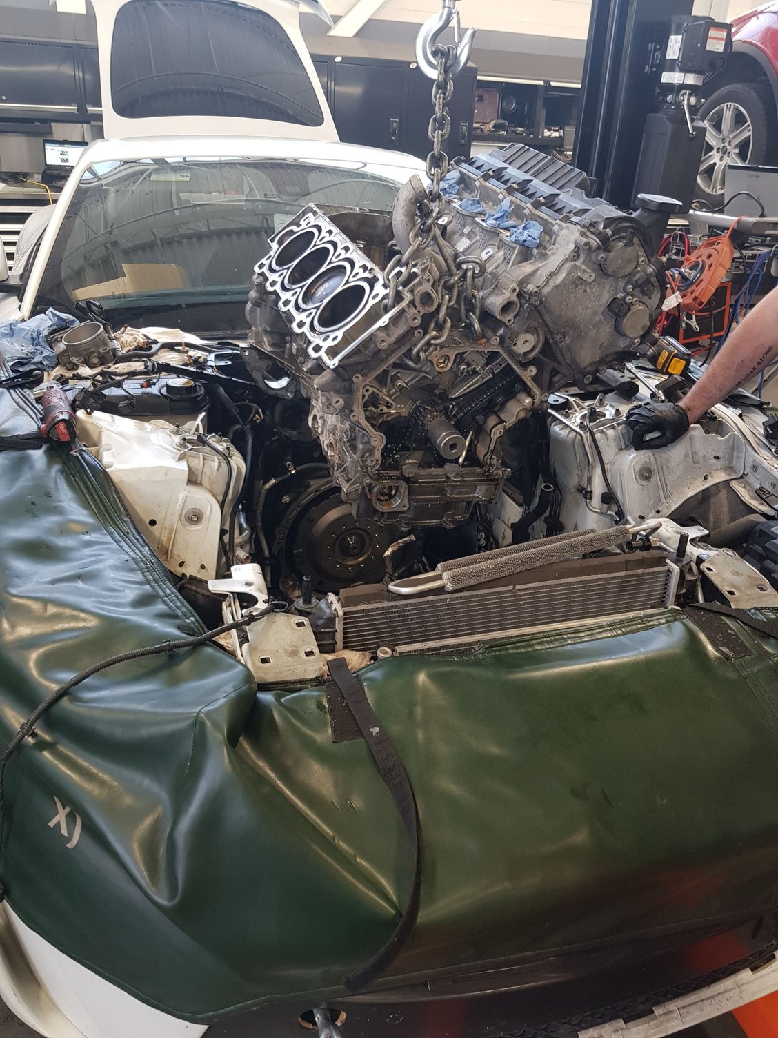

Default Disassembly 2 -Engine out!
Flash in the pan
Almost out
Dead weight
seal failure? Perhaps.
Too sad😓

Originally Posted by R Bhal
We started disassembly on Tuesday and what we found was not pretty.
You should start posts like these with a trigger warning.
Just kidding, appreciating pictures.

Originally Posted by Ranchero50
Lack of lubricity eats another 5.0....
My conclusion looking at the pictures that it is melted first, then fused. This points to a thermal event and not oil issue. Loss of oil pressure would have had bearings fuse and cease first.

The new to me engine being worked on. All the bits that i need from the old engine being cleaned and put in this one. Anything that looks even slightly suspicious will be replaced. VVTs had to be transferred over aswell -
We are using the metal parts from the old engine which due to cost savings are now plastic on the newer engines. You can see those sitting on top.

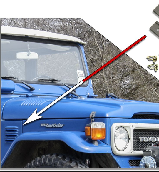

Originally Posted by Queen and Country
The exterior needs the largest percentage opening grille that you find visually acceptable. If my vents were horizontal like yours I might even leave them open. Even if a mesh has 75% flow rate, it means you are reducing airflow by 25%, in an already very small opening. Make opening inside the fender even larger.
Louvers wont work on this car. You dont want air to flow through the radiator and out the top of the hood. You want it to travel the length of the engine and relive the high pressure area by the firewall where the heat wants to accumulate.
Consider wrapping the headers.
So why did they put louvers on the XKR?

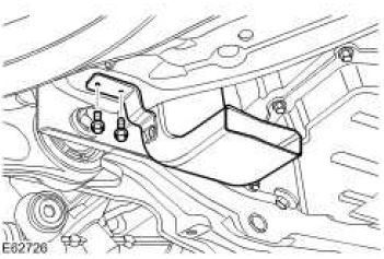

You can also consider making a ram-air duct underneath the engine to relieve the hot spot by the firewall. Similar to the alternator cooling duct seen below.
Or an open duct underneath the car that would use the low pressure passing air to pull the air out of the hot spot. That would also force air form the front grille to make its way to the back of the engine bay.
Same reason god put **** on a man. I suppose a little bit of excitement, thats all.
They are of about as much use.
The idea of the duct is a good one, although if you can do that kind of work, you can easily make the side vents more functional. Even my 42 year old truck has them.

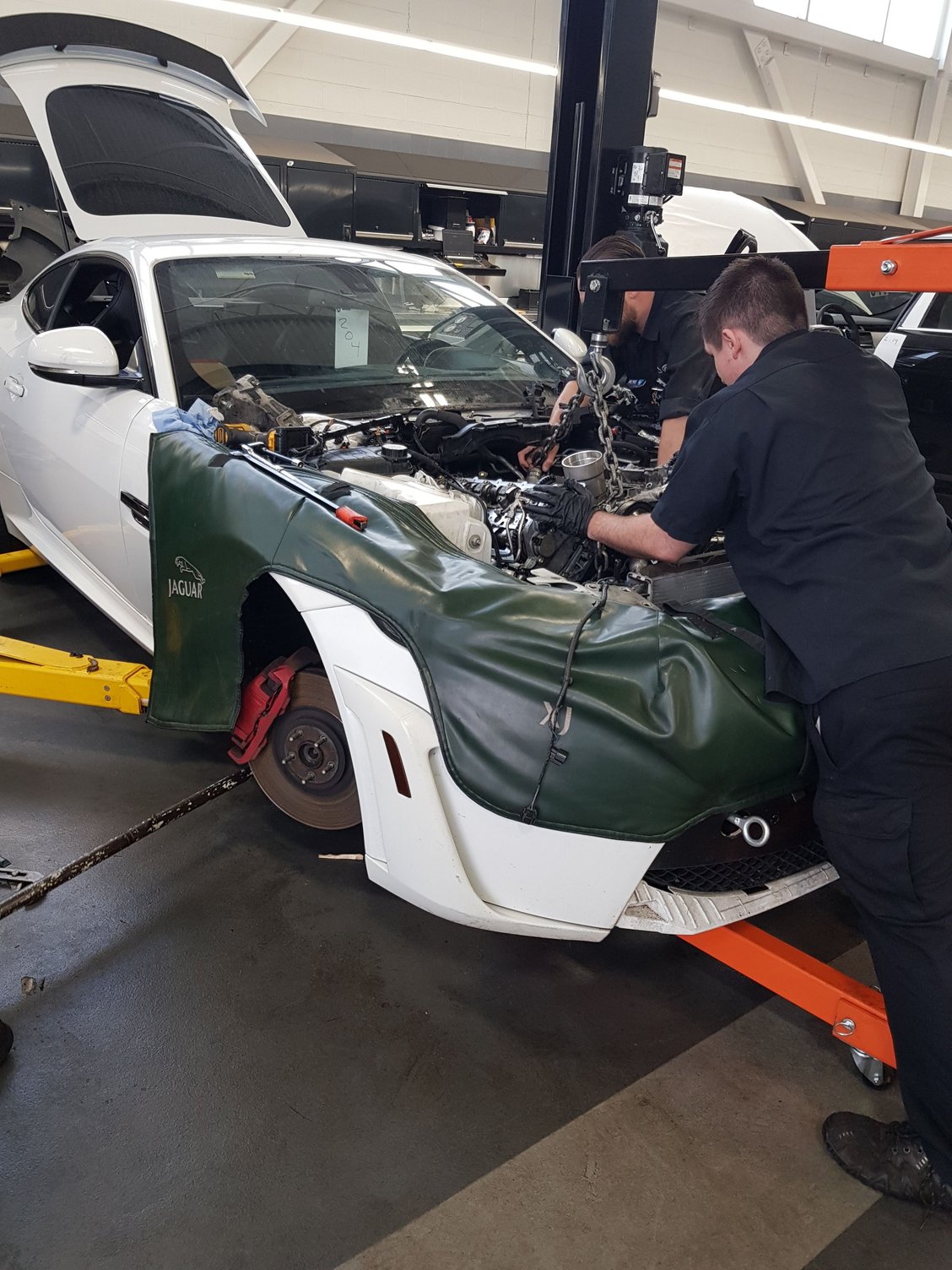

Davaid Attenborough voice over ..." and here we see the heart of the cat being gently inserted"

What shop is doing the install? Is it a Jag dealer?
Old Jul 10, 2019 | 09:42 AM
  #74
R Bhal's Avatar
Joined: May 2017
Posts: 42
Likes: 30
From: Oakville
It is a Jag Dealer- Budds Jaguar in Oakville, Ontario, Canada- great people - awesome service. Special shout out to Bill (service manager) Joel ( my main man) and Lewis (the apprentice)
