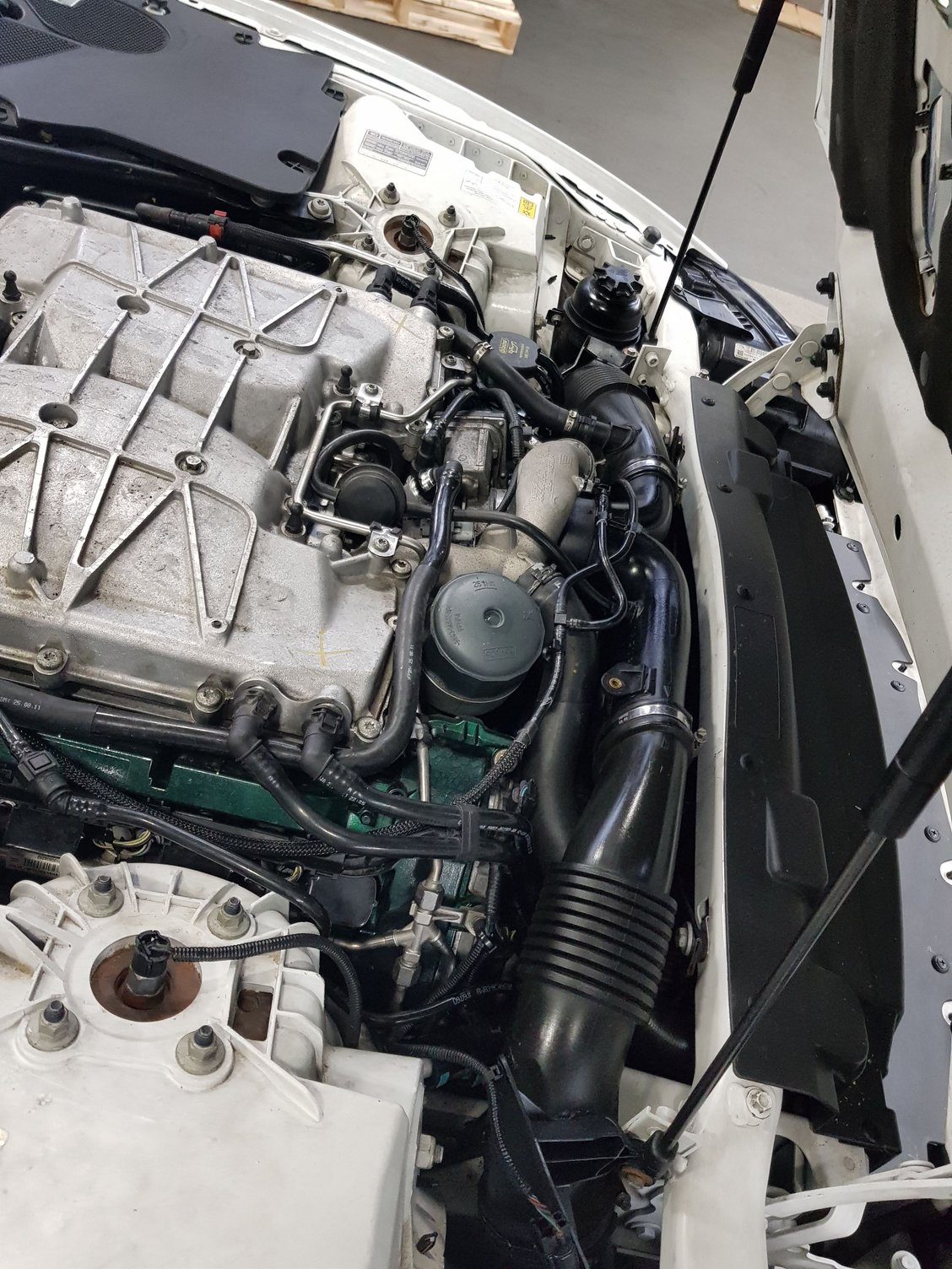

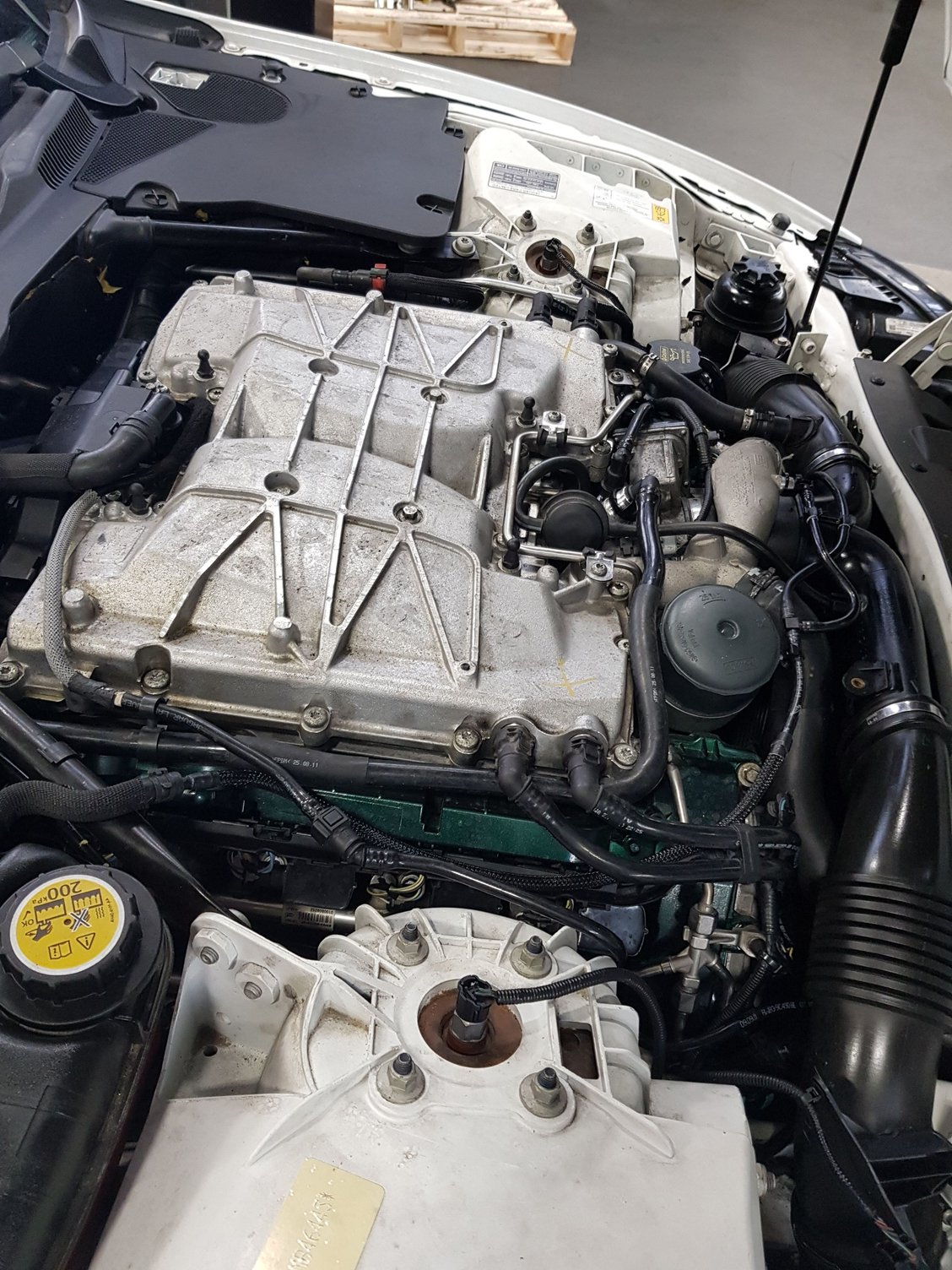

Default Whooohooooo- back up and running!
Hello gents.
My baby is back, and so far better than ever! Joel, (my tech) from now on known as the 5.0 litre whisperer, is taking her back tomorrow to change the diff fluid/ trans fluid, brake fluid- at that time he will also upload the custom tune from Viezu. We drove it around yesterday with all the mods except for the tune and the supercharger coolant pump.
Boy oh boy does she go! I called up my buddy with his lambo and lets just say he didnt want to race play anymore. - citing speed limits -MooHahahahaha. (evil laugh)i drove her hard yesterday and Joel called me in the evening to check and make sure there were no codes- lights etc. Great guy! I have had her back for less than a day and i have a stupid grin on my face every time I get in the car. The torque is awesome as is the sound. The supercharger whine is intoxicating-Joel suggested to leave off the plastic/rubbery covers around the valve covers, and while he was at it he painted them with 5 coats of metallic BRG. He is saying we should send off the supercharger cover and have it powder coated in the same metallic BRG. Love the idea.
So, I shall try to stop gushing- and give you some real feedback on the driving.
The car seems more capable. Torque is definitely up as is the overall feel of the power delivery. It pulls strongly through all gears approaching illegal speeds ridiculously fast.
Once again this is all with the factory tune and just the mechanical parts- supercharger pulley, crank pulley and supercharger cooler. Joel says the car is currently running lean but once he uploads the Viezu tune he will also change the plugs and that should fix that.
The tune( so far) was plug and play- we drove the car for a few km and uploaded the original file to the device Viezu sent to me , then we registered to their portal and uploaded the original file with some pertinent info- Viezu has sent back a custom tune and i will be sure to update you guys once installed.
A couple of notes of interest- as the charge cooler is thicker -less air gets to air con unit behind it- so whilst the car is sitting it pumps in relatively not so cold air - but is perfectly fine once the car is moving. The price we pay for performance.
Also, installing the upgraded supercharger cooler pump with the controller requires Joel to fabricate a harness of sorts to tie into the otherwise the car will thow a code and put the car into limp mode. He is working on that solution.
I think i will get the car dynod once everthing is done. Im already pulling away from a stock lambo and the tune is not even on the car. I want to know where i really am as opposed to just guessing. The 5.0 whisperer says to take it to one where they take the wheels off and attach to the hub instead of the rollers. Any input on that would be greatly appreciated.
My cousin from the UK posing
Ready to be released into the concrete jungle
All back together!
See the green peeking through
