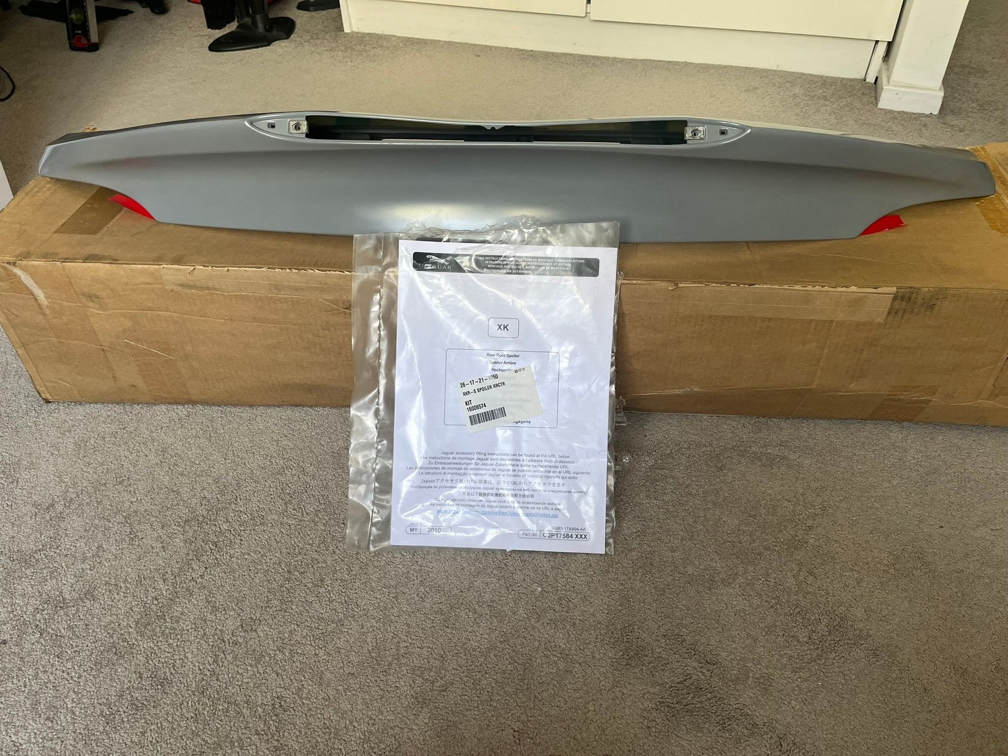

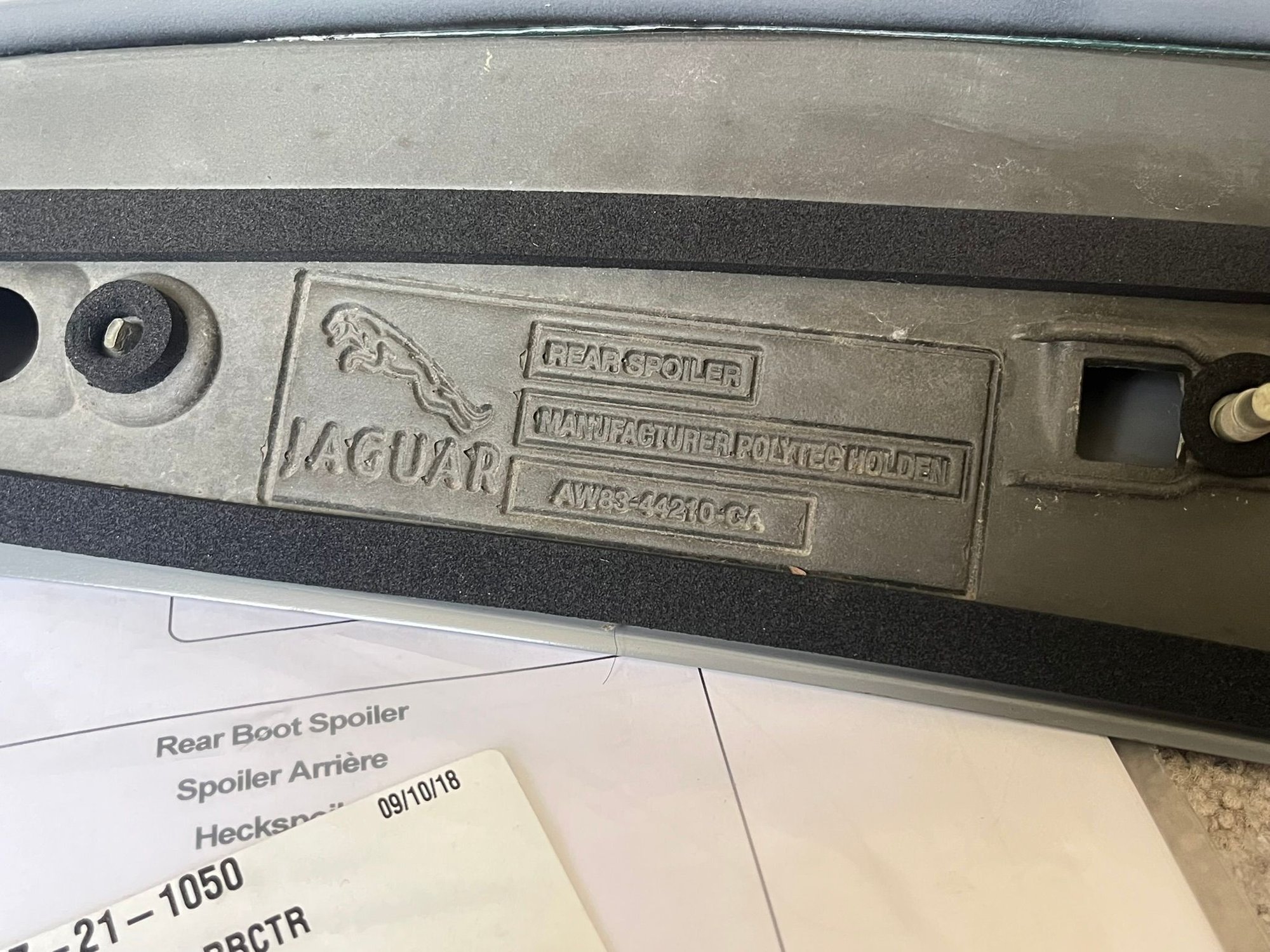

I just wanted to confirm to anyone looking for new speed pack spoilers that they're still available from Jag - I got one using the reference C2P22257XXX (XXX means unpainted). This is a pre-2012 spoiler part number and lacks the leaper on the back. It comes with adhesion promoter, an installation book (the book refers to the spoiler as being C2P17584XXX for 2010 which is another commonly referenced number for the speed pack).

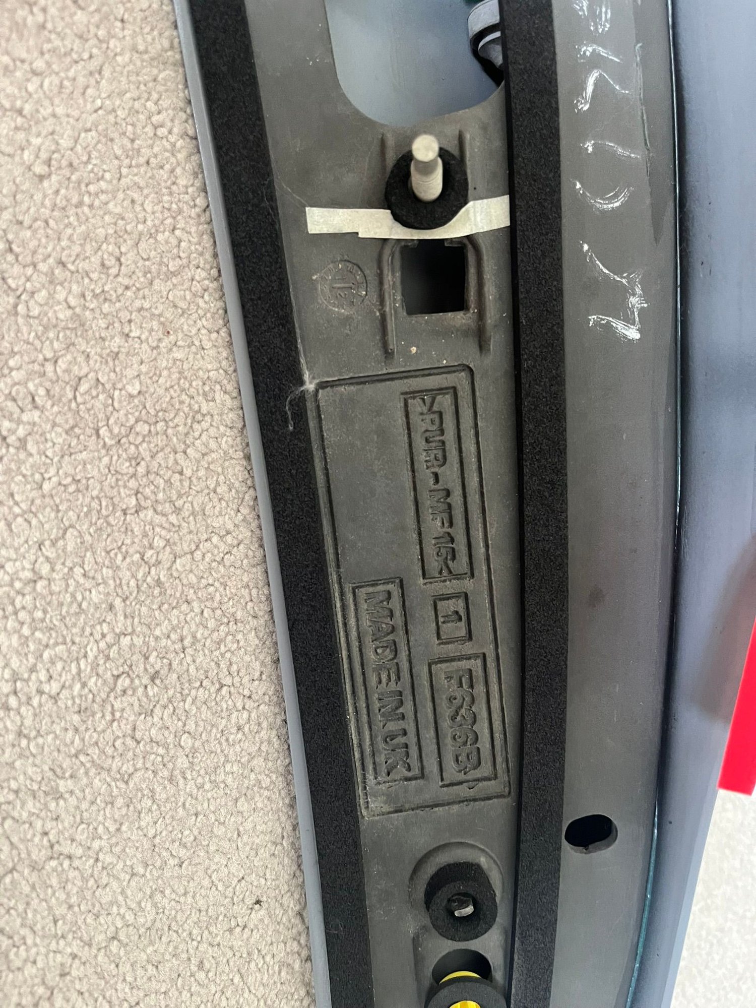

I chose the three pin connector for the aerial as my vehicle is a 2010. Interestingly the spoiler is made in the UK by 'Polytech Holden'. The spoiler is plastic and is quite flexible. The light housing section is bowed and flexes back to position easily enough so my presumption is that I will need to add my rear stop light in order to flex it back.
Some random pictures below as finding a lot of info about the spoilers and the numbers are tricky.

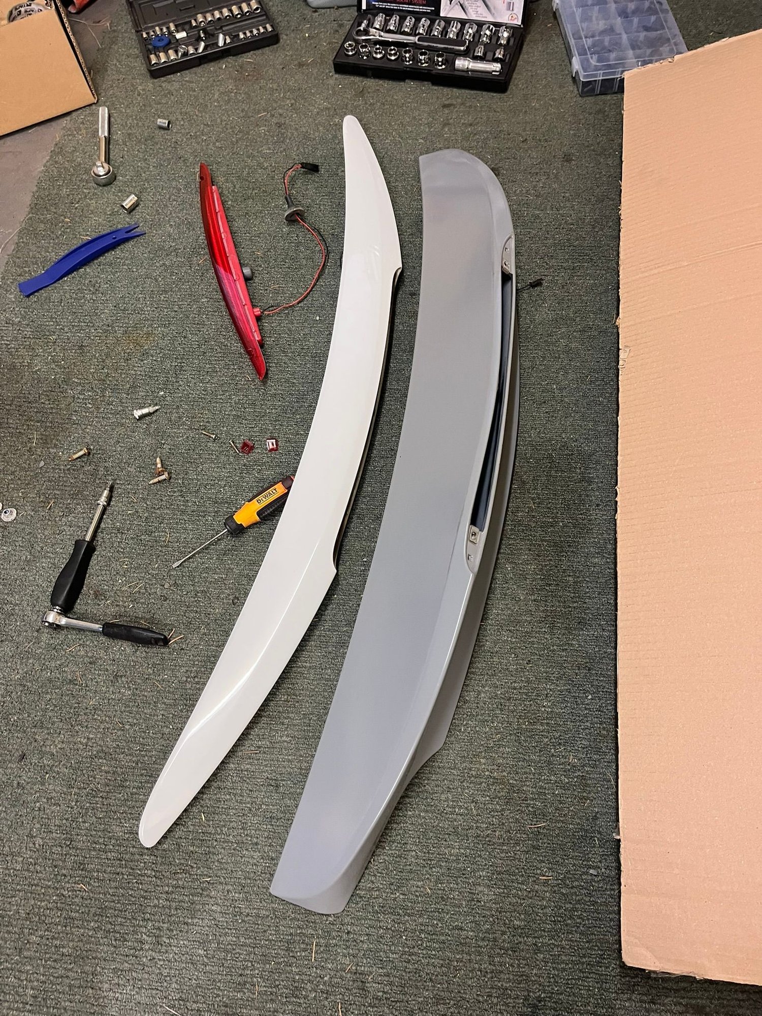

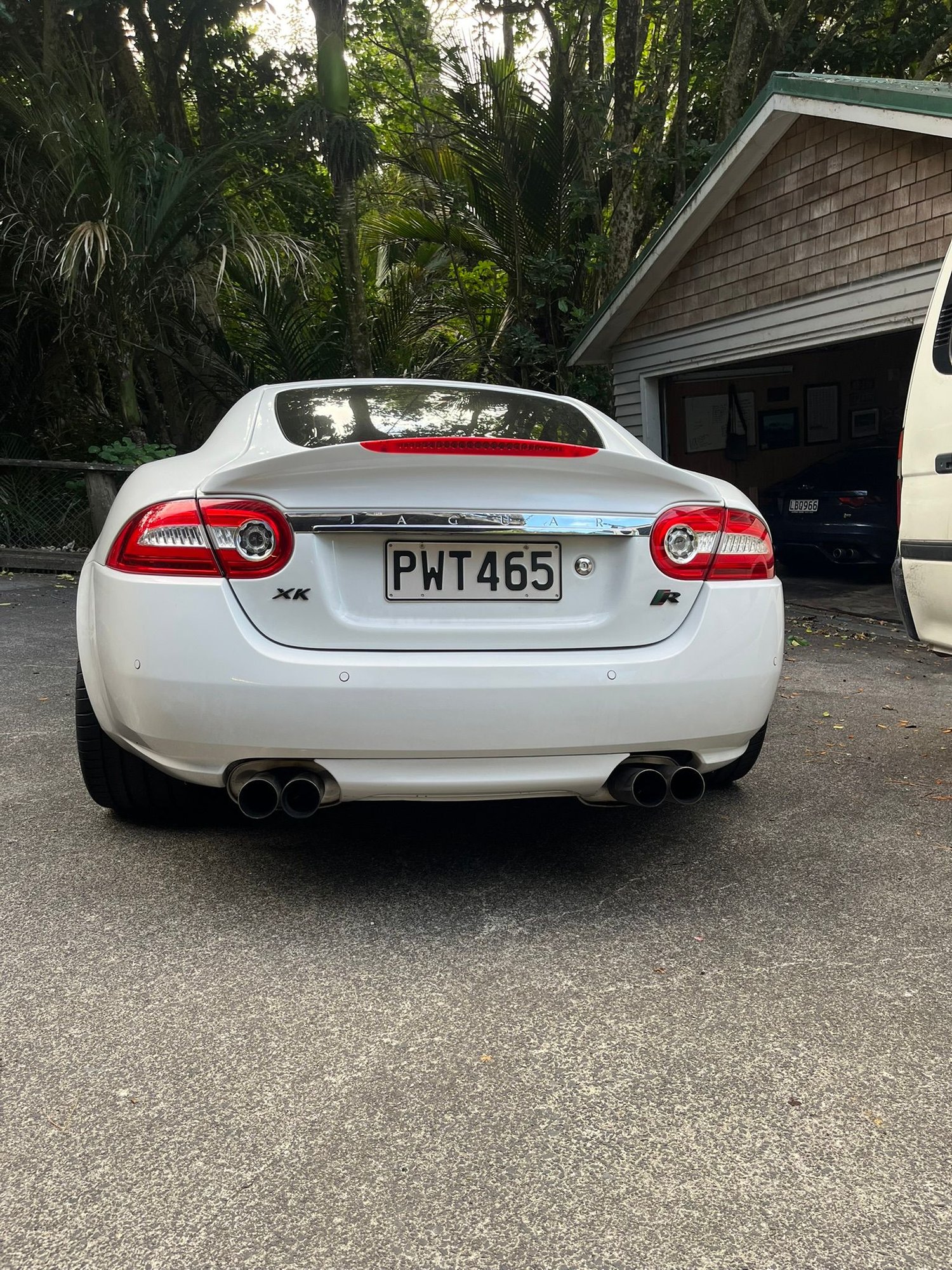

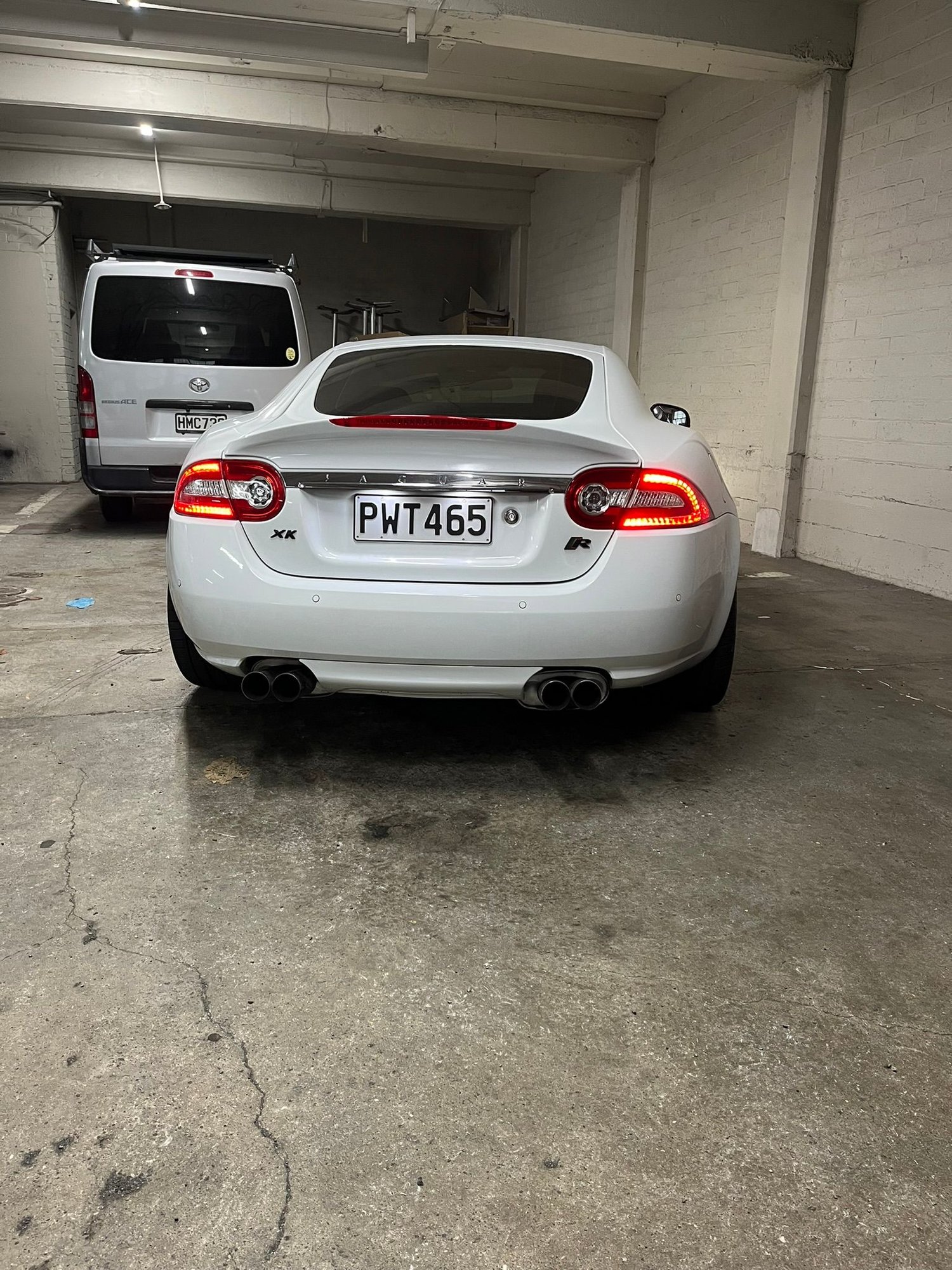

I painted and fitted up the spoiler today. A note that at least for my 2010 XKR, I actually needed to get the 2 pin radio connector - no problem as repinned the new one.
This spoiler really makes the car for me. The back end felt a bit incomplete without it and this really turns it into 'British Muscle' without being too over the top. I'm happy (at least for now) with not having the full speed pack as just the spoiler by itself looks really good. Visibility from the rear view mirror is still good as well. The spoiler is much, much larger than stock.
