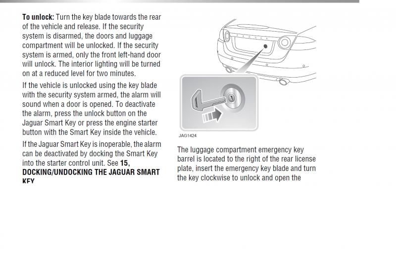

You should have a key hole to the right of your license plate for the emergency key.

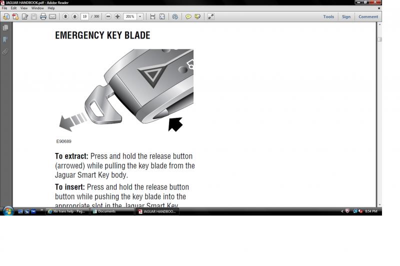

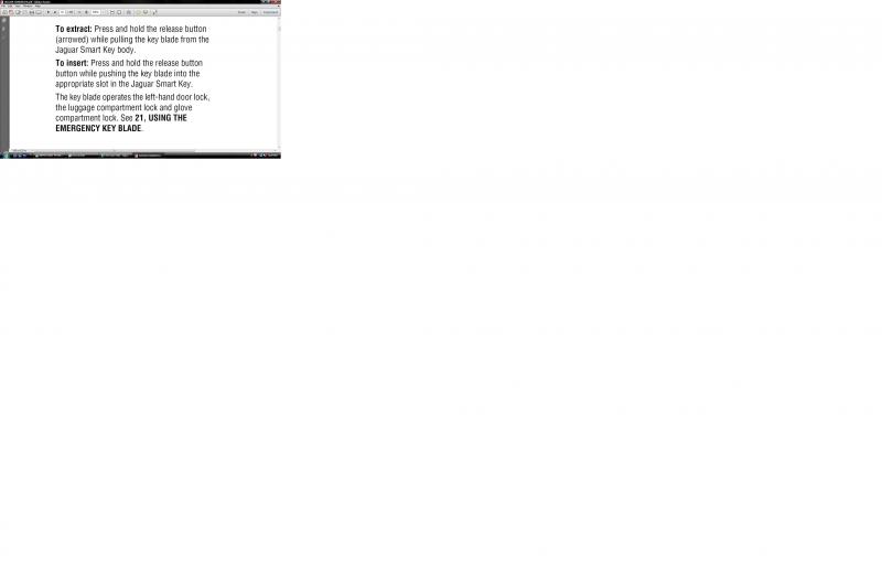

Read the Hand Book Download. It's the very first item on this site.
Take your Smart Key. Remove the metal key from the FOB. Insert into the keyhole in the trunk. Lift trunk up.

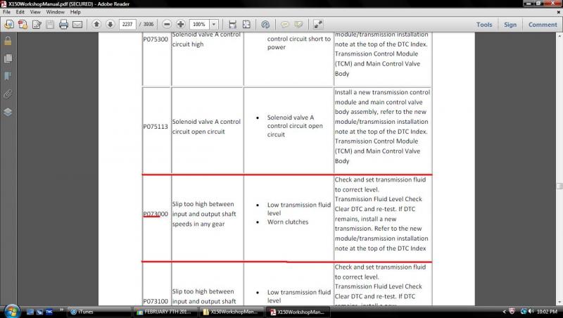

The attachment is from the ZF transmission manual.

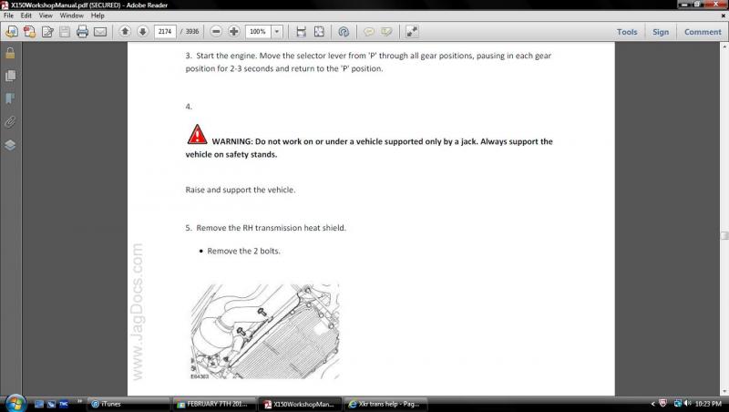

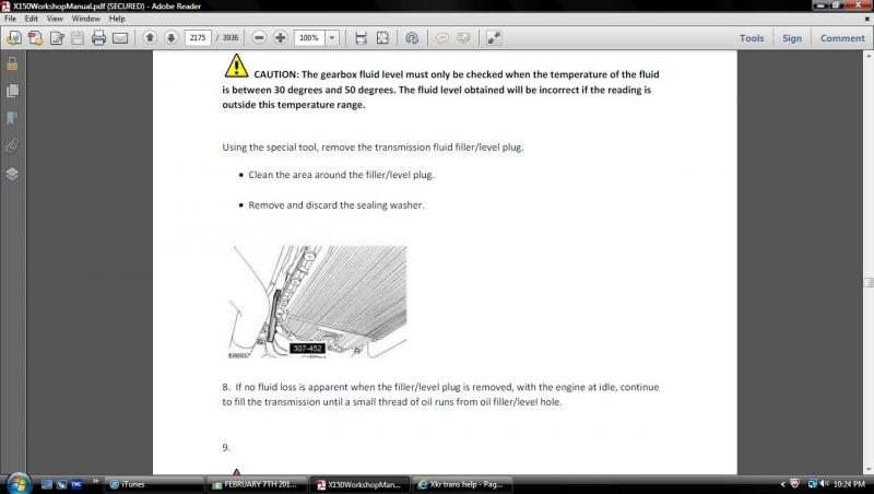

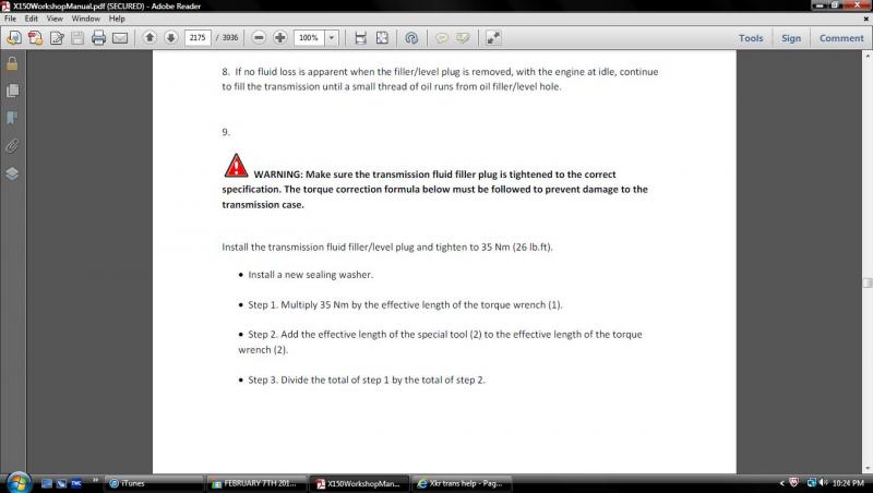

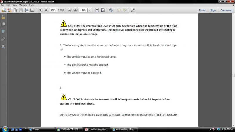

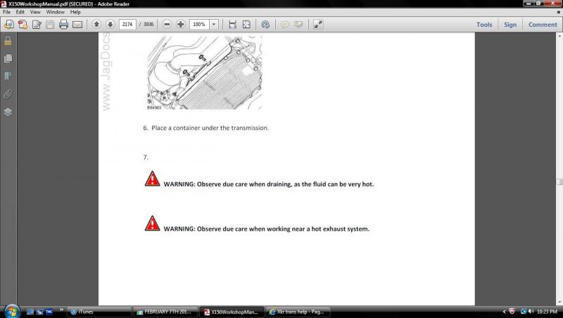

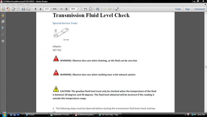

There was a HOW TO post on this forum I read once upon a time that was pretty descriptive. The manual that is downloadable on the web also tells one how to check the fluid level. Memory tells me it's a pain to do. But then again you need to do that. If I find that post I'll paste it on this thread.
Ooops. Those jpg are hard to read. If I were you I'd spend the ????? $ and download the manual from the EBAY site. I might post the jpgs larger later if needed but it means I'll have to do twice as many.

Only code I could find in my book was the p0730. "Low fluid" or "Worn Clutch". Any shop should be able to check levels for you.

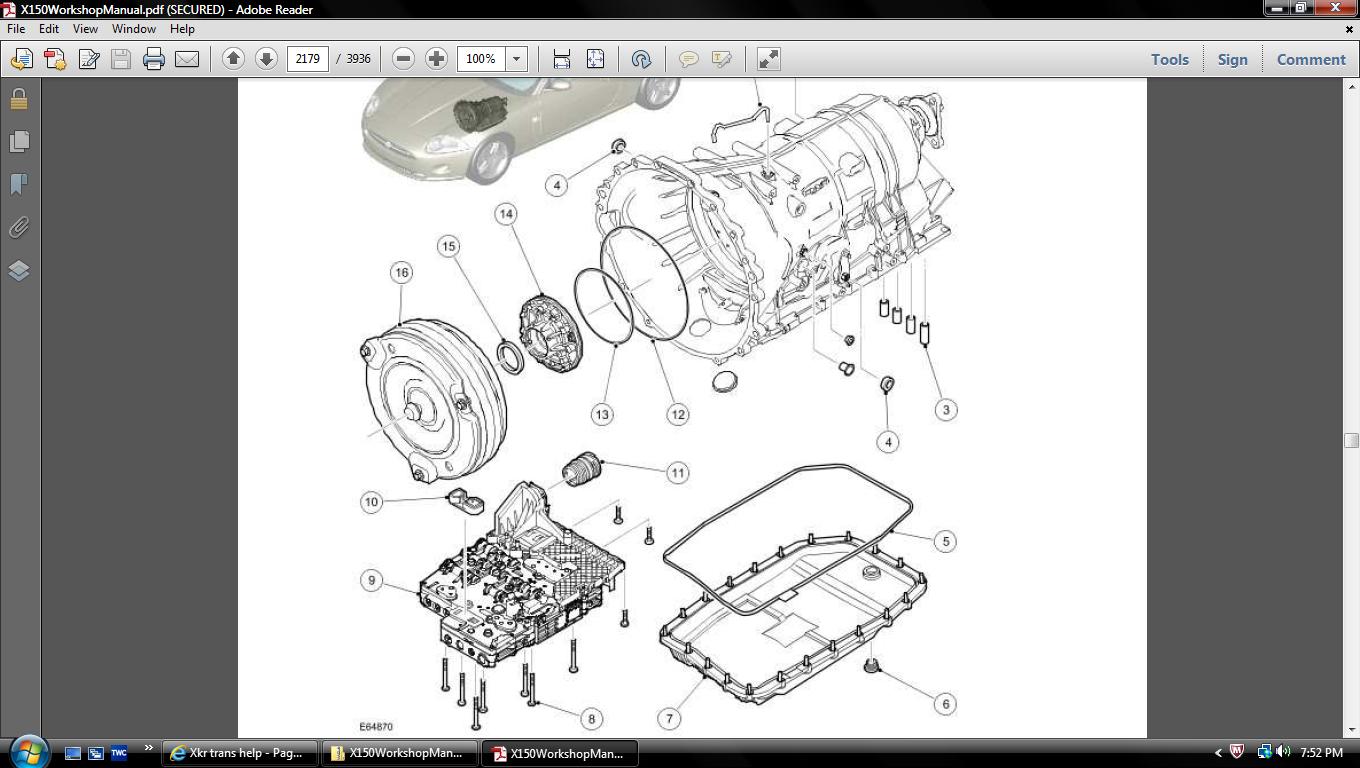

The speed sensors and solenoids are in the Mechatronic which is item in the attached jpg.
Item 11 in the jpg is the electrical connector. Looks like a Cannon plug to me from here.
Maye there's someone on this forum who's familiar as to which pins in the electrical connector would be ohm'd out to check the speed sensor??? A Jag mechanic out there??????? Or maybe it's not as simple as that. I would have thought it would be though.
The speed sensor can be bought online but as you can see the Mechatronic would have to be accessed to do so.
How 'bout a Jag mechanic giving a hand here????? Thank you.
EDIT: Whoops. Not possible. I just read the first page of the manual I attached in a post above and it says " the pass through case connector from the module to the vehicle harness will basically carry only power, ground and CAN Bus network" Meaning you cannot just ohm out the speed sensor through this connector. Oh well. Tough sleding.
