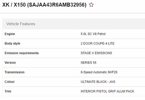

It could just be bad data but judging by Topix at least the first few hundred 5.0 litre cars had the 6HP26 so I wonder what the cutover was? B32956 is attached.
I am really surprised given that they specifically mentioned the 6HP28 in the original press release for the 5.0 litre. Perhaps they had supply issues?

I'm B34136 and have a -28 transmission according to TOPIx. I wonder at which VIN the changeover happened.

I don't think it's a simple as before and after a certain VIN. I've reason to suspect that body shells were built and stamped with VINs but didn't get built into finished cars strictly in sequence. As I posted on another thread, I know a local chap with an XKR with an earlier VIN than mine that SDD identifies as a MY2009 car, where as mine is identified as 2008. There are some 4.2 cars with VINs later than the supposed cut off, and 5.0 cars with earlier VINs.
As for 5.0 cars with the 6HP26, they maybe just ran out of 4.2 engines before they ran out of 6HP26 transmissions.
